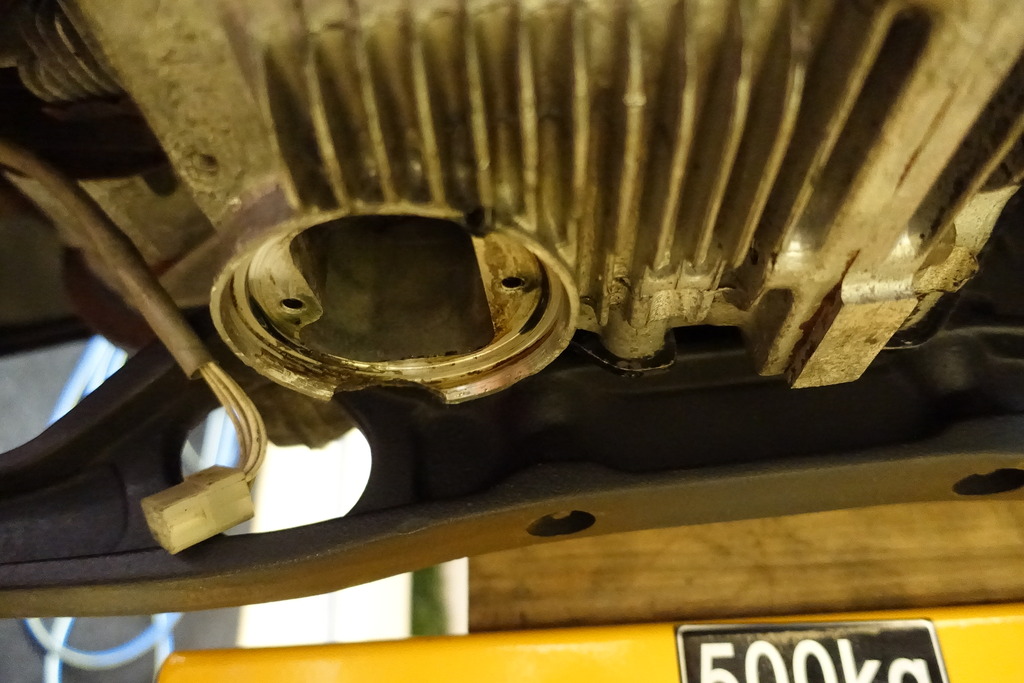

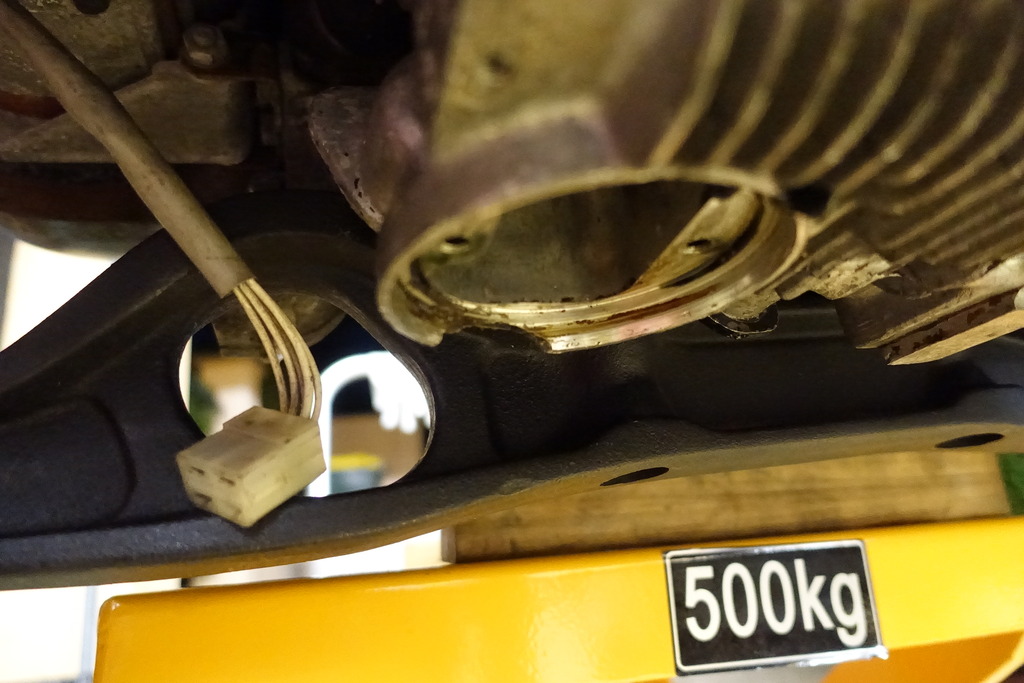

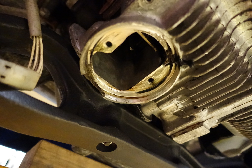

update...
i drained the oil, and removed the sealant....
The flange has been broken off, but the base where the o ring seats is fully in tact.
I'm thinking about 2 options.. clean it up and build up with JB Weld..
Or... get an aluminium billet plate which will seat with the flange much better and use sealant.
Thoughts??
IPB Image
IPB Image
IPB Image
IPB Image
SLITS
Instead of bolts, I put studs in to avoid the possibility of breaking the case or stripping the threads. Allows for better clamping capability.
Also, lay the sensor plate on a flat plate to make sure it is not warped.

WOW they did you no favors there!!
914Sixer
I found that that had an even bigger piece missing out of my case. I just got another case and I a going to do a quick rebuild.
