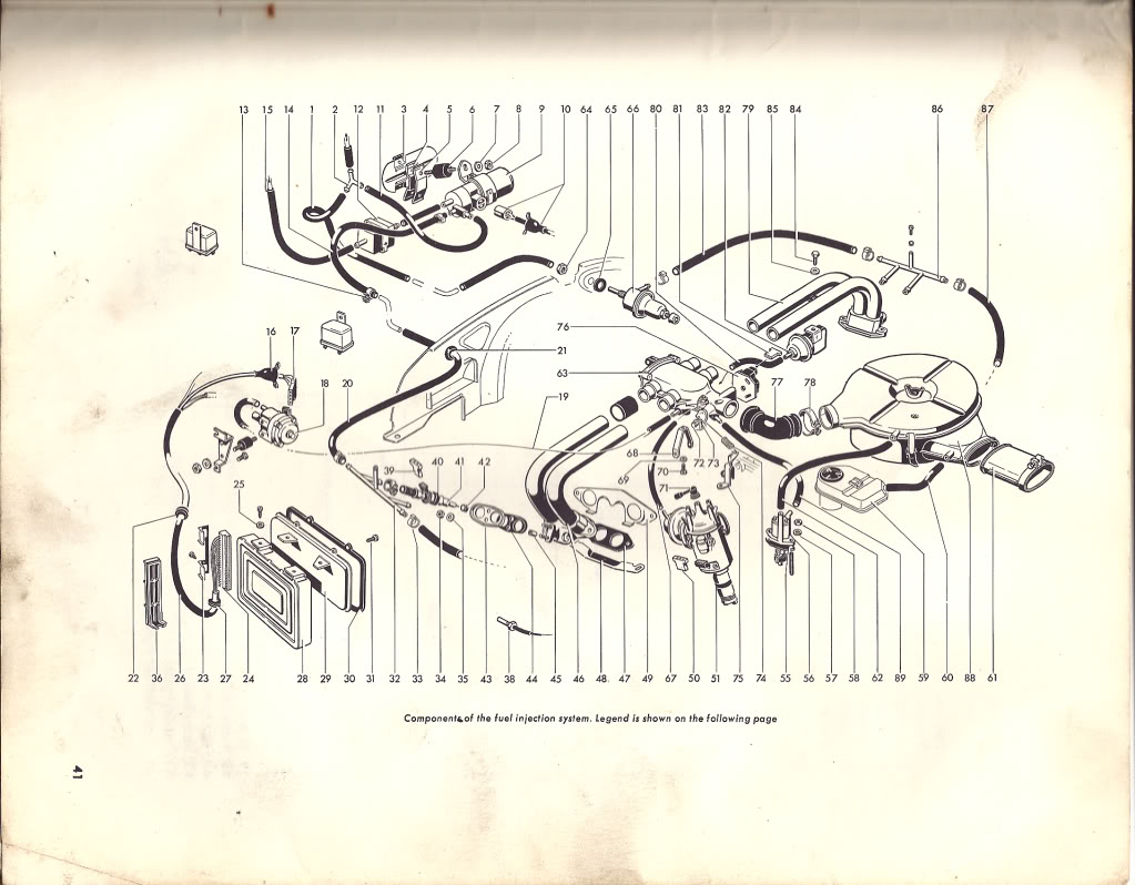

larss
QUOTE(DavidSweden @ Jun 13 2015, 06:18 PM) *
...Whats the best way to check the fuel pressure...
On the steel fuel line between the injectors on one side there is a T-tube with a small bolt at the end, just undo the bolt an hook up a pressure gauge on it and make the pump running.
/Lars S
See no 86 in this picture, the small nipple in the middle of that tube, thats where you connect the pressure meter. It might be on either side of the engine.
/Lars S
