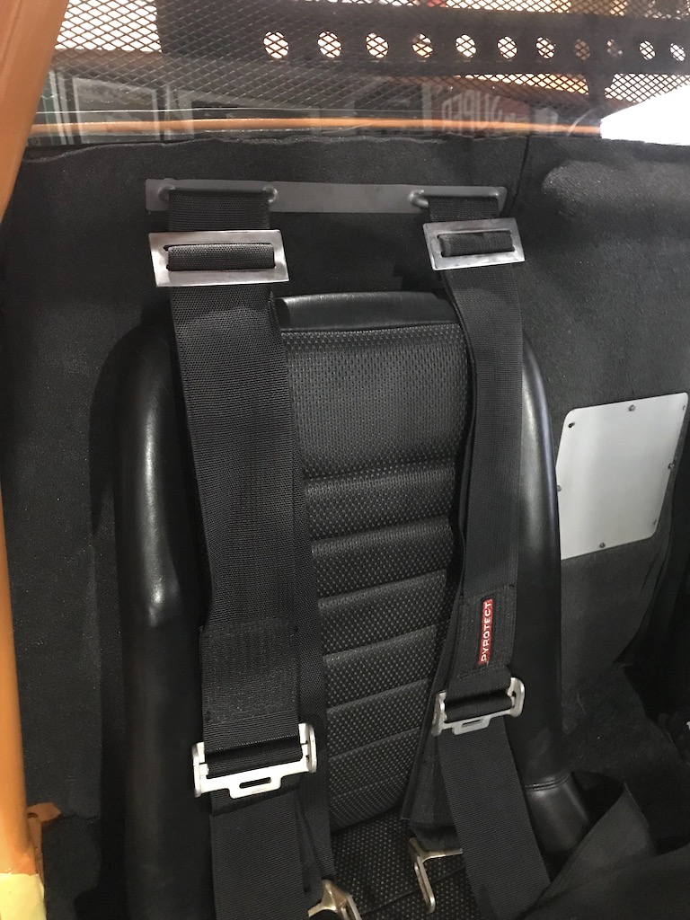

I like having the fire wall access panel. A must for replacing or tightening the fan belt. Again this is not a original six. MarkClick to view attachment

QUOTE(mlindner @ Oct 27 2022, 12:02 PM) *
Hi Mark,
I think I might have already messaged you about this but if not please consider headrests for safety. Very cool car you have!

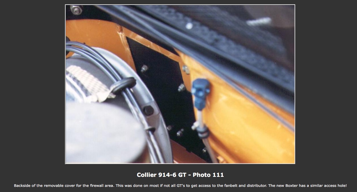

wonkipop
factory didn't mind doing it on their own GTs!
makes it sort of semi legit? or at least common sense.
