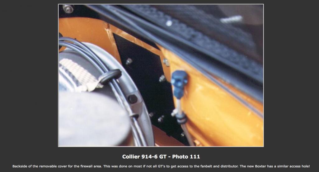

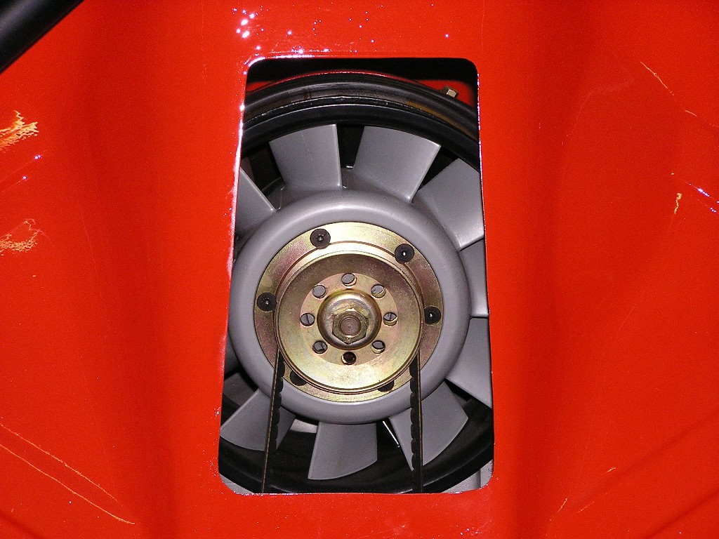

I like having the fire wall access panel. A must for replacing or tightening the fan belt. Again this is not a original six. MarkAttached Image

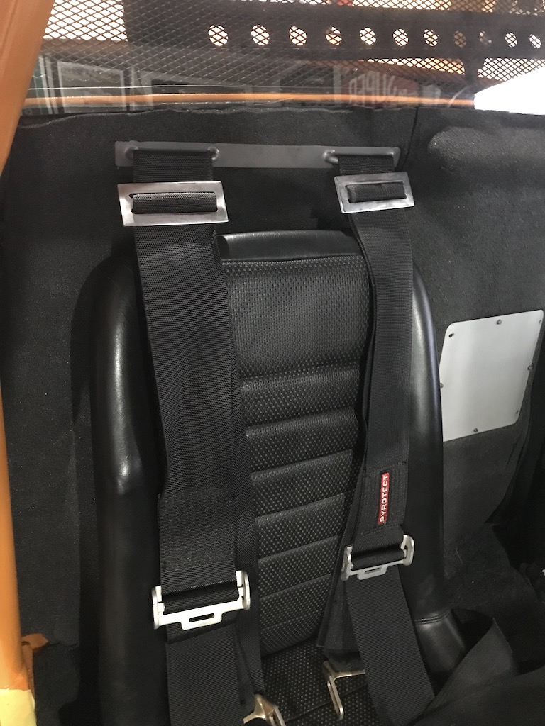

Hi Mark,
I think I might have already messaged you about this but if not please consider headrests for safety. Very cool car you have!

When I had my 2.7, i installed a pertronix ignitor to replace the points. It never failed on me. My flywheel had the timing marks on it, so it was simple to rev the motor to 6k and turn the distributor to adjust. You do not need to cut the firewall to replace a fan belt or get to the distributor. I only recently cut mine, so I could replace the alternator without the dropping the engine. My current motor is a 3.2,

Nice ,cut mine the same way but still tight and some danger when moving the dizzy,if you go to pointless ignition you have removed 2 adjustments and if you have a worn drive shaft bearings another problem solved .
First job after getting my car running was to cut the "hole" for tuning ,no regrets but sad to do it on a real "6" .

factory didn't mind doing it on their own GTs!
makes it sort of semi legit? or at least common sense.
