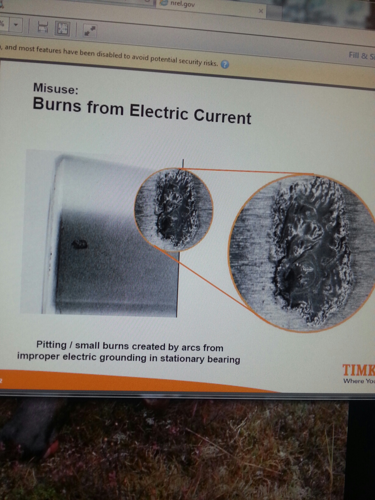

That's not a problem with 914s as most of them are sitting engineless on a rotisserie with rust repair biggrin.gif
altitude411
Yeah, pfffft... that's information for the guy's w/a running car. Small percentage. Stationary bearing av-943.gif thanks for posting it.
jd74914
I'm trying to imagine a situation where this would be an issue on a car unless you're welding on the snout of a crank and grounding on the engine block or welding a hub and grounding on the chassis.
Just as good praactice I'm always very careful to ground as close as possible to the weld on assembled cars to avoid any possible unintentional ground paths.
76-914
QUOTE(altitude411 @ Feb 18 2016, 01:57 PM) *
An oilite bearing would quality as stationary.
