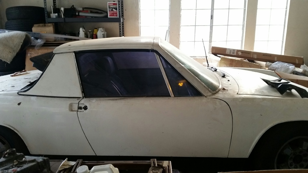

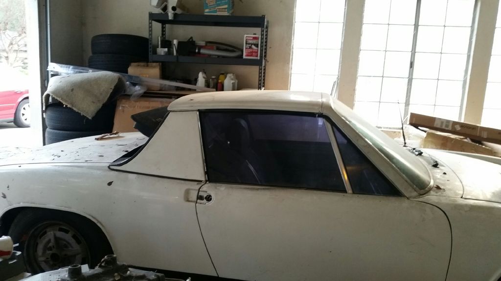

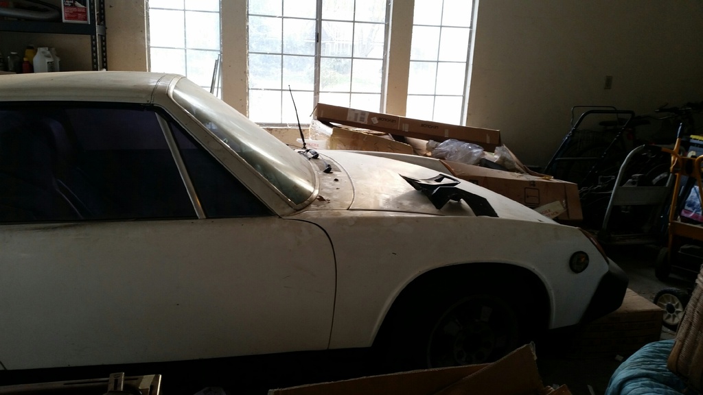

hyespeed
Jun 1 2016, 06:30 PM
this car has been sitting in a garage for about 20yrs
Jun 1 2016, 06:35 PM
QUOTE(hyespeed @ Jun 1 2016, 08:30 PM)
Pic of the car?

hyespeed
hyespeed
Jun 1 2016, 08:35 PM
There is an older body kit still in the box, I don't plan on using it and I'm not sure he was either. I have spare parts as well including doors, quarter panels, seats, etc.
hyespeed
Jun 1 2016, 08:36 PM
Few wheels as well.
hyespeed
Jun 1 2016, 08:49 PM
I also have a Audi 5000 transaxle, I do not know the application of this transmission are they used for 914?
