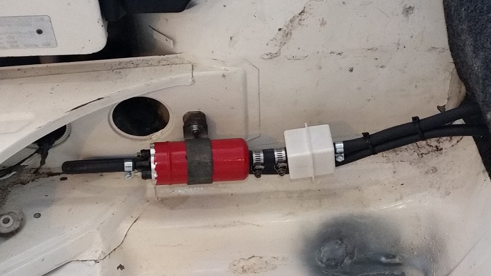

cary
I'm running this one from Rockauto.
http://www.rockauto.com/en/moreinfo.php?pk...204&jsn=339
http://www.electricfuelpumps.com/About.html
I think I have about 2k miles on it.
