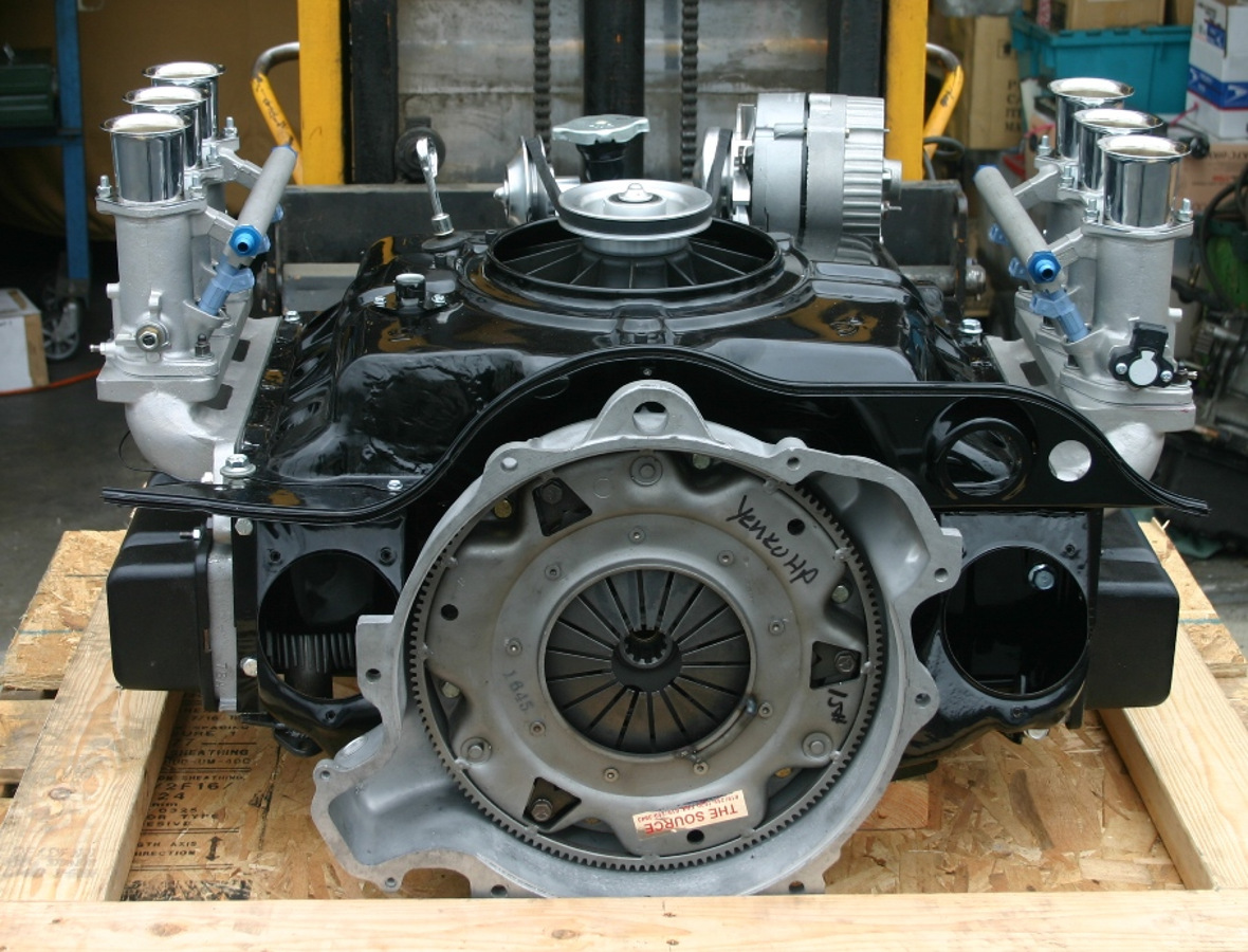

None of this is cheep,building a T4 good to 8500 on pushrods.
A fully scavenged dry sump will be necessary.
Things will break on the path to that kind of performance.
Reduction of friction and mass,both costly pursuits,testing,analyzing and redesign.
Sure,it can be done,as an entire replacement of the valvetrain.

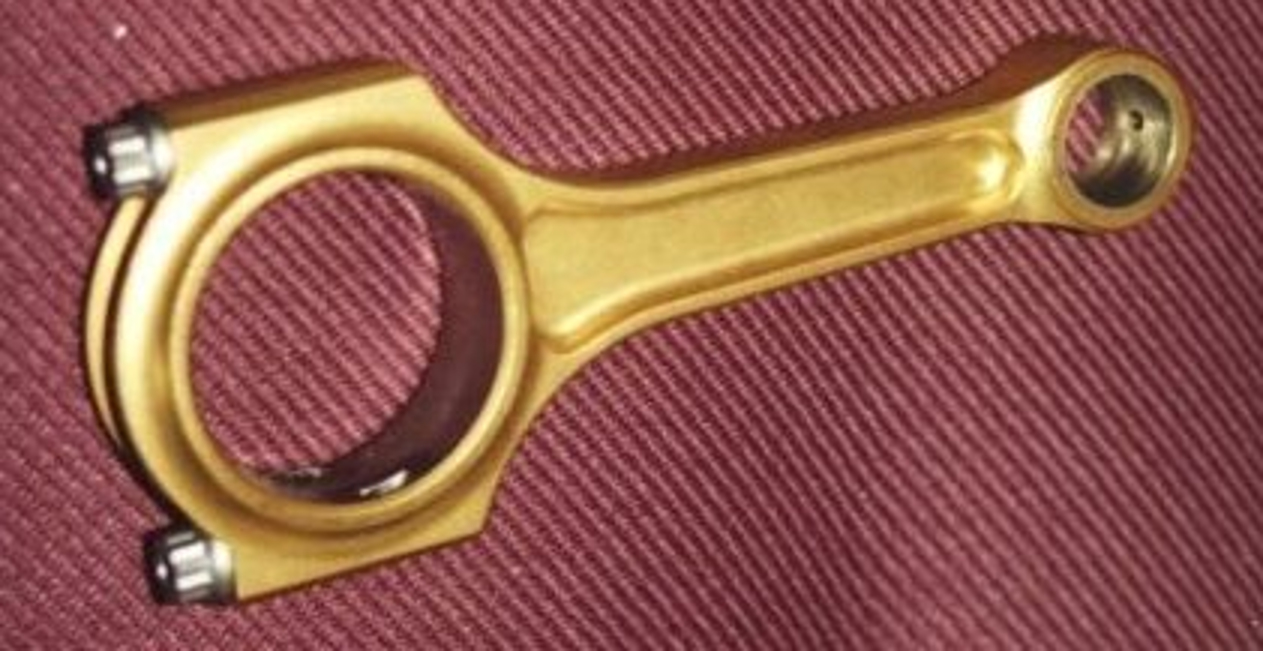

The rods titanium,like the canted intake valves,LN cylinders,billet heads,and on and on.
https://www.google.ca/search?q=titanium+int...rms0uSYQyoZM%3Ahttps://www.google.ca/webhp?sourceid=chrome...intake%20valveshttp://www.ebay.com/bhp/sbc-titanium-valveshttps://www.google.ca/webhp?sourceid=chrome...nium%20pushrodshttp://www.geneberg.com/cat.php?cPath=6_215_2794https://www.google.ca/webhp?sourceid=chrome...hroom%20liftersFor a 6500rpm engine of course,the costs are commensurately reduced,like,you won't need the
exotic rods,steel Carrillos will happily do it all day.
A T4 that will spin to 8.5K and more is the wish list carte blanche build,for sure a lot of fun.
A set of feeler gauges and a half hour every 5000km seems a simpler way to big revs.
The power desire curve would be more easily climbed with a larger engine,a Corvair!
The 1956 designed engine came with hydraulic lifters utilizing the factory stamped,heat-treated,ground and polished rocker arms.
Stuffing all those goodies into the six,a momentary satisfaction would result,whetting the taste for speed.
