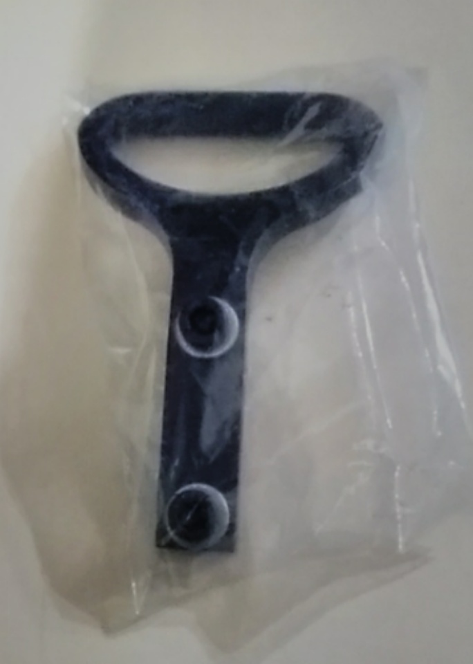

Question for those that have installed the 914Rubber handle: Do I need to drill the holes in the adjuster to a larger size or do the supplied screws fit in the factory holes?

Ya been awhile since I installed them but I want to say I did need to drill a slightly larger hole and then assemble with nut and bolt. I don’t remember if the nut and bolt were provided by 914Rubber or not.

Seems hardware is included. Just need to know hole size as car is leaving tomorrow for California and I'll need to install handle in the field.

I just installed one. You have to make the hole bigger for the bolts that are provided with the kit. I would suggest replacing both of them.
I did take the eats out to drill the old rivets out which made the job much easier.

Thanks guys. Anyone know what diameter the bolt that 914Rubber provides is?

It has 6mm Allen head bolts with lock washers, so a 1/4 inch drill will work.

Drill out the broken handle. (I think it was 7/32)

Then screw on the new one.
