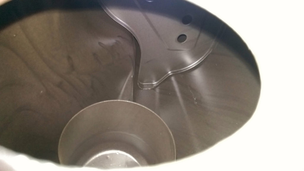

on a recent post a guy was getting the inside of the gas tank "Renue". I call up my nearest Renue guy and showed him my tank. He said he would have to cut up the tank in order to get to all the places in the tank. He said to get to all the baffles and under the pan he would have to cut holes in the tank. I read where a guy mention a product called caswell plating kit for gas tanks. I made a electrode and used vinegar and a battery to collect the rust. Can I use a slosh and swirl product like caswell to do a good job or does the venue guy have it right?

yes there is a baffle mid line in the tank to stop slosh weight trasfer from left to right in the tank....also a round baffle around the fuel line pick up / return holes
how bad is your tank?
try cleaning your tank first....
I have had good luck over the years using muratic acid to wash out the inside of many fuel tanks.....
it will eat the rust off and leave the inside very clean.
You just have to be very careful using it....very corrosive and will burn your skin....so safety precautions need to be in place...
take all the fittings off the tank and plug up the fuel line holes....pour in and slosh around....rinse out with lots of water....
I have tried sealers and they just don't seem to work very well...
really best to find another tank if yours is so bad with pin holes and lots of rust....

I had Gas Tank Renu do my tank.
Easily worth it. Nice to have something I'll never have to worry about. If they did cut holes in the tank, they welded them flush so that I can't tell. Outside looks like a brand new tank, inside too. Lifetime warranty too.
I started down the route of cleaning mine out myself, but it was a major pain, and then you get to try and dispose of chemicals.

I just cleaned two rusty motorcycle tanks worth about $800/each. I filled them to the top with apple cider vinager. Put the cap on and let them sit for 2 weeks. Then I rinsed them out with water and baking soda to neutralize the vinager. The inside of the tank looks like new metal. I rinsed it with marval mystery oil to keep it from rusting.
The vinager takes a bit longer than other chemicals but I can keep the tanks sitting in my garage and then pour the used vinager in the woods without any hazmat issues or complaints from the wife.

I get 1 gallon jugs at the market for $2..
So each moto tank cost me about $10.
A 914 tank would cost me $50 if I needed to fill to the top but it would mean no cutting of the tank. Lots of tanks are just rusty at the bottom.

Just fill it halfway, let it sit for a while and then flip it over. Or do it in thirds... I used the electrolysis method to remove most of the rust, been debating how to finish it off... Might try this vinegar thing...

I used phosphoric acid and in another tank I used an organic based stuff that went for about $25 per gallon. Diluted with water you can fill the tank. I made seals at all the ends and then left the tank in the sun. Looked like a dead seal on the lawn.
Then I put the tank on a rotisserie filled with chain bolts big nuts and WD-40 and turned it with a slow gear motor. Or a drill. Makes a hell of a noise. I count the pieces as I put them in and take them out.
The results have been spectacular, but I cannot find the photos. I distust any organic liner on the steel because it could start peeling off. Not that I know of such an instance, but I have never seen a truly permanent paint. This is surrounded by gasoline.

GasTank Renu did mine following the procedure you outlined. Once they make the cutout(s) they supposedly also media blast the inside before chemical treatment the claim being that it gives a better surface for the sealant to adhere to. They weld the cutouts back in place and also coat the outside of the tank with a material that feels like hardened undercoating. I had them leave the exterior top of the tank unfinished and just hit that with black paint.
I did not want to deal with all the nasty chemicals and wanted to minimize chance of the interior coating peeling. They seemed to do a vary thorough job. I only had it done last year so can not speak to long term durability.
I also agree that if you are just cleaning up the tank, probably best to leave it uncoated. However, if metal is thin or there are pinholes you may have no choice. Avoid ethanol fuel if you can, that is the root cause of many failed tanks.
