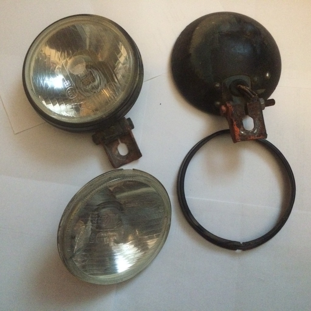

I picked up these driving lights for $35, they are Hella 4572R8 4571. One is a bit dinged but should clean up ok.
Dumb question but here goes: I believe these are original for 914 can anyone confirm this and is there anything i need to know before I start renovating them
Thanks

They might fit but they don't look like 914 ones.
Experts will chime in.

Actually, they don't look like US light but you might have scored something rare... confused24.gif
I found this:
http://www.914world.com/bbs2/index.php?sho...p;#entry1551321

am on the other side of this
Quick look makes me think they are indeed for a teener...but not US

They are Euro 914 driving lights. They are also known for having 5 rivets.

Correct. . Euro's but be careful - the lens and lens retainer bezel have a slightly larger opening and only for these lenses which are larger than the normal TN 1-2 or TN4. The reflectors are not interchangeable with the 4 rivet housing units. These use an H3 bulb with a connection on the 5th rivet for the positive lead.
