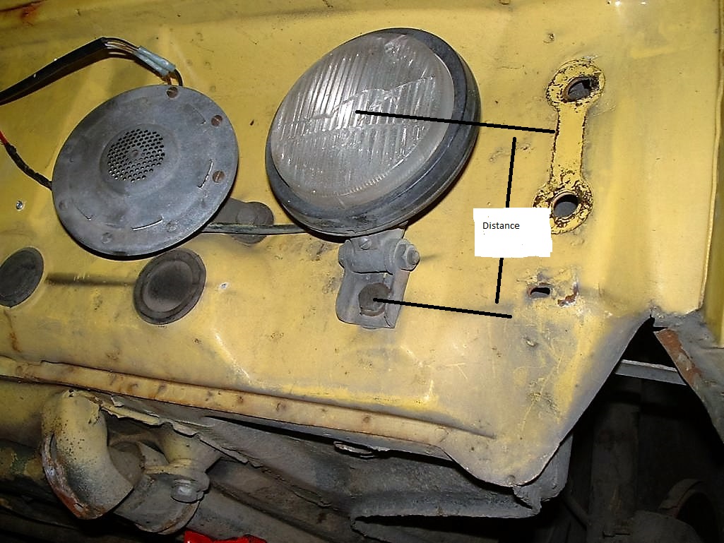

Can some one please measure the distance between the center of the fog light and the center of the mounting tab hole. Hopefully this photo that I found here on 914 world will help depict the dimension that I need.
raynekat
Aug 14 2016, 04:19 PM
On my 1971, it's right at 3.5"....possibly a hair less.
Should get you in the ball park.

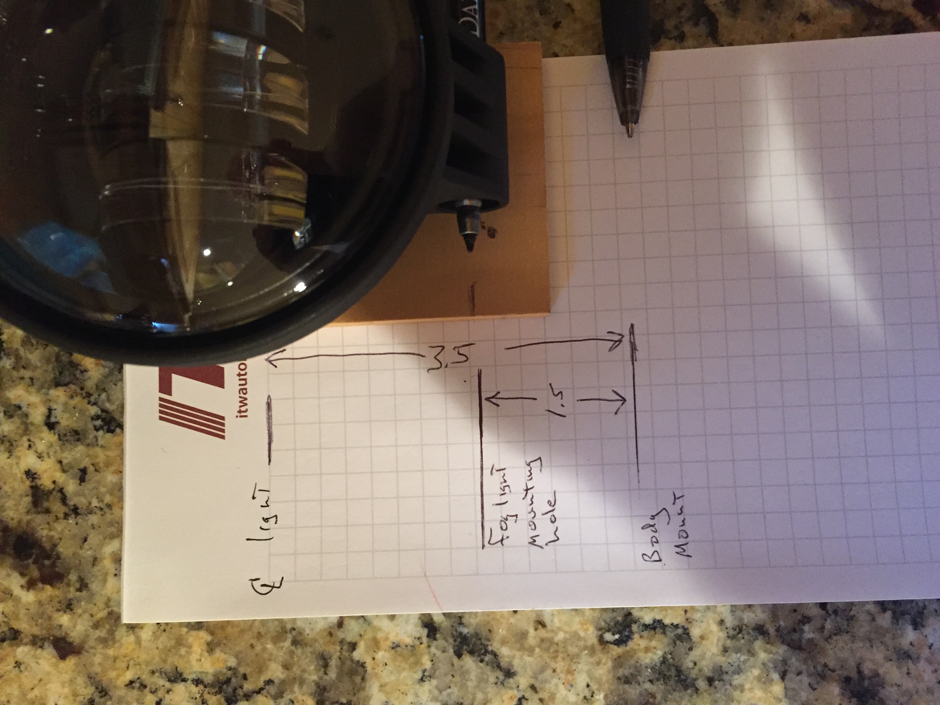

Based on that dimension this is what I came up with. I think that I will make the body mount half of my bracket a slot.

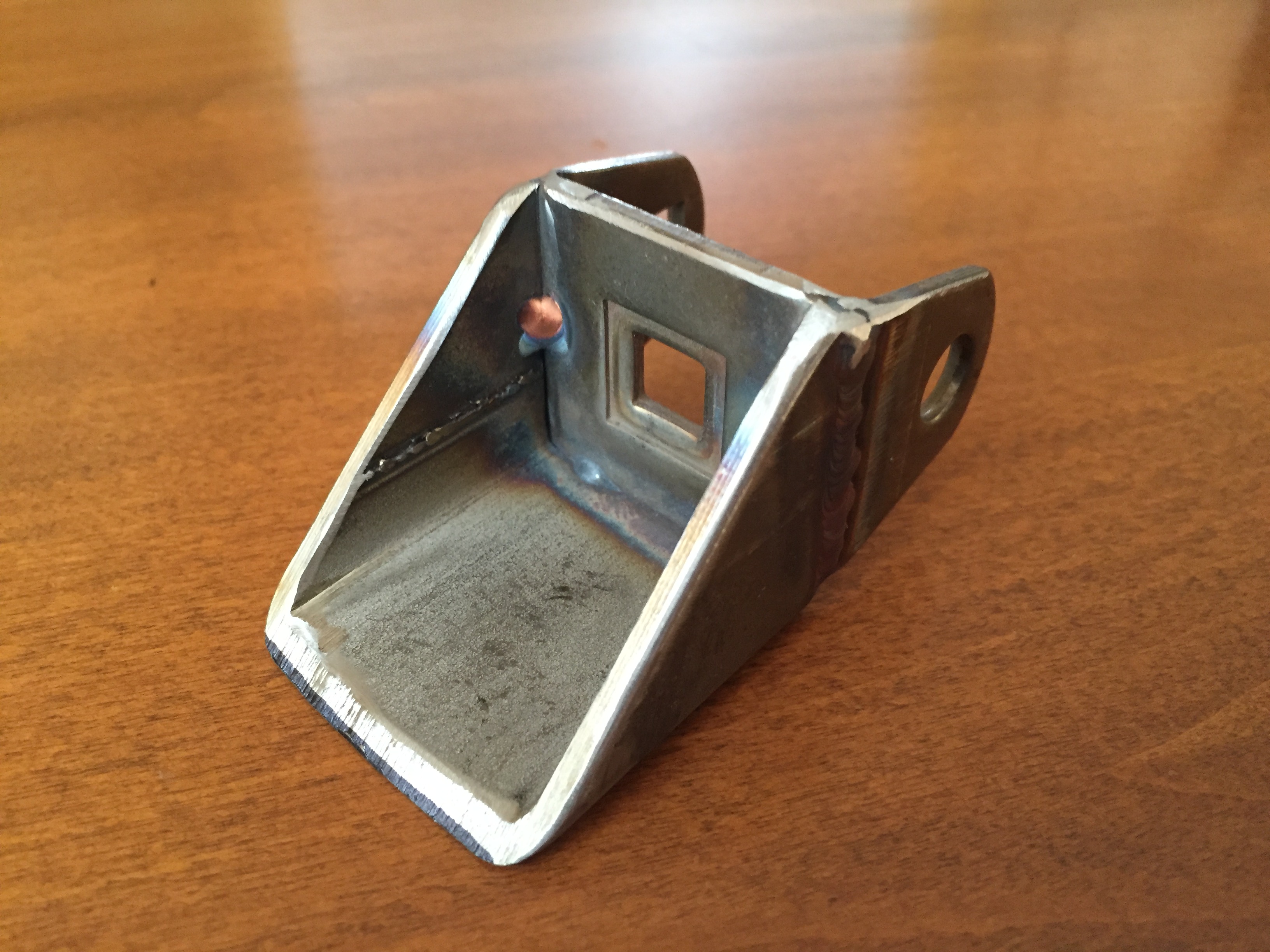

Here is the bracket I made with the dimensions provided by reyneckat.
Click to view attachment Click to view attachment
Cairo94507
Aug 20 2016, 12:53 PM
Very nicely done.

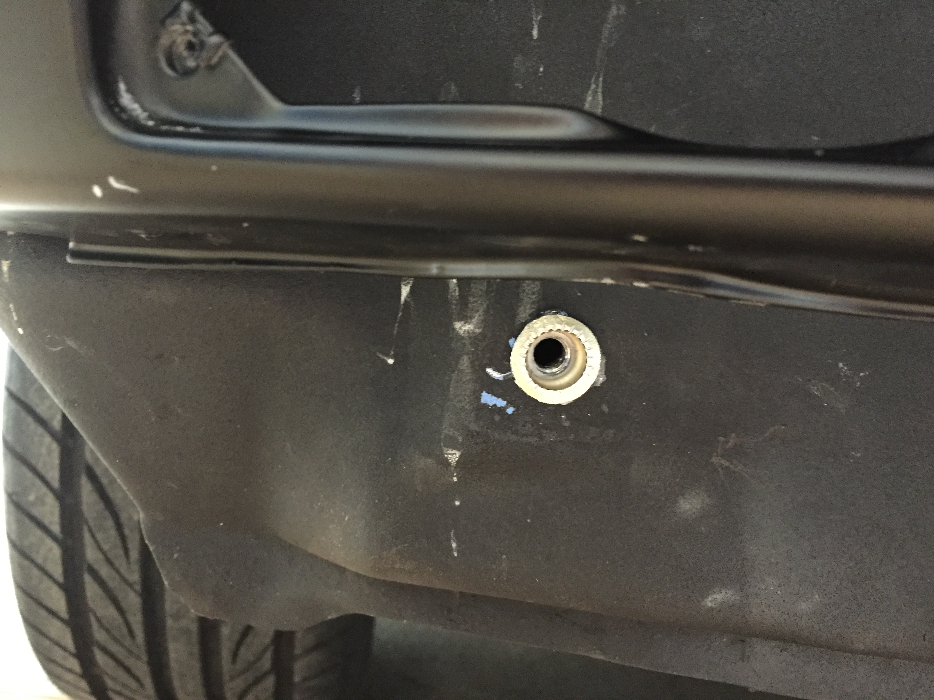

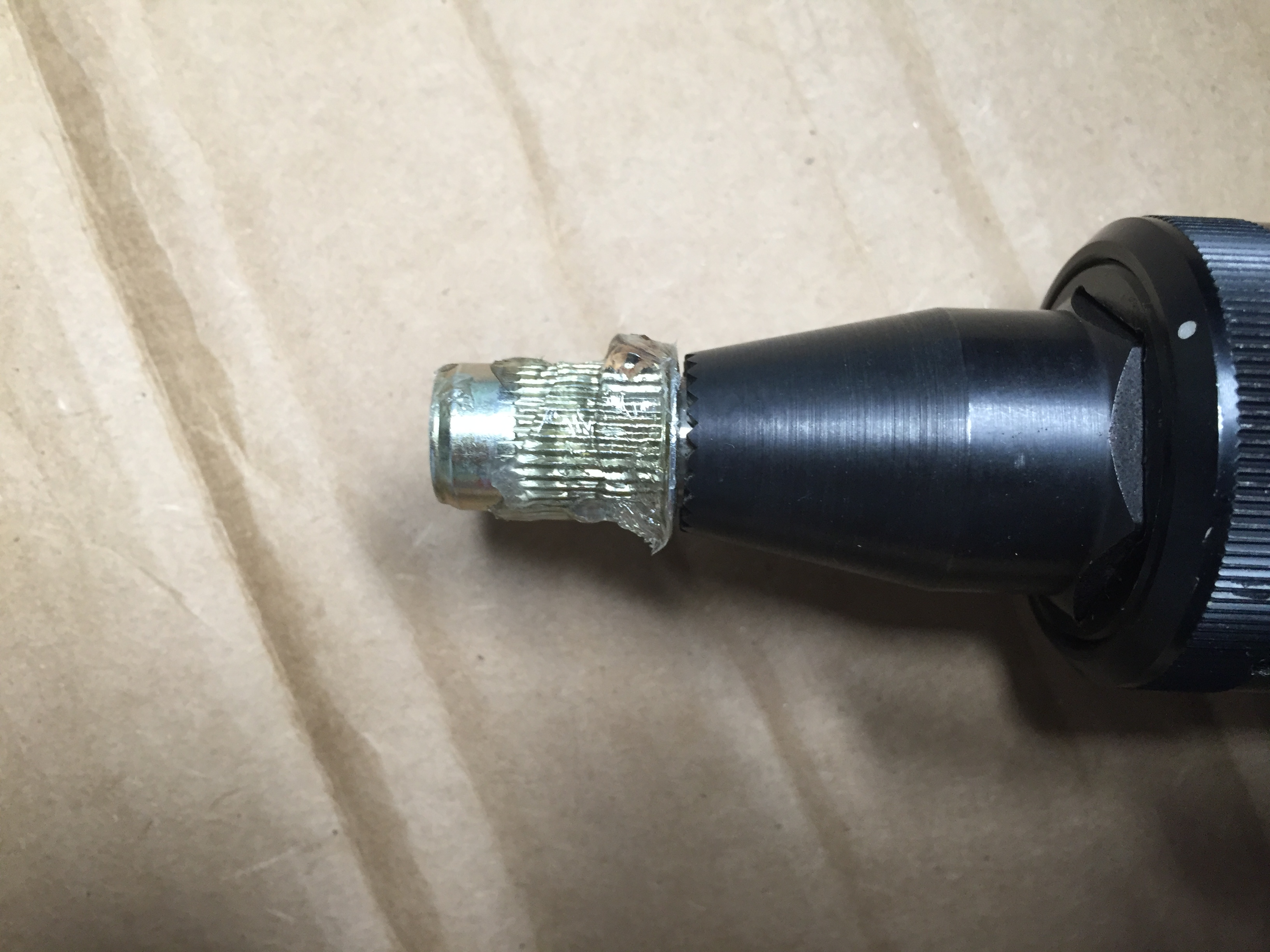

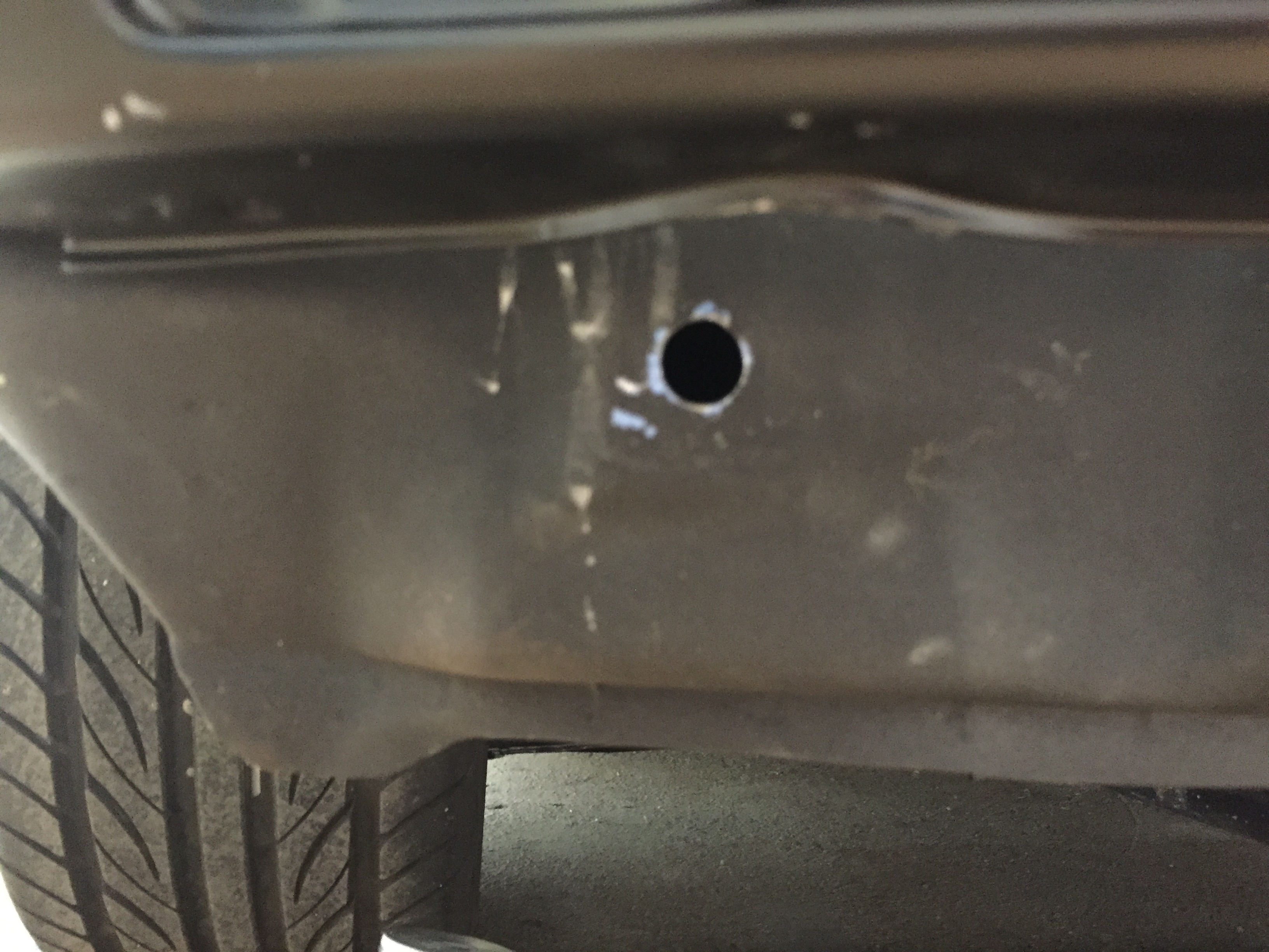

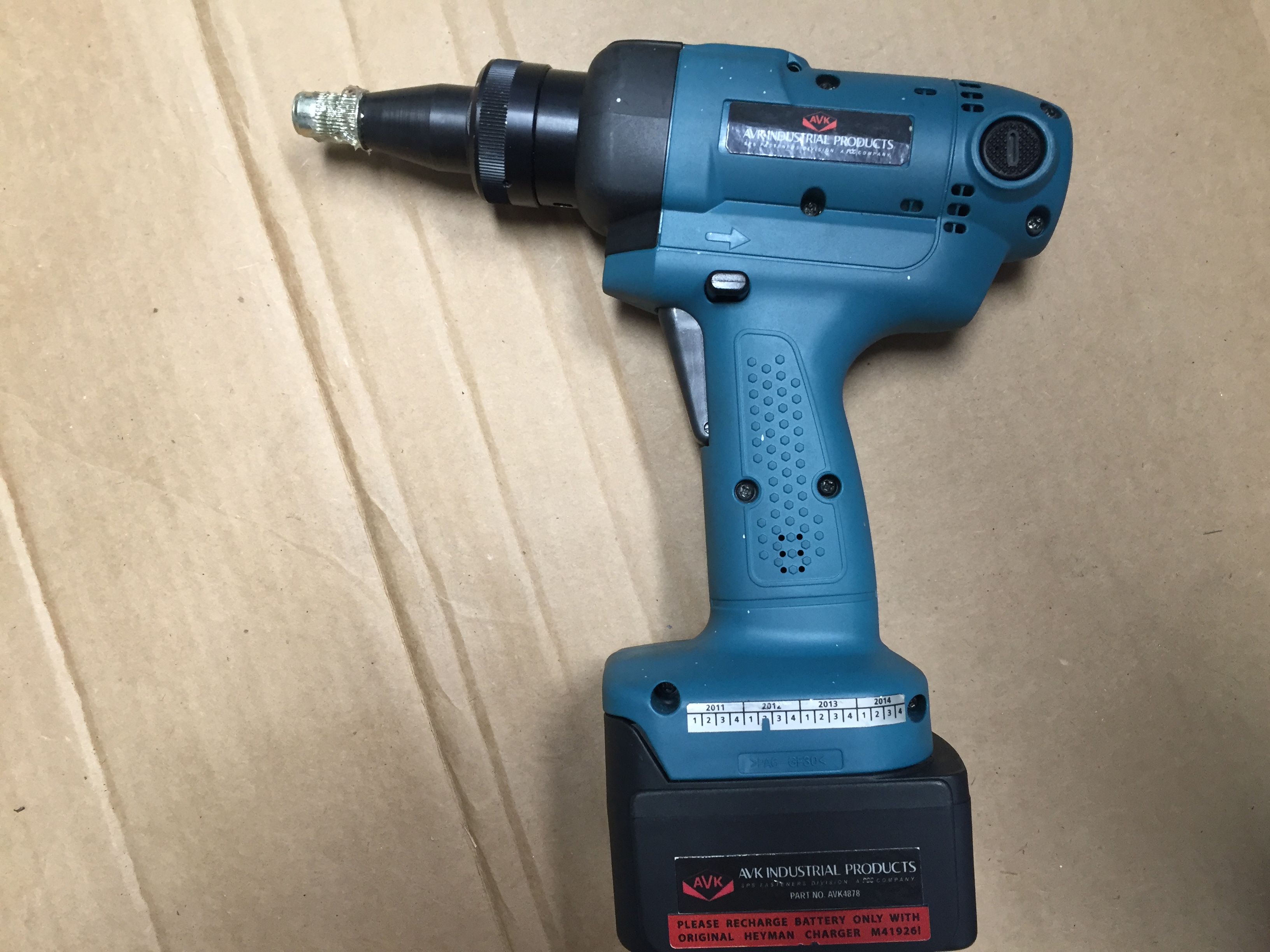

I borrowed a rivnut tool from work to install the Ric nuts for my fog lamps

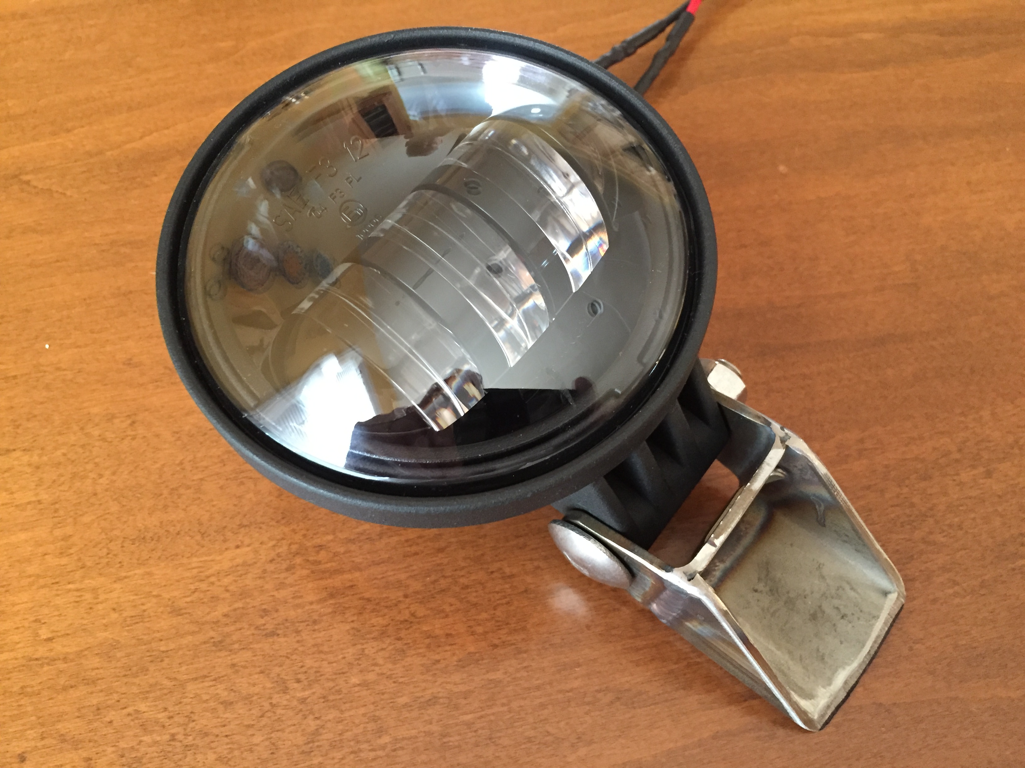

Harpo
Sep 3 2016, 12:04 PM

QUOTE(Harpo @ Aug 20 2016, 12:18 PM)
Click to view attachment Click to view attachmentNice but.... holy overkill batman!
