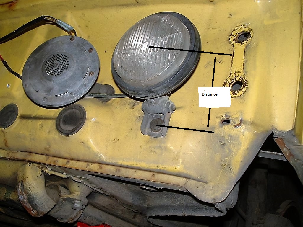

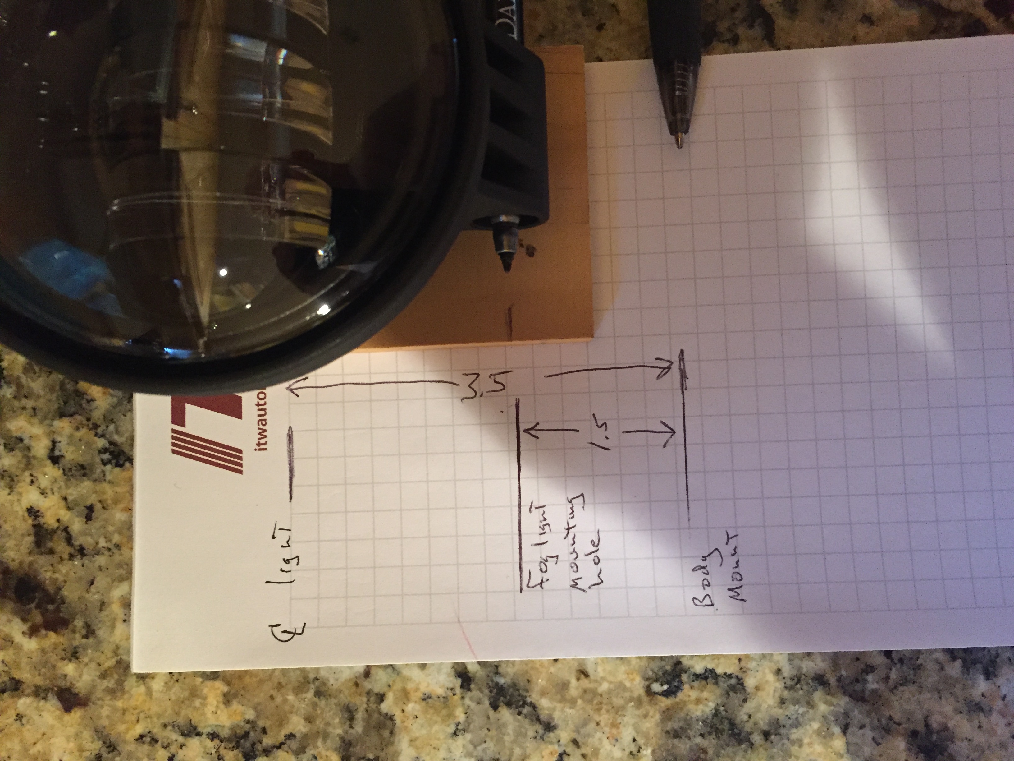

Can some one please measure the distance between the center of the fog light and the center of the mounting tab hole. Hopefully this photo that I found here on 914 world will help depict the dimension that I need.
raynekat
post Aug 14 2016, 04:19 PM
Posts: 2,171
Joined: 30-December 14
From: Coeur d'Alene, Idaho
Member No.: 18,263
On my 1971, it's right at 3.5"....possibly a hair less.
Should get you in the ball park.
Harpo
post Aug 14 2016, 06:10 PM
Posts: 1,304
Joined: 21-August 11
From: Motor City aka Detroit
Member No.: 13,469

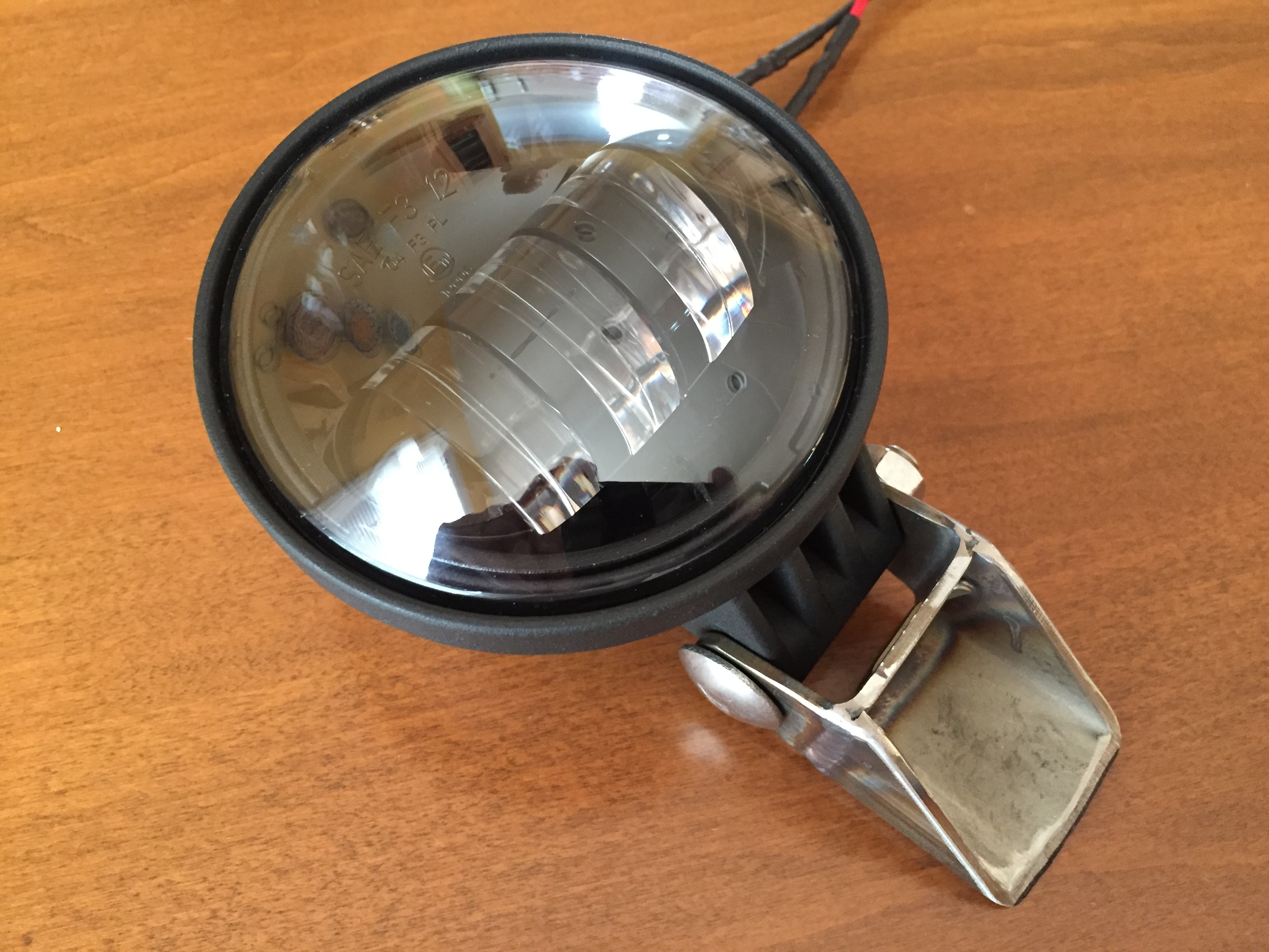

Based on that dimension this is what I came up with. I think that I will make the body mount half of my bracket a slot.

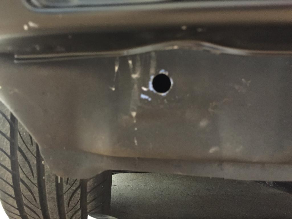

For those of you that have already back dated your bumpers & fog lights how did you attach the fog light to the body? Unless someone has a better idea I will most likely use a rivet nut.
http://avkfasteners.com/products.RN.php

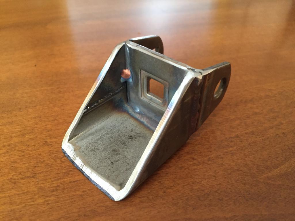

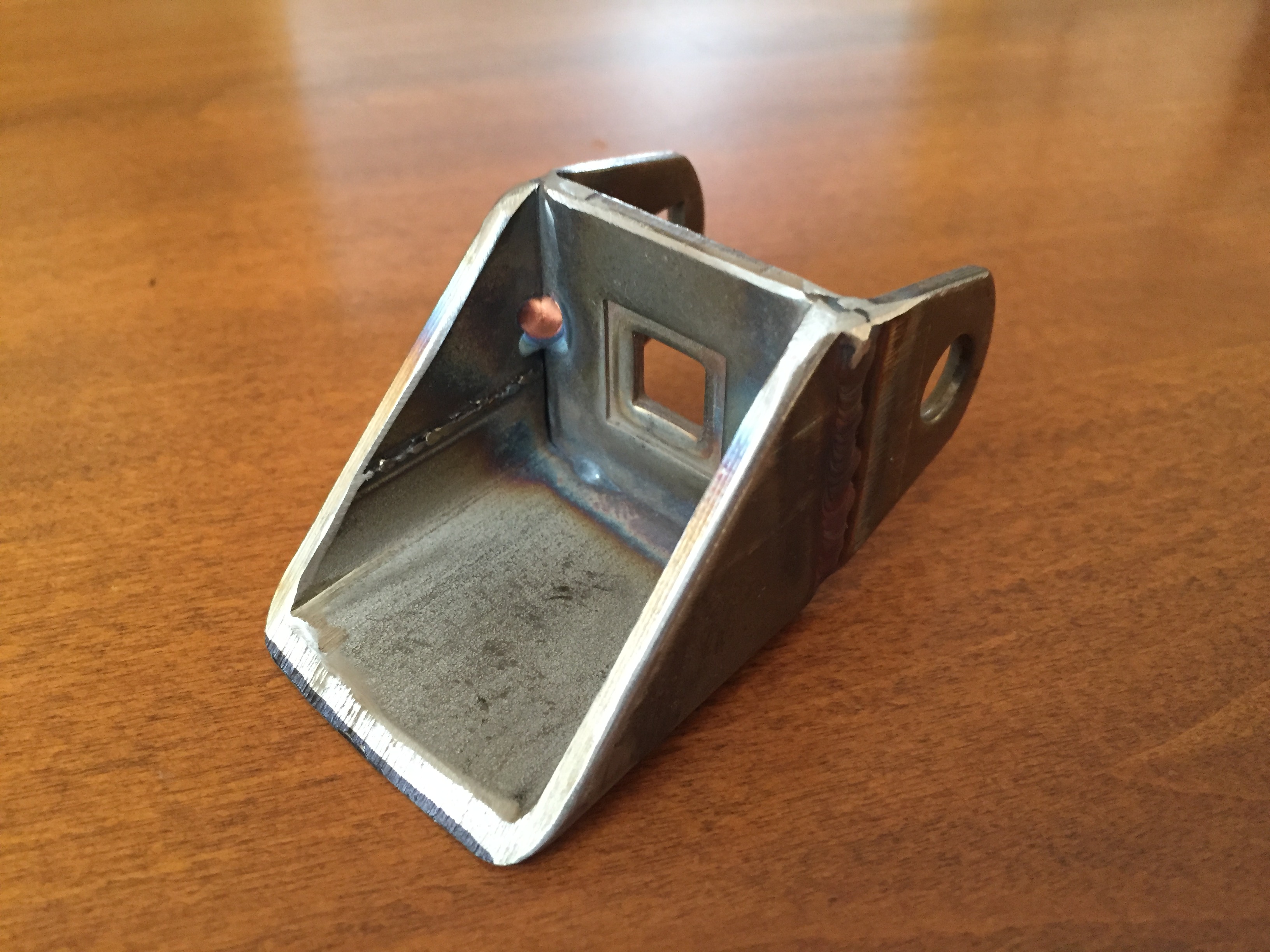

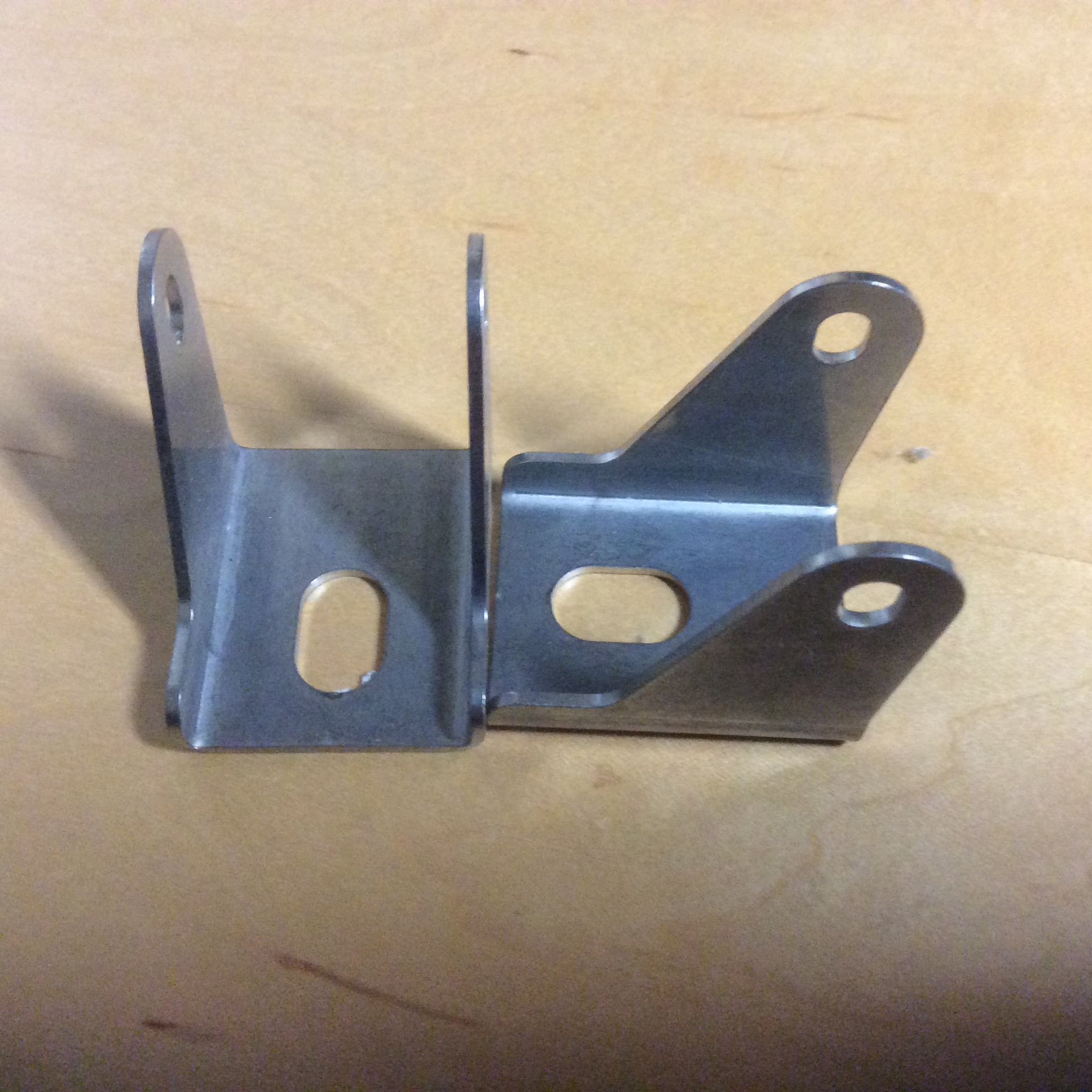

Here is the bracket I made with the dimensions provided by reyneckat.Attached Image Attached Image
Cairo94507
post Aug 20 2016, 12:53 PM
Michael
Posts: 10,771
Joined: 1-November 08
From: Auburn, CA
Member No.: 9,712
Very nicely done.

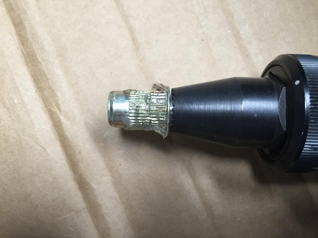

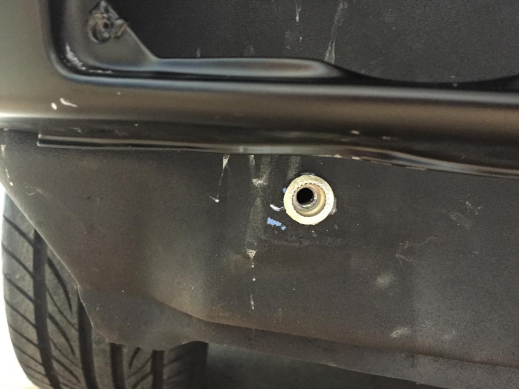

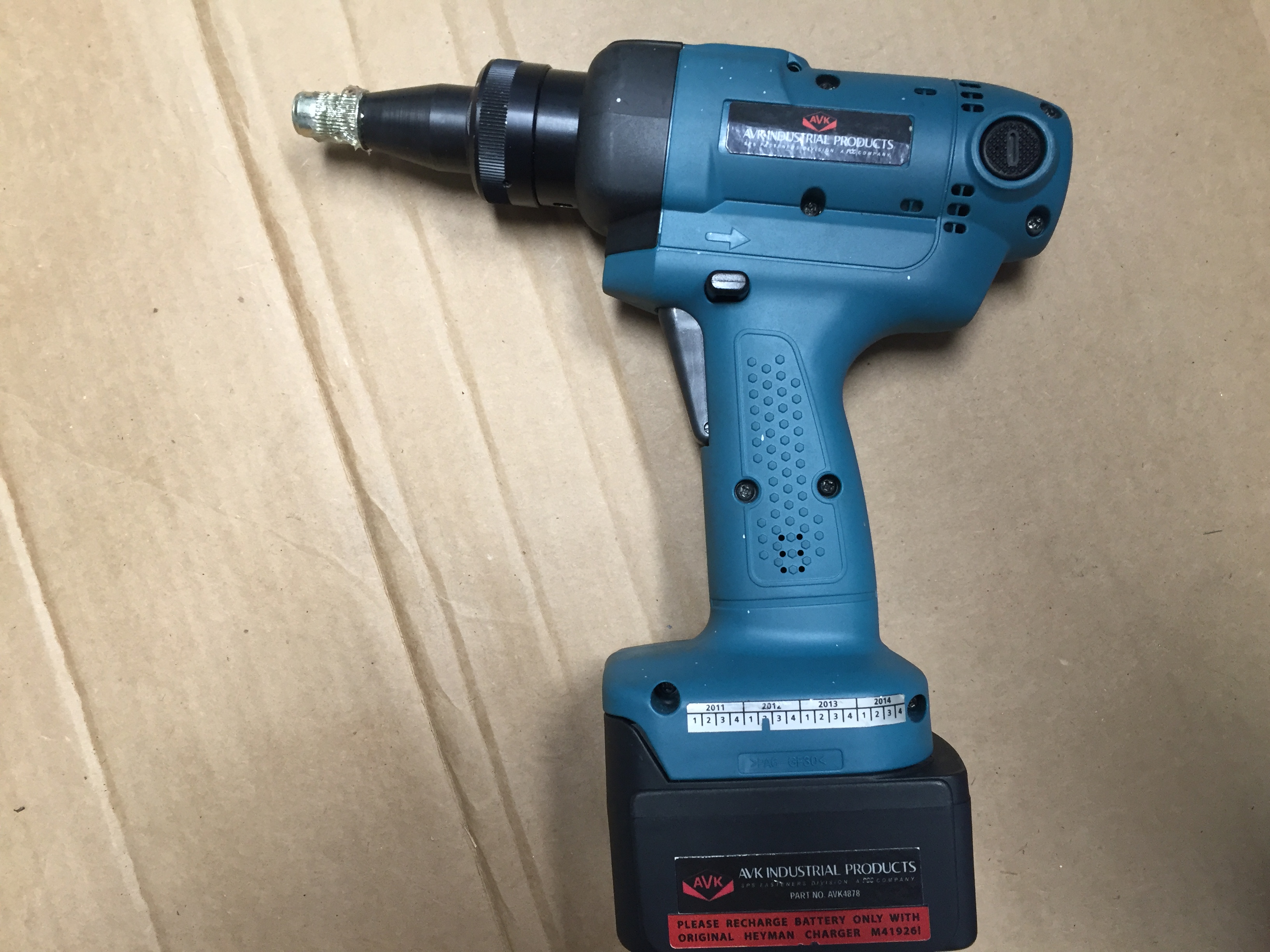

I borrowed a rivnut tool from work to install the Ric nuts for my fog lampsAttached Image
Harpo

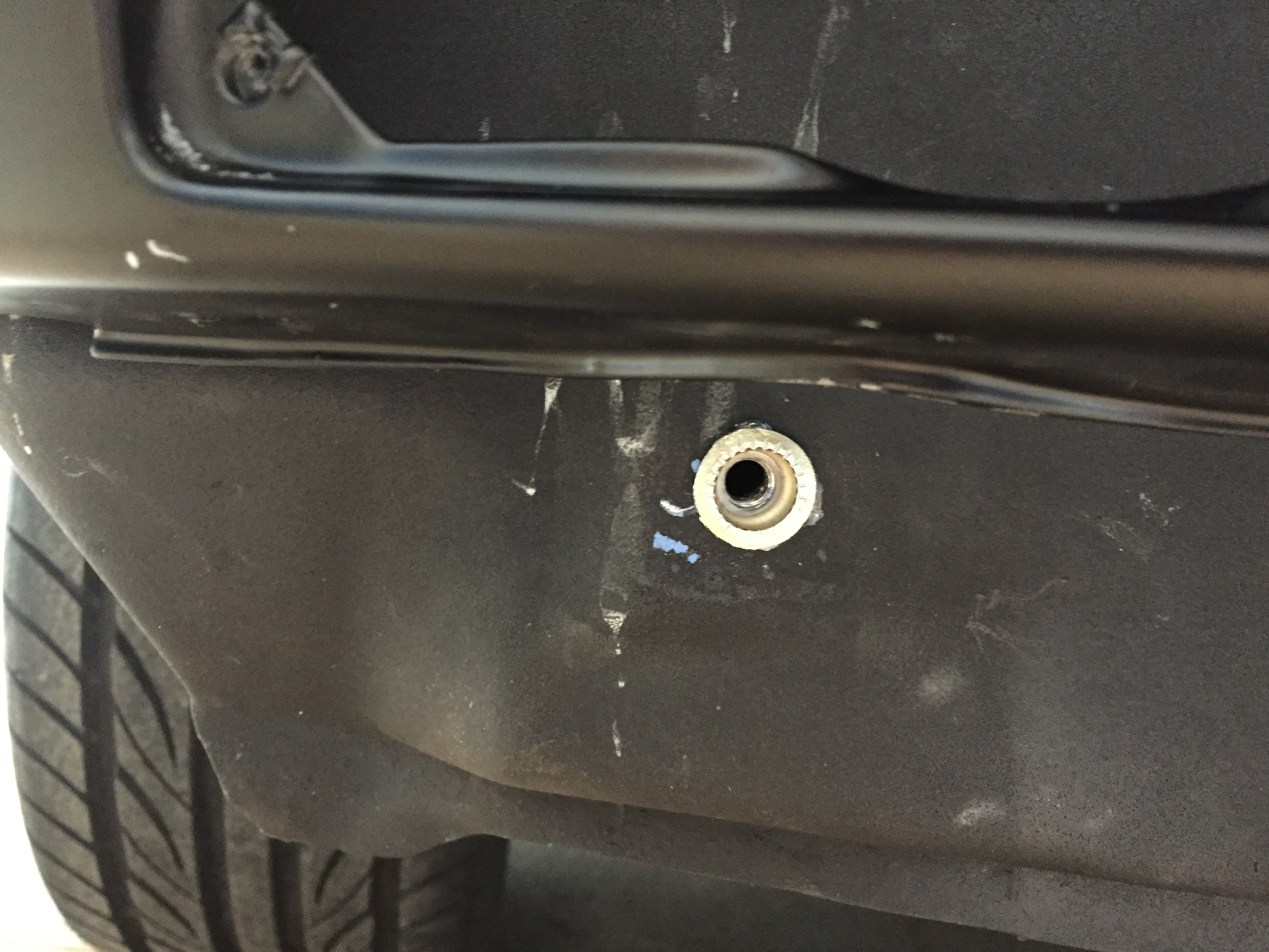

post Sep 3 2016, 12:04 PM

Mark Henry
post Nov 25 2016, 05:45 PM
that's what I do!
Posts: 20,065
Joined: 27-December 02
From: Port Hope, Ontario
Member No.: 26
QUOTE(Harpo @ Aug 20 2016, 12:18 PM) *
Nice but.... holy overkill batman! (IMG:style_emoticons/default/biggrin.gif)
