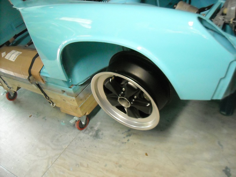

I have had these wheels for a while now but had not tried fitting them to the car before. they were buried in the front of the storage locker I rent to keep the rest of the cars parts. So today I moved everything and brought them home to try fitting them.
I already had a good idea of the tire sizes I wanted to run. my original thought was to go with 245 / 50 /16 on the 8" Fuchs on the rear and 225/ 50 16 on the 7"s for the front.
Good thing I didn't buy the tires...........

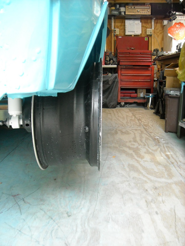

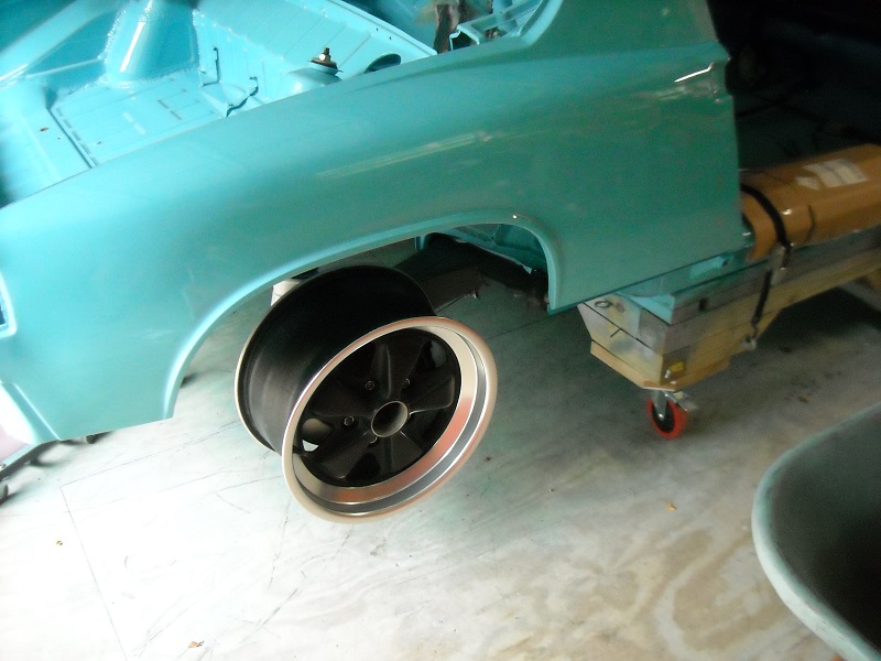

Even though the fenders were flared with the intention of using these size wheels it seem that the space under the fenders is not as cavernous as I thought.
After trying the 8s on the rear I am not even sure 225s will fit.

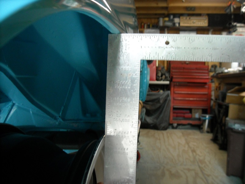

With a straight edge on the outer lip of the wheels I have 3/16s on the pass side and only 1/16 on the driver side, that in addition to the 5/16s thickness of the outer lip on the wheel equals 8 3/4 total possible tire width.
The specs on the 225 /50 tires are based on a 7" wheel and show a 8.1 in tread and a 9.2 sectional width. so the tread will fit under the fender but I don't know if the sidewall will rub.
The GFs car has 225 45s on 7.5in rims and the sidewall is almost straight up from the wheel.
Really want to use the 8" wheels but I would hate to ruin the new paint job.

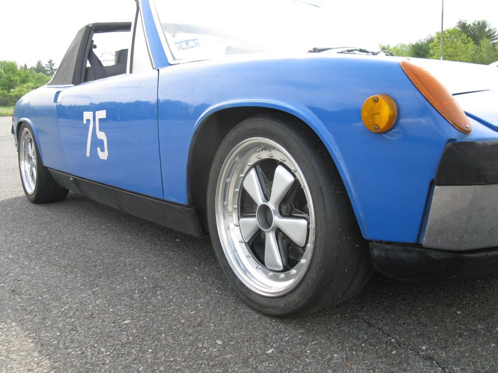

I have 7.5"x16 3-piece rims that go on my pulled narrow body with Hoosier
205's which are probably as wide as your 225s.
However, the wheels are built as ~38mm offset where the 8x15 you have are 11mm
offset. Also, on my car I need an exact amount of spacers that is different each
side. No joke, after the first run of first autocross with these tires, I needed to
take off the left wheel and remove a 1/16" spacer to avoid burning paint. And it
now barely rubs on the frame.
So, unless you cut and sectioned your rear fenders to get at least 1" more room
than I got by pulling, I think you will not be able to make them fit. (Also I have a
lot of camber and stiff springs, which helps).

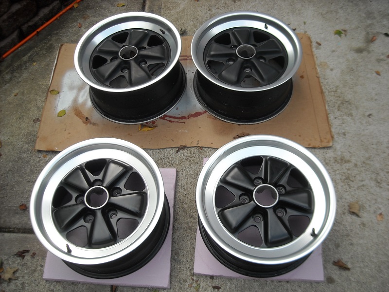

The Fuchs I have are 7x16 and 8x16 both with the 23.3 offset. That's why I thought they would fit.
I may have to run 205 /50 -16s front and back.
I thought of buying a used set of 225 50s just to check the fit.
I have another set of 7" Fuchs I could run on the rear but they don't match, and would need refinished.
