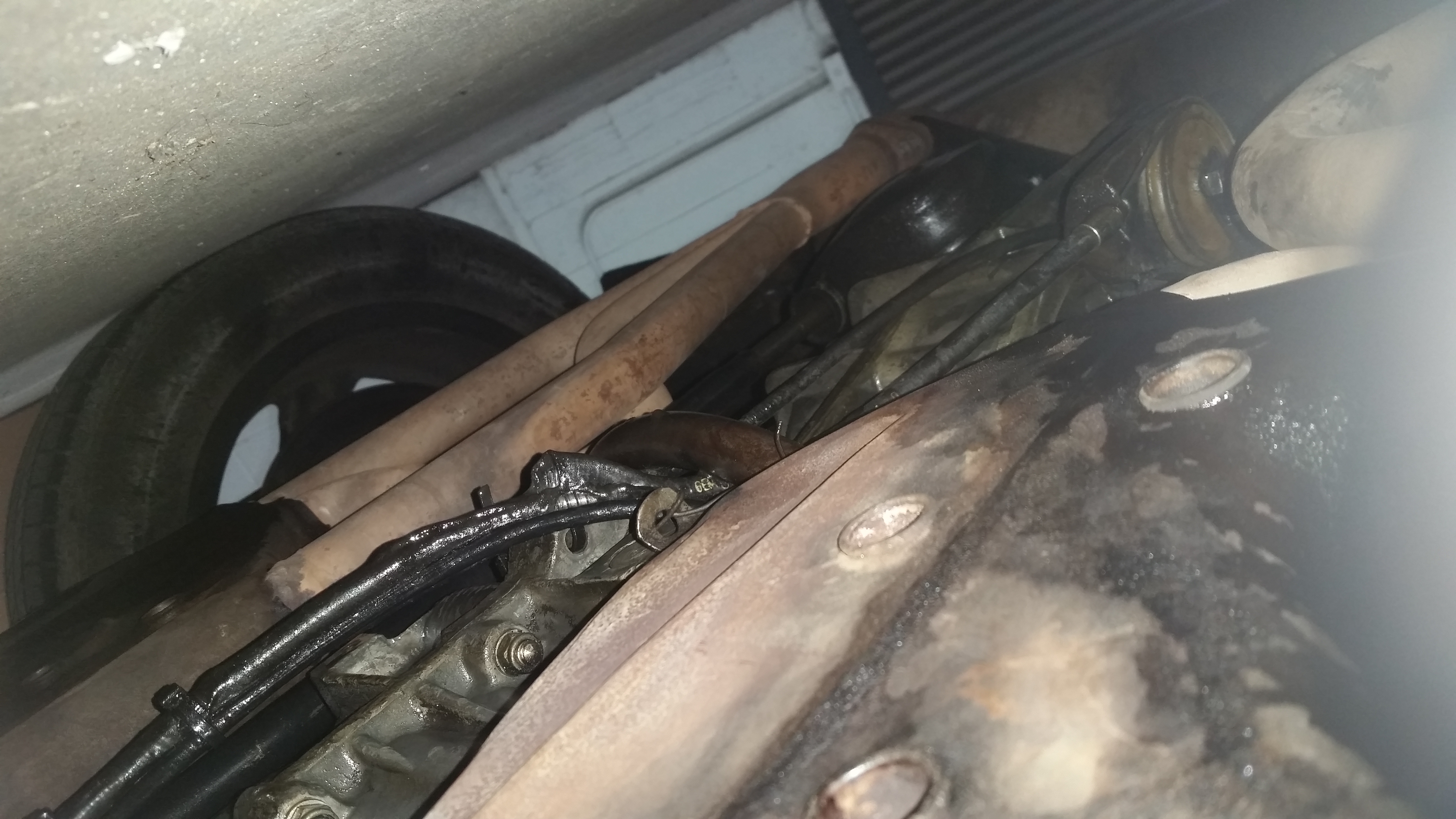

I went back at lunch and looked a bit more.. Its getting caught on something or maybe the cable is frayed and catching the plastic tubing around it.
The pedal feels very tight, like I have to use a whole lot more force than what should be necessary.

The cable slid easy enough when we had it disconnected, not that it couldn't be failing apart now. Could be binding at the throttle body or pivot.

how did the cable get anywhere near the exhaust? it comes out of the firewall and goes directly up through the shelf to be routed. if the cable is suspect, get a new one. you can tow it here but i doubt AAA would cover it.
Chris914n6
^^ -6 not 4

QUOTE(brant @ Sep 12 2016, 08:04 PM) *
Justin. How do the pedals feel when the cable is disconnected?
(There are ways for pedal shafts to fail too)
Rule out the clutch tube too
Did you guys put the new throttle cable on the way?
I'll have to check that tomorrow.
I can hear it pulling tight right at the point where it comes in the car but can't exactly see it.
We didn't.. I've learned my lesson on this one, take the help lol.. I have a bit of a problem with that.

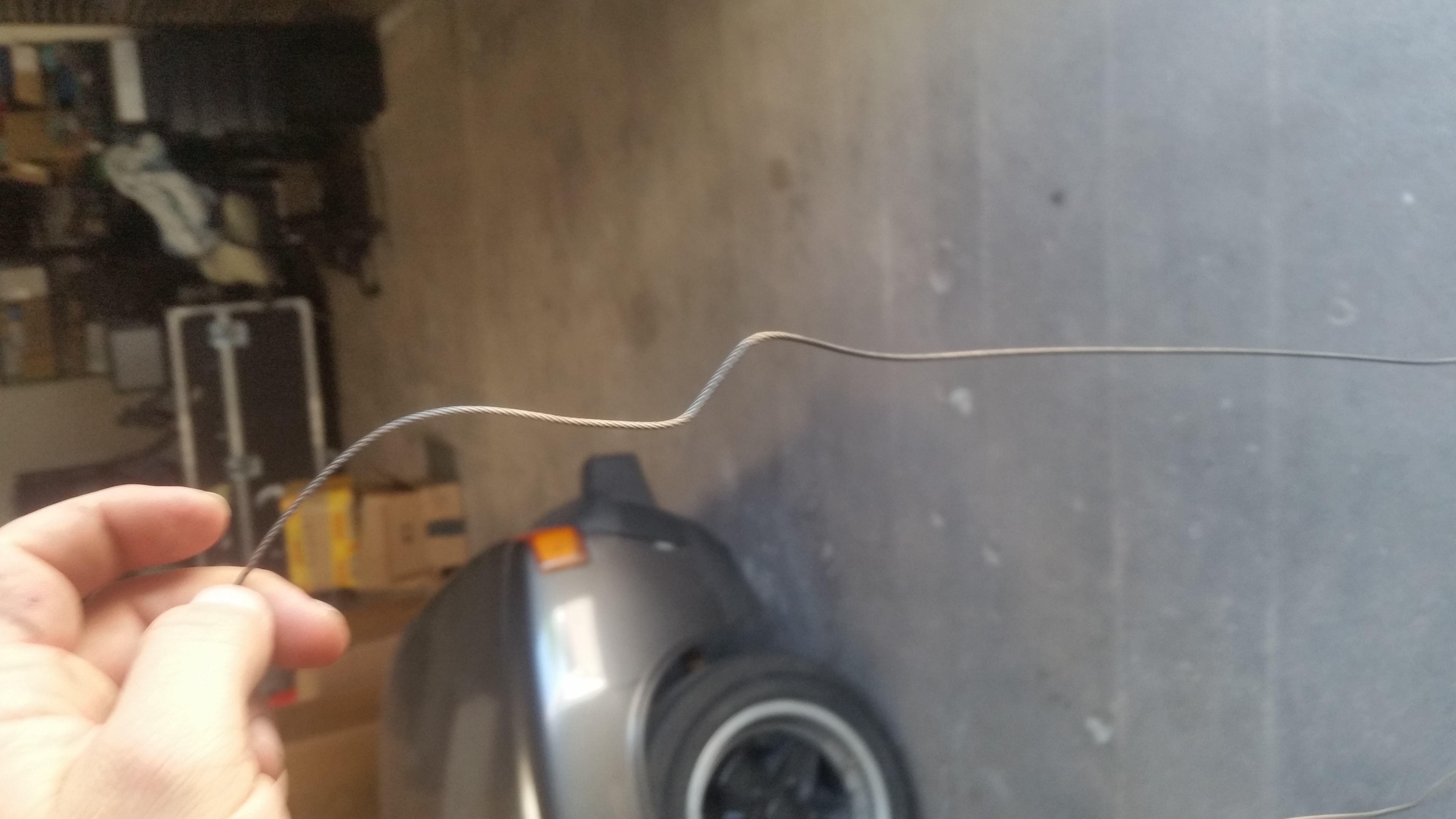

Wooohoo.. Cable out and it is most definitely bad. It takes a ton of force to pull it through.
Next step, install the new one.. Maybe tomorrow.

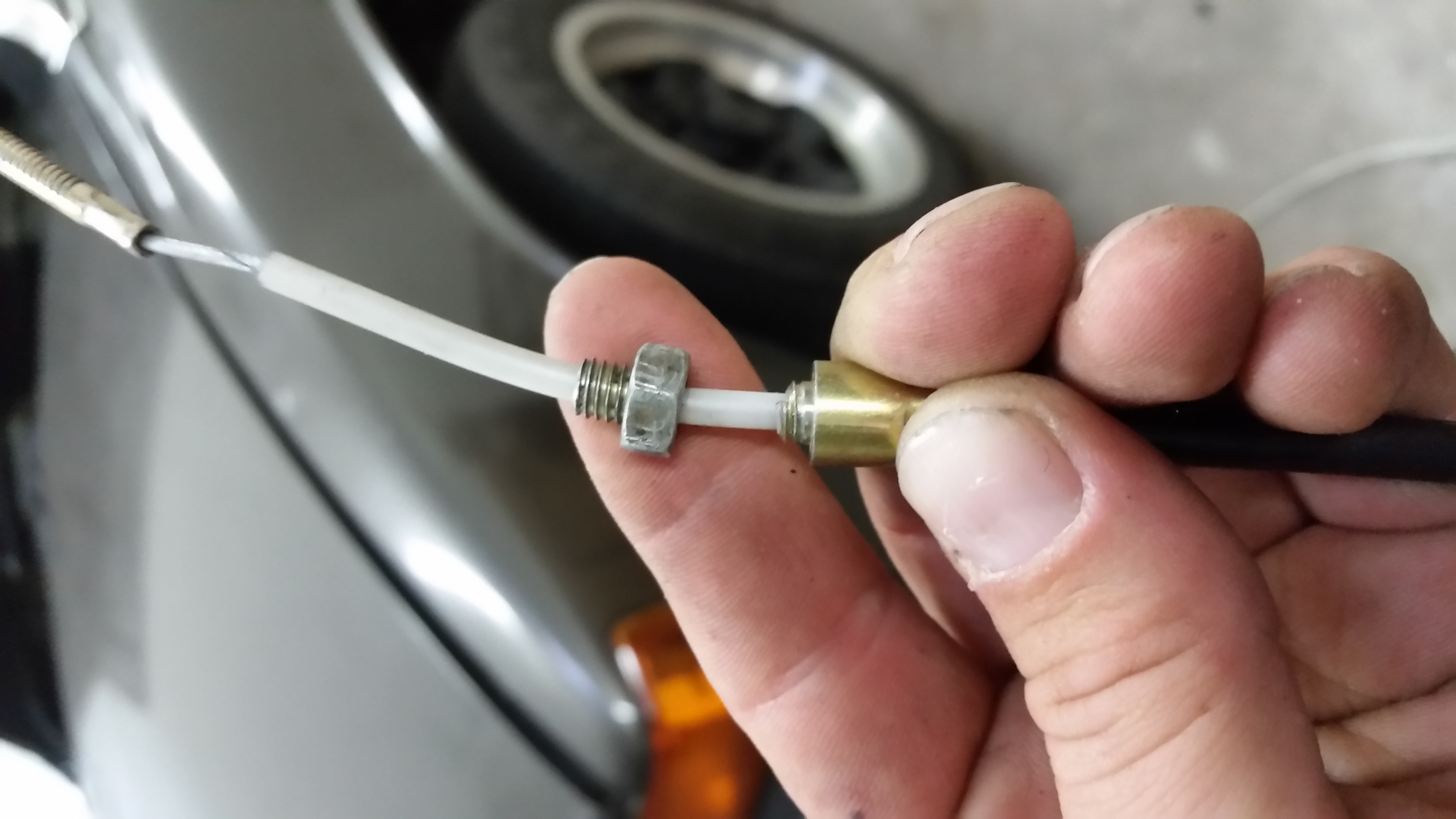

I go to spin the bolt on to the engine side linkage and I'll be damned, this bolt is spinning pretty freely.. Hmm.. Yep, threads sheered off. Fuch (I've learned we use that instead of the F word to spare the children's eyes or something) now what do I do?
Oh look! Another cable! Today is my lucky day or something. One problem, no threads on the engine side of the cable to spin the connector on. hissyfit.gif Well, there's some JB weld up front in the trunk, why not? It's a very close fit and it would hold really well.. I can order a new cable and drive this for a few days, hell I'm an expert at changing cables now!
Well, new problem.. I forgot to put the nut through 1st before the JB hardened around the connector.. Great, I can't bolt the end down now.....
New cable on order, here Tuesday I hope! Thanks Glen!
This probably should have been a blog post or something...
tldr;
I screwed up the (amazingly) 2 spare throttle cables Dad had in his car...

Here's the first whoops...
