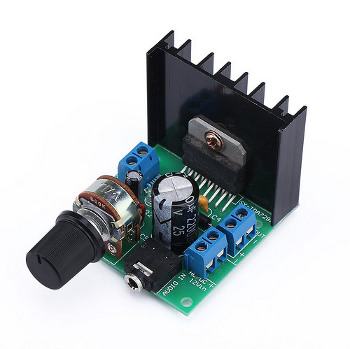

I'm going to use one of these in my build. DROK mini amplifier.
IPB Image
It's just an AUX-IN with a volume knob. You supply it with 12v, and run the speaker wires.

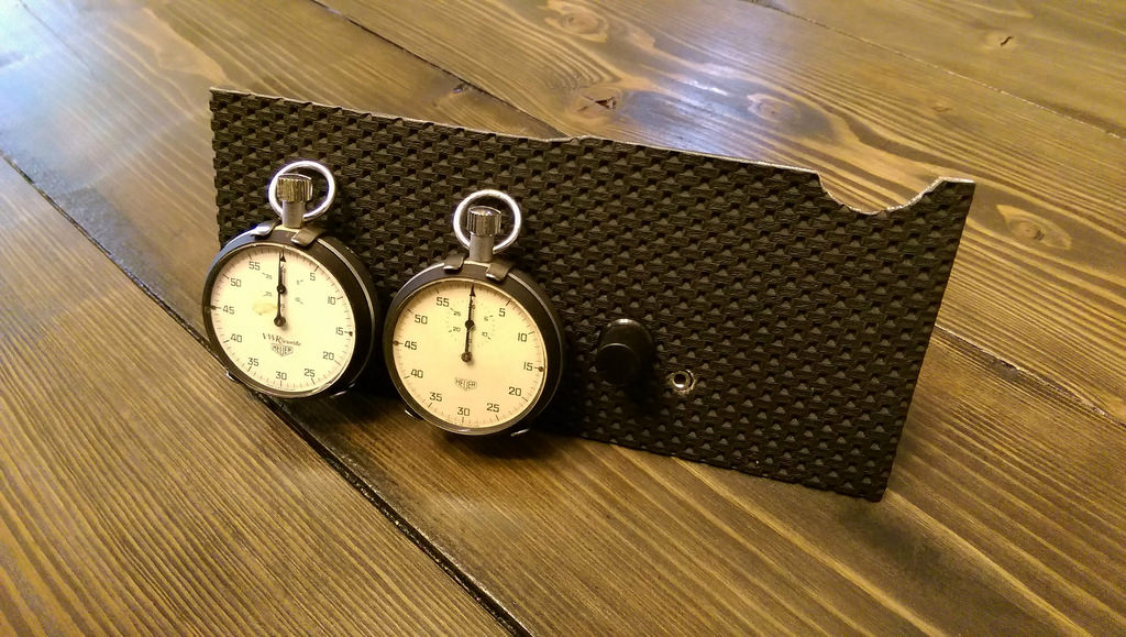

Here it is on my radio delete plate next to a couple stop watches.
IPB Image
If you've quieted up your interior a lot it should be enough volume.

7TPorsh
QUOTE(Optimusglen @ Sep 16 2016, 09:24 AM) *
IPB Image
IPB Image
This is an awesome find....under $15. Probably cleaner output than using bluetooth. The others I have seen have a larger panel; this is only a volume and jack.
Does it work well for you? Enough power output?
Have to crank Van Halen's first album; only way to listen to it is at 98db!

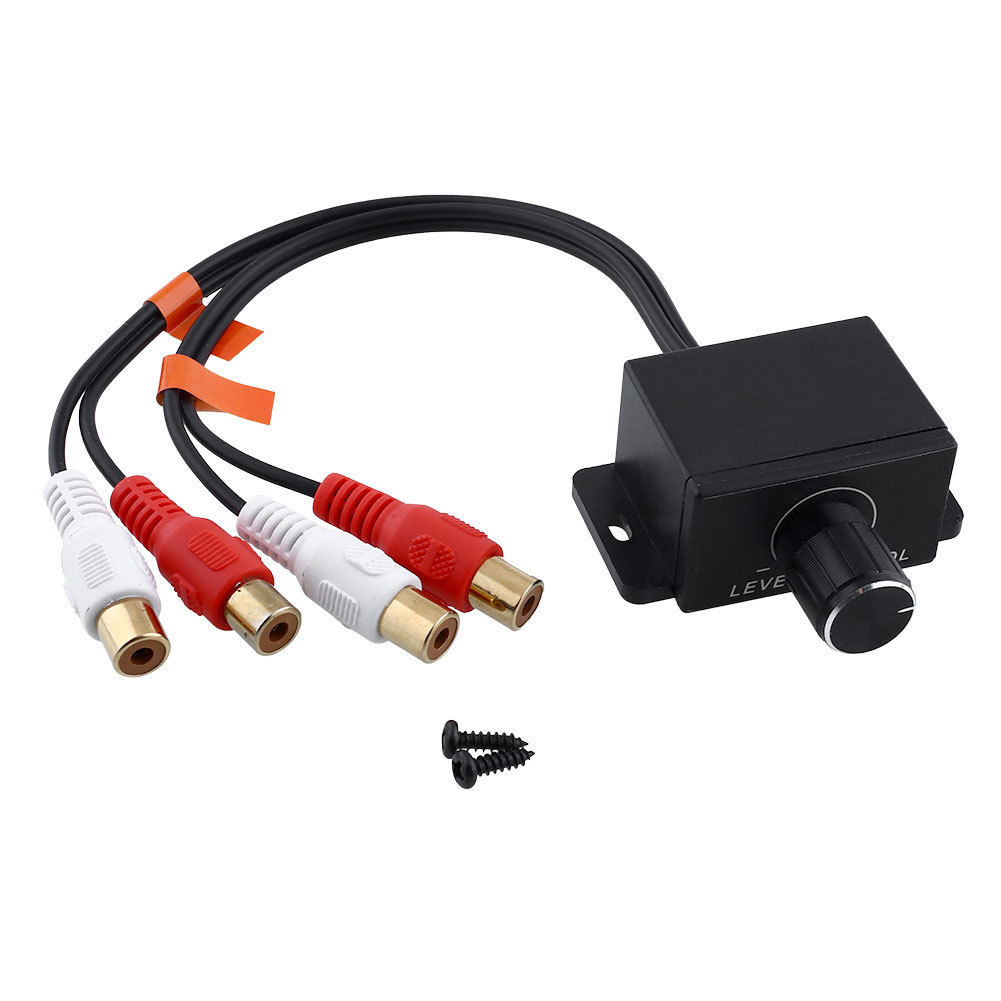

Vol Knob
https://www.amazon.com/PAC-LC-1-Remote-Ampl...+volume+control
This is another option that I considered for my setup. Lots of options like this out there for boats. Hide the volume control in your center console and be good to go.

If that little amp doesn't work for you then look at this.
Solely a volume knob. Add an earphone to rca cable to the player and an amp to the speakers. The new digital amps are small enough to fit in the center console with plenty of top off power.
Knob comes off so you can also mount it in the dash.

Actually that's not that bad looked at the reviews on amazon, they come in 10wx2, 15wx2 and 35wx2, the 35x2 is $20.
Cons is it's for car audio so it runs better at 14v (if you're thinking PC audio, 12v), it gets hot and no case. Also it won't run a subwoofer and is only 2 channel.
Pro is it doesn't distort at high volume, sound is pretty good and it's 20 bucks.
