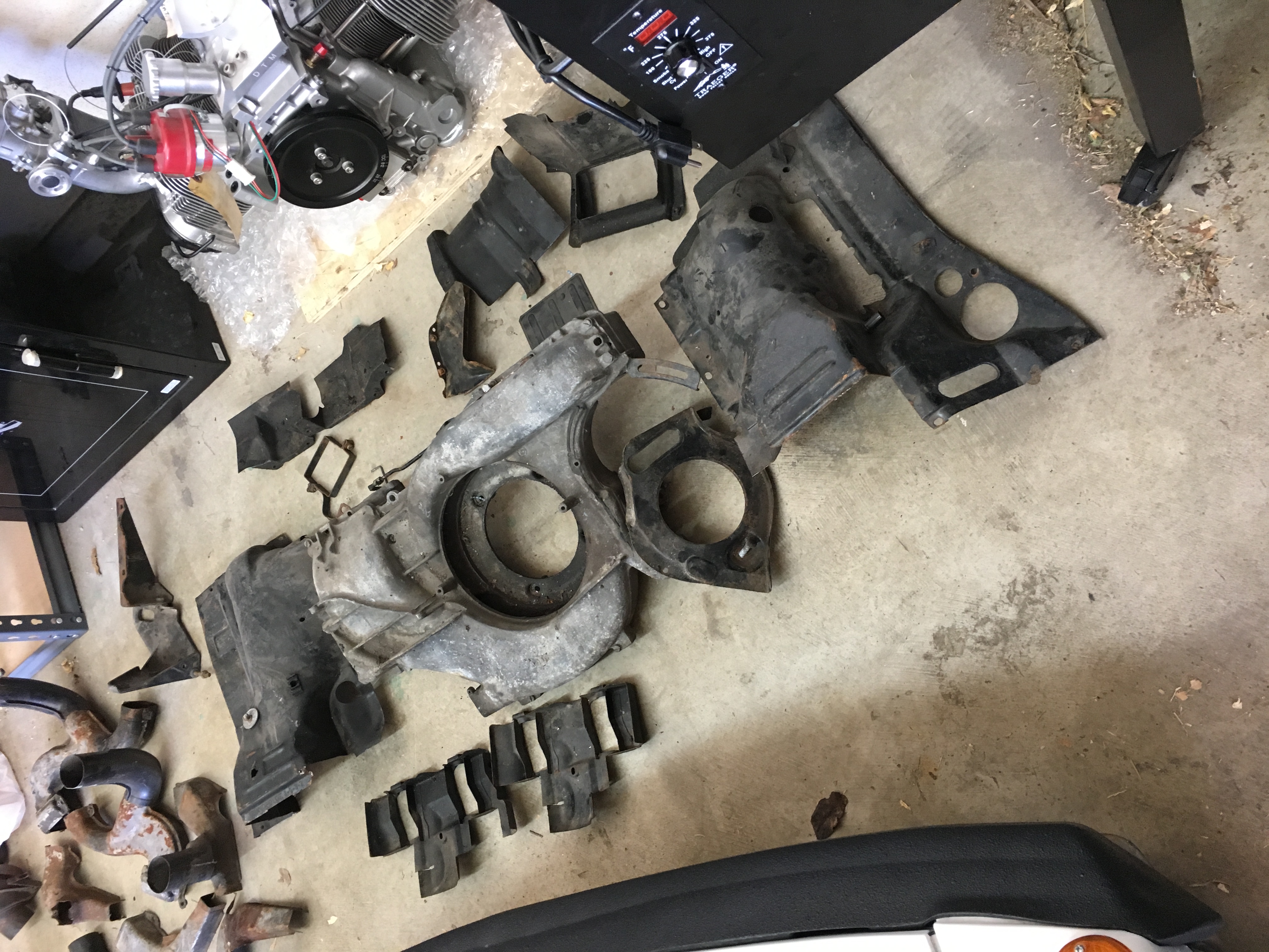

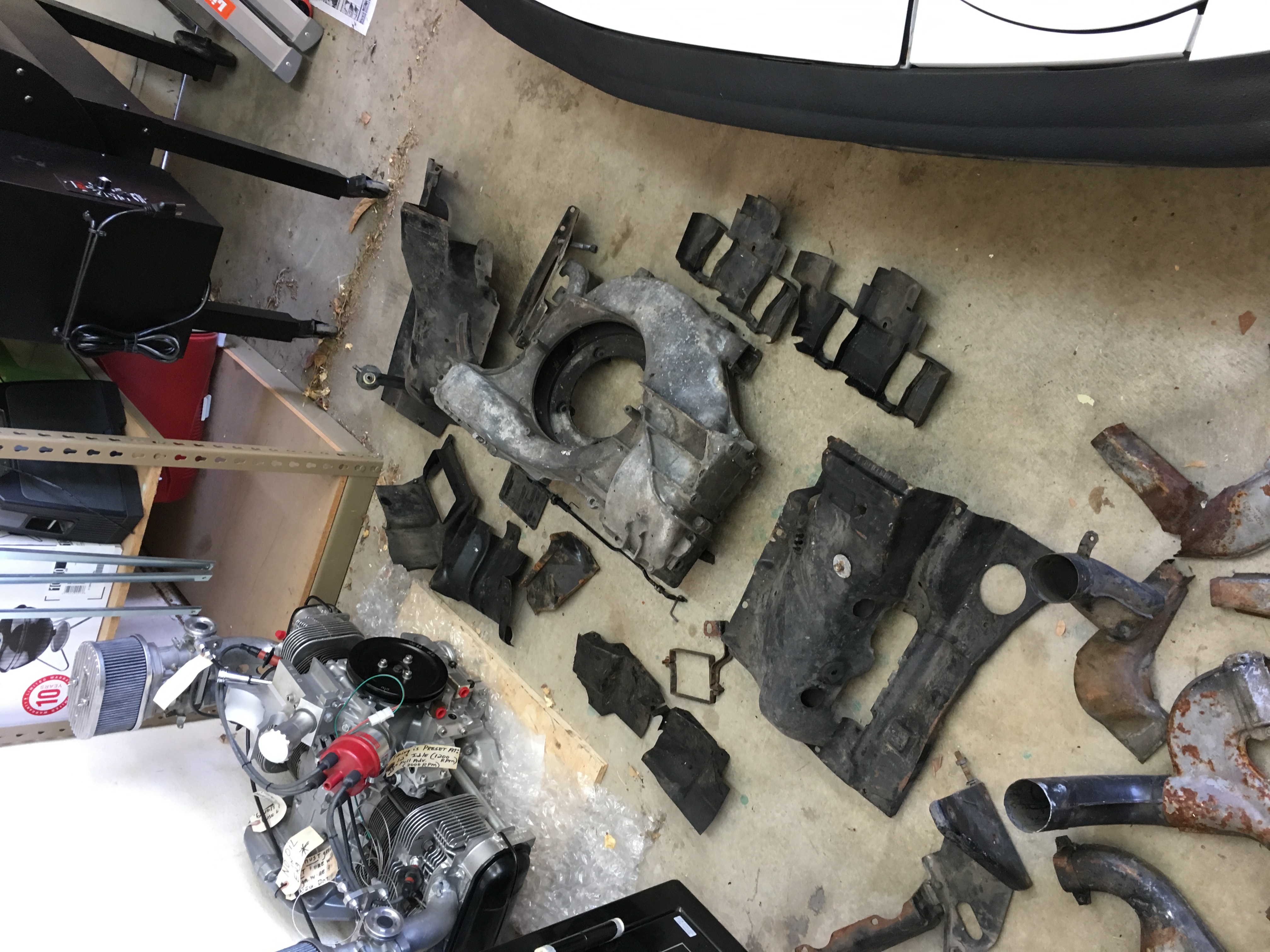

I am gathering up engine tin to install on a long block, but I'm not sure what I am missing. Diagrams are not as easy to find as the type one. I want to get all pieces powder coated at once. Here are some pictures of what I have. Not pictured- oil cooler, thermostat, fan pully, and the piece that goes above the flywheel.

Items I don't see in your pix (or the list of parts you state you have)
There are two pieces across the front of motor, attaching to the fan housing and cylinder top tins
IPB Image
There are also two warm air guide plates that attach under the push rod tubes not shown. A lot of folks don't run them, but if you want a correct complete set, you will need those too ...

Mark,
You are correct that the warm air guides are not there.
To the OP: Are you using the late 75-76 heat exchangers or earlier ones? You have both early and late J tubes in the picture. The warm air guides are different for early and late heat exchangers. I should have either set. You are much better off with the early heat exchangers. What exhaust are you going to use? That affects which heat exchangers are used.

The PET is you friend, look at illustrations 115-00 & 115-05 for engine tin

Is that Bruce? Now I recognize you. I bought a pair of seat height adjuster mounts from you at the swap meet a few weeks ago at your shop. I'm not going to run exchangers at all, I haven't purchased an exhaust yet, but it will have headers smile.gif. If it's chilly, I'll put on a sweater! I'd gladly trade all the heater components for the tin I am missing (the front piece in the photo, and the piece above the flywheel)

I do have the guide plates, they are installed in the motor already. I do not have the piece you show
