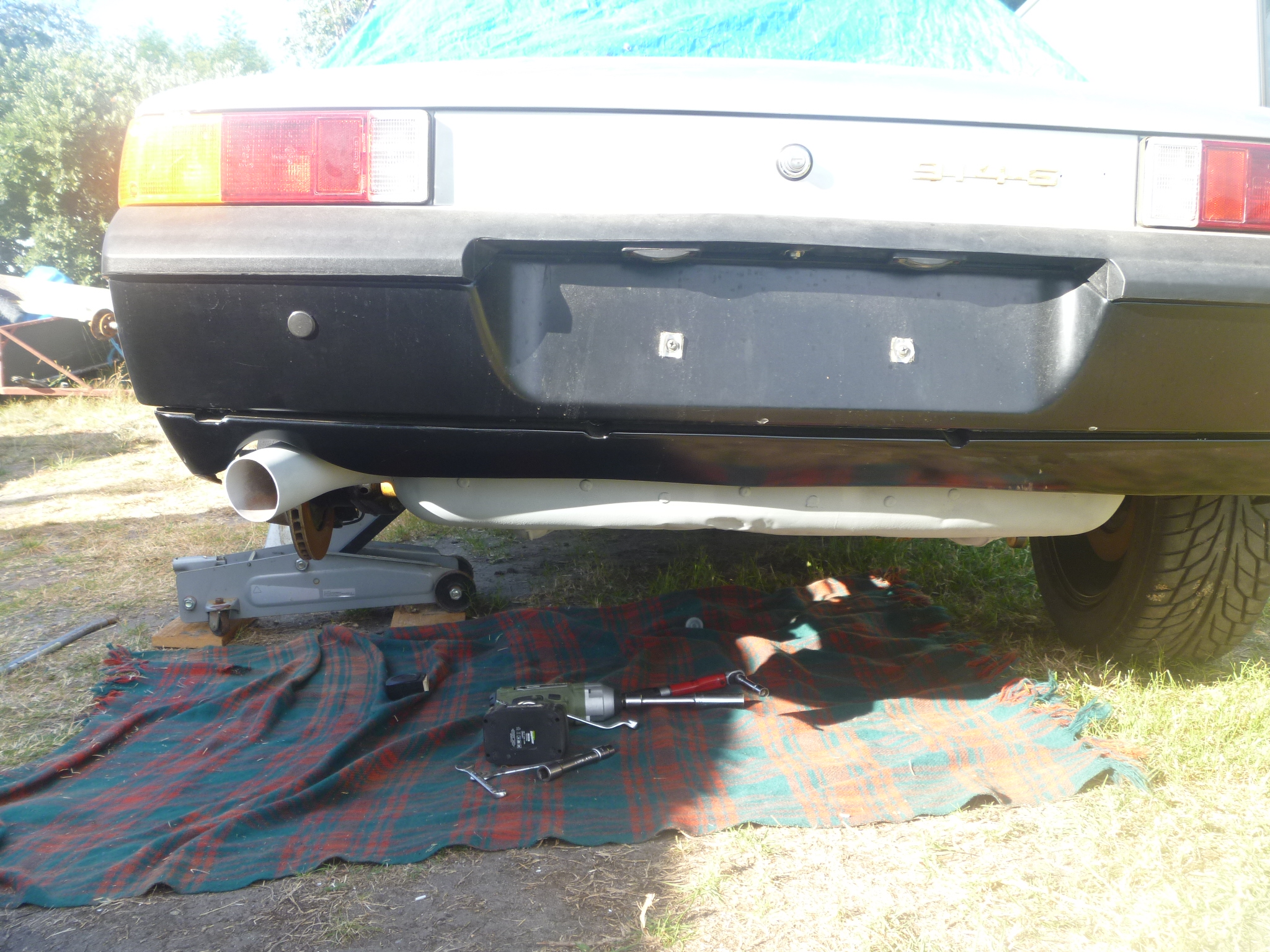

agree.gif ,only way really,PO supplied muffler had a large exit pipe tack welded on when I got it,wasn't to fussed with the clearance so I cut one weld and moved it.
Its a large pipe but I liked the look better than the puny sized stock one,it produces more noise for sure .Click to view attachment
I think there is a guide somewhere (Pelican forum?) to convert a one in one out later muffler to two one out,these mufflers can be bought used for way less $$,I did think of it as I have one that is in much better condition than the dented one I'am using now.
IMO the stock muffler is a well made and a cheap alternative to expensive aftermarket ones that offer a little more power,the downside is the weight however.
