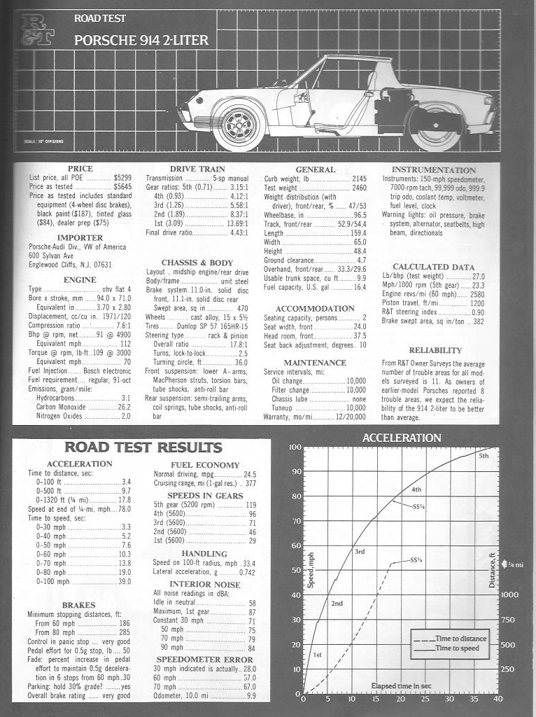

OK, what's what here. In another thread Tom posted a factory data sheet re: '73 914. It list the Curb Weight as 2145 and the As Tested weight as 2460. Just curious because my water cooled 6 conversion came in as 2340 with a full tank, spare tire and tools in the trunk. I should add this was before I added the AC but the compressor was on the engine so I'm probably about 25 lb's heavier now. TIA, Kent beerchug.gif

That was probably the 73 R&T article which I posted Kent, which was based on the factory numbers in the owner's manual & other Porsche/VW specs..
Curb weight today would only include the car with all fluids full (fuel, oil, coolant, trans fluid, etc.) & a 150 lb driver. However, I don't know how closely that was followed back in the day.
So for your 6 conversion - fill all fluids, remove the tool box & other shittage, weigh the car & add 150 lbs for a "standard driver" to get your as-modified curb wt.
FYI - Full March/April 1973 R&T article on the "914-2":
Click to view attachmentClick to view attachment Click to view attachment Click to view attachment
> Note that I had my `73 914-2.0 up to 126 mph indicated on stock 165HR15 tires (IIRC it was at 5600 rpm - with a non-limiting distributor rotor), on I-15 through the Virgin River Gourge back in the 1970's (after midnight), so the performance specs from Porsche were often understated.

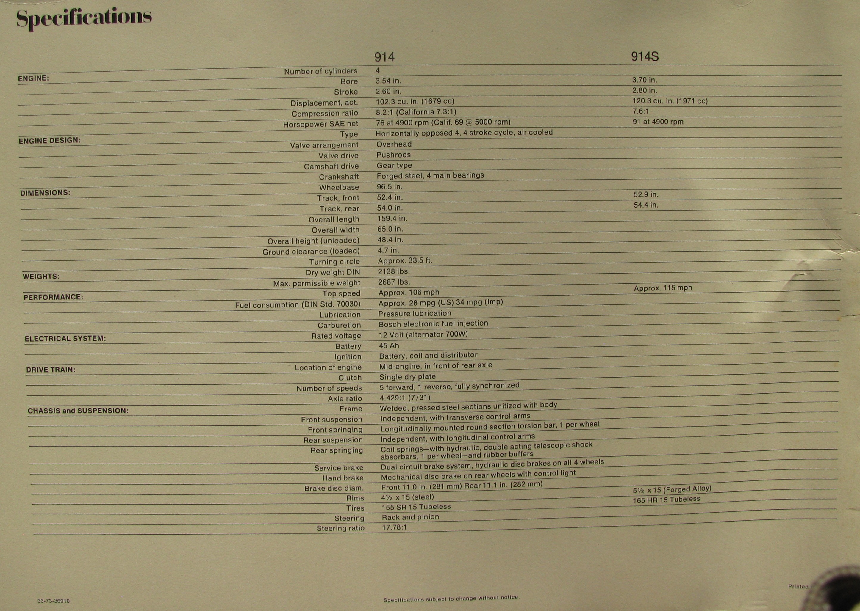

FYI #3 - Specs from 73 MY Porsche+Audi official sales brochure (both 4 & 13 page versions similar chart, this is the 4 pg one) for the USA dealers (Canada used Imperial Gallons), which I had both from my 72-73 "starving college student drool visits" to the SoCAl Porsche+Audi dealers (printed Aug 1972 - apologies for my camera strap over the lower right corner info):
> Note that later in the 73 MY Porsche+Audi also had a version called "(14-2.0 Sport" which dropped the included Appearance Group of the "914S" & maintained the Performance Group of options (Fuchs 2L wheels & F & R sway bars), of which Dave K's Orange/Black is a beautiful example (I don't recall seeing a brochure with any "914-2.0 Sport" designation printed, but Jeff Bolsby's 914 classic website's Model Numbers section does list a model number set for both the "914S" fully loaded 914-2.0 & "914-2.0 Sport" equipment packages, with the variances for CA, 49 state & ROW sub-versions). This was done to keep the performance which saving costs & lower the price, as the W. German DM escalated vs. the dollar & jacked up the prices of the fully loaded "914S" package from $5299 WCPOE to over $7200 in less than 12 months! blink.gif

Tom, 2138 dry + 15gal gas = ~93lb's + 5qt's oil = ~9lb's = 2240 I left out brake fluid but does that sound close? beerchug.gif
