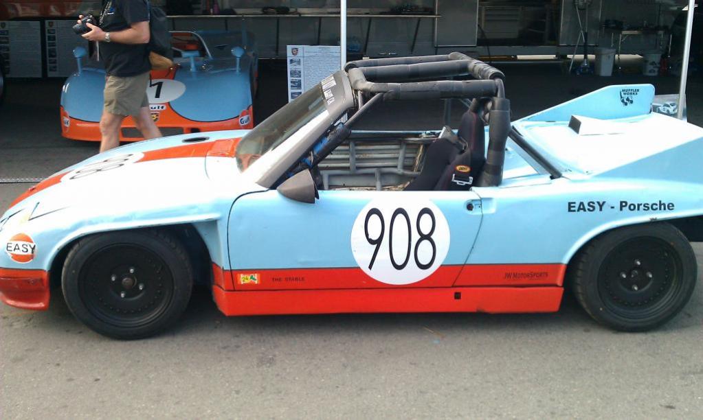

This started back in October, I was at Buttonwillow raceway for a 24 Hours of Lemons race and pitted across from my team was this car:
IPB Image
They were working on it most of the weekend and I must have walked past it 100 times. Next weekend I was bored and got on cl and found a 914 around the corner from me. It looked like it was sitting for awhile, but looked complete. I checked it out and after a week of thinking and learning about 914, I decided it would make a nice project for the winter.

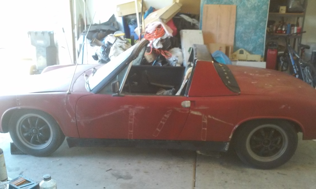

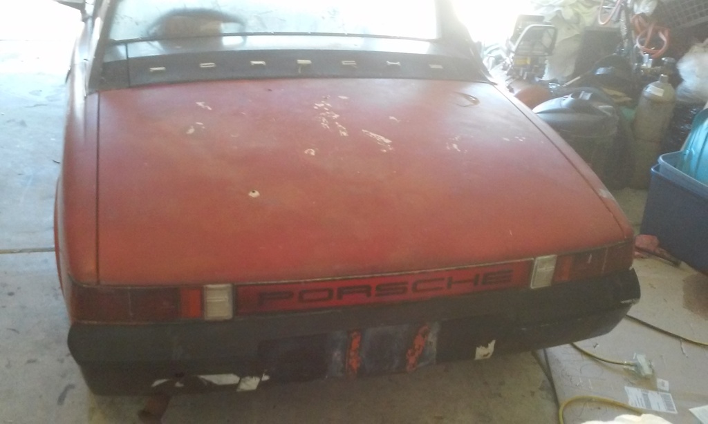

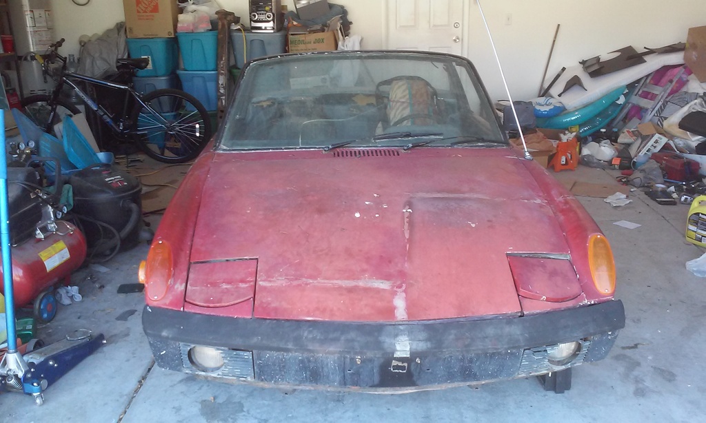

Got it home and spent the first few days going over it to get a better idea of what its going to need. Its is filthy, Looks like it has been siting under a tree or in a barn for years with somethings living in it.
IPB Image
IPB Image
IPB Image
IPB Image

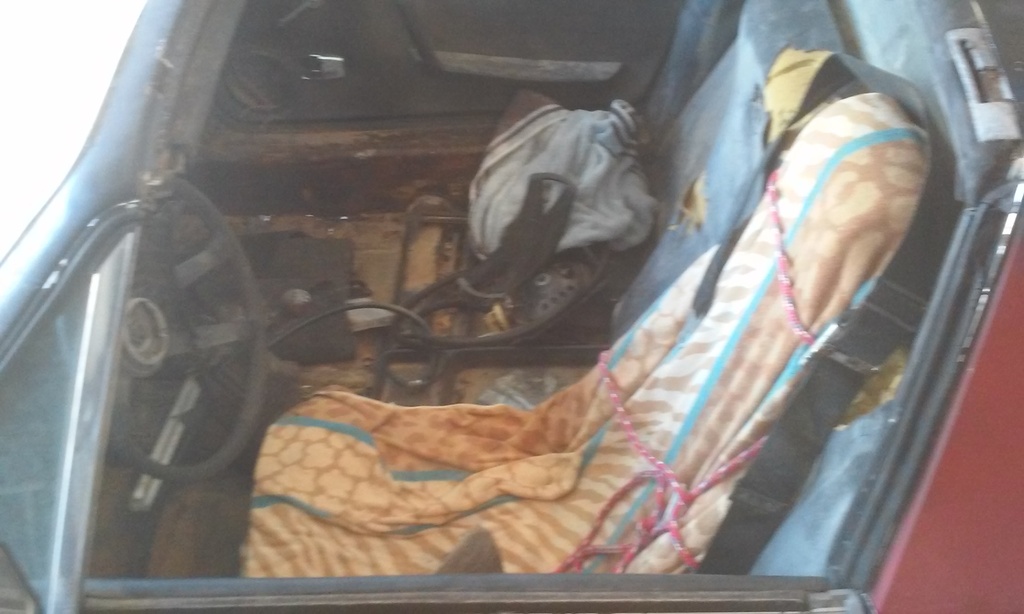

Have both seats, cloth is mostly gone, foam is rock hard and smells real bad, need full reupholstering. Carpet gone, dash is intact, but will need to be redone.

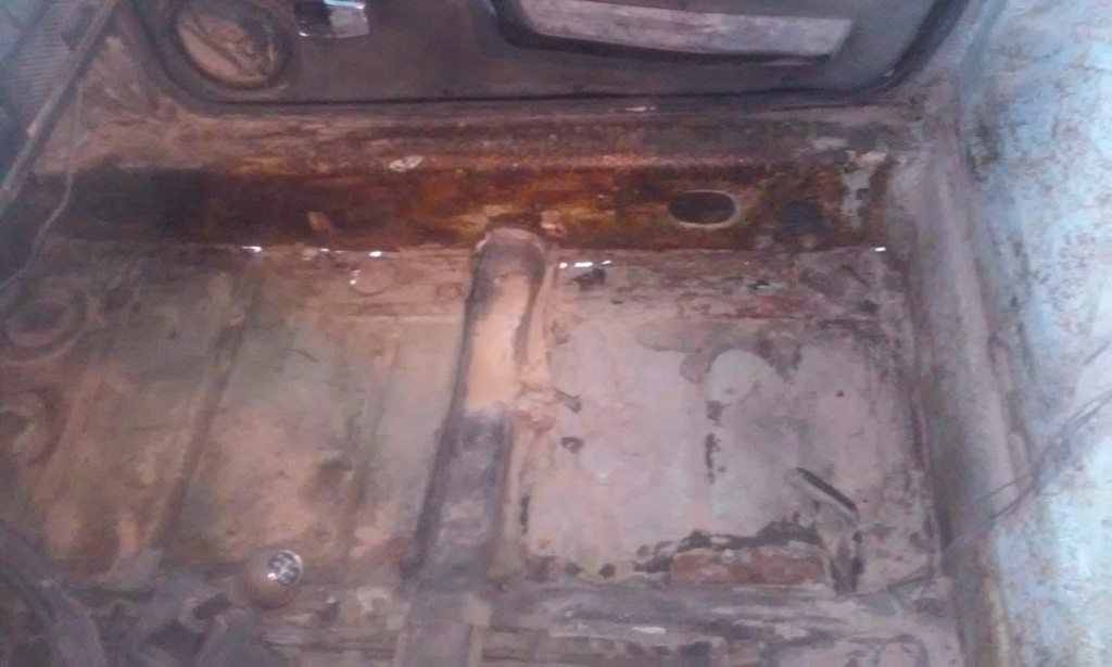

Pull interior put, vacuum out the 2" deep mound of sand, leaves and who knows what else out and floor is not bad, but enough light showing on ground to be good. New floor pan.
Tear into the rocker panels, pull off outers, not too bad but could use replacements, driver iner ok, needs some patching, pass side alot more work, Constant rain of sand and rust make me afraid of whats underneath. At least its more sand the rust.

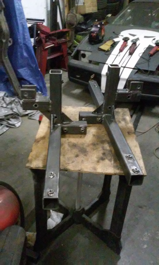

I decide to build the auto rotisserie I've been thinking about. That will keep me busy for the next several weekends.

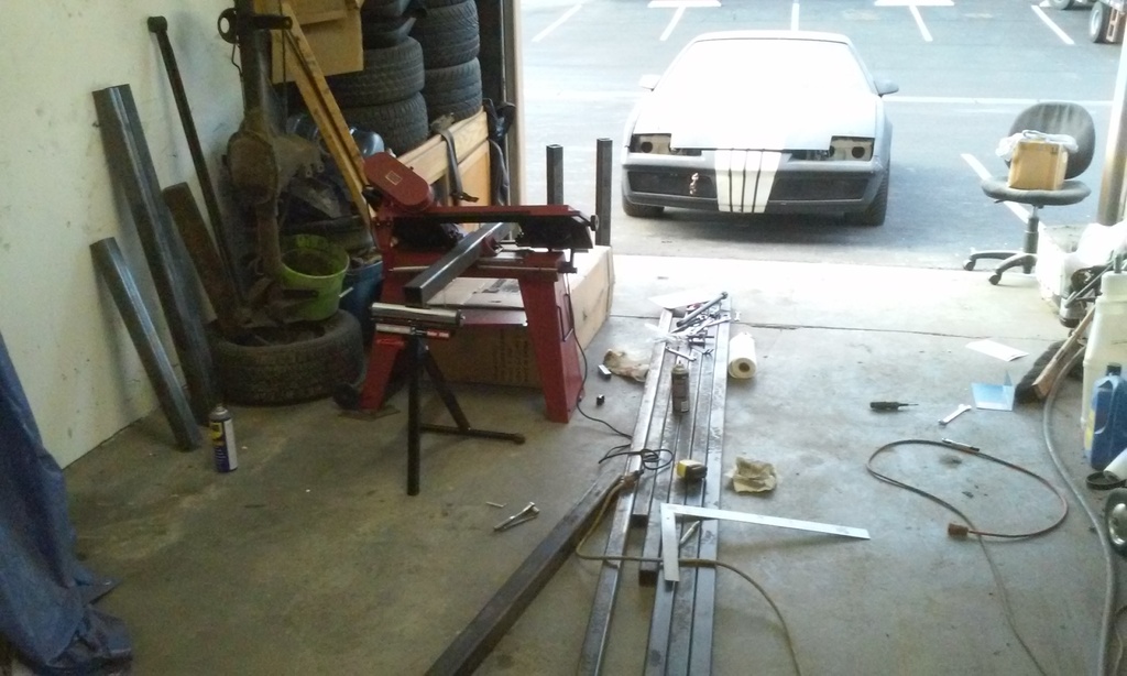

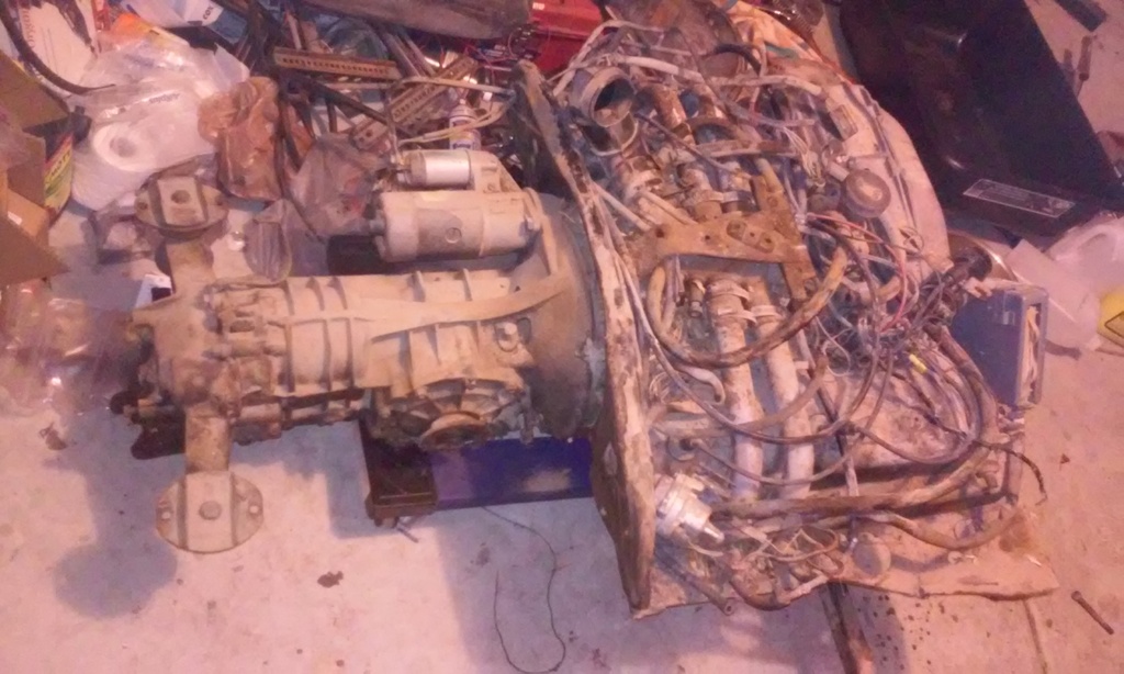

Been busy at work, not much time for play. Decide to pull the engine and transaxle out. And slowly start stripping body. Ordered a rotisserie kit from US Car Tool and some steel from California Steel in North Las Vegas. and start on the rotisserie.

Didn't get much time to do real work on the car. I did finish the rotisserie, slowly stripping the car down, and have been poking around the car to see what needs to be done.

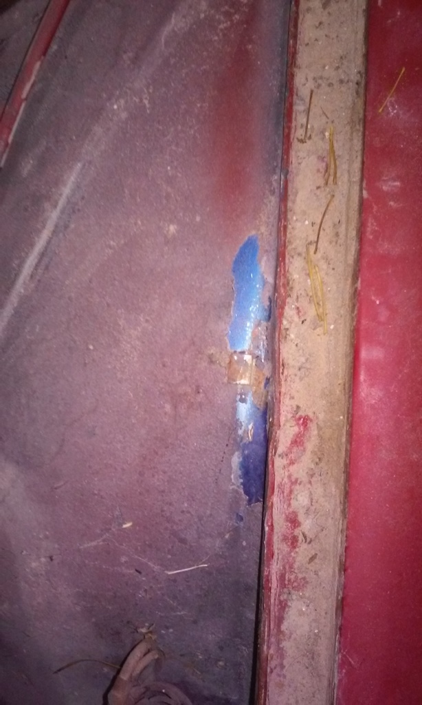

Driver's door jamb where the paint code sticker should be and more evidence of blue. Anyone recognize this color?

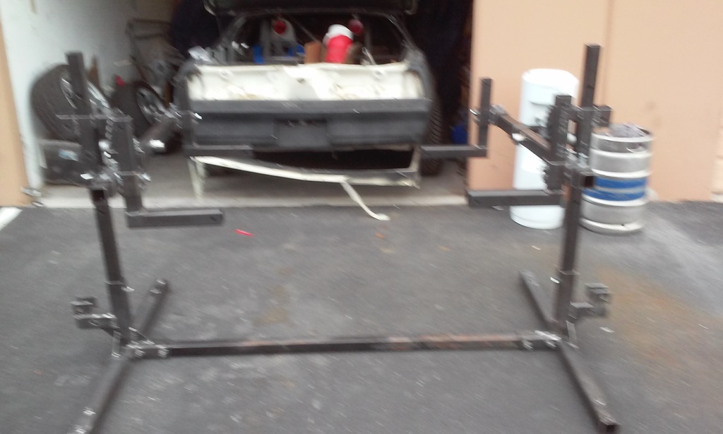

Blurry picture of rotisserie when I ran out of gas just before finishing. Put it together to see what it would look like.

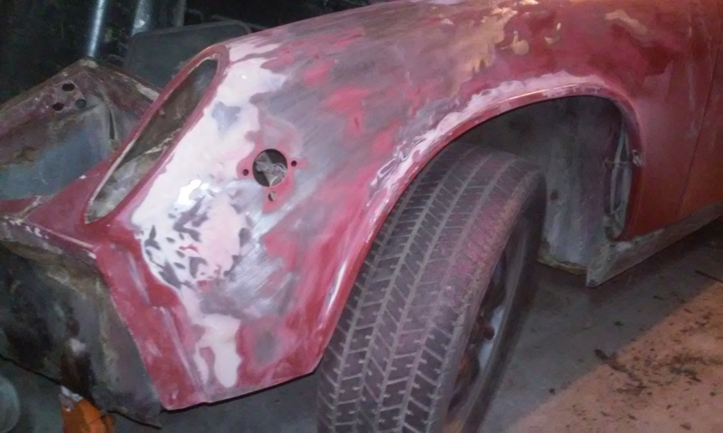

Got bored one night and started sanding, found what I suspected, corner has been damaged. Doesn't look too bad, so far.
