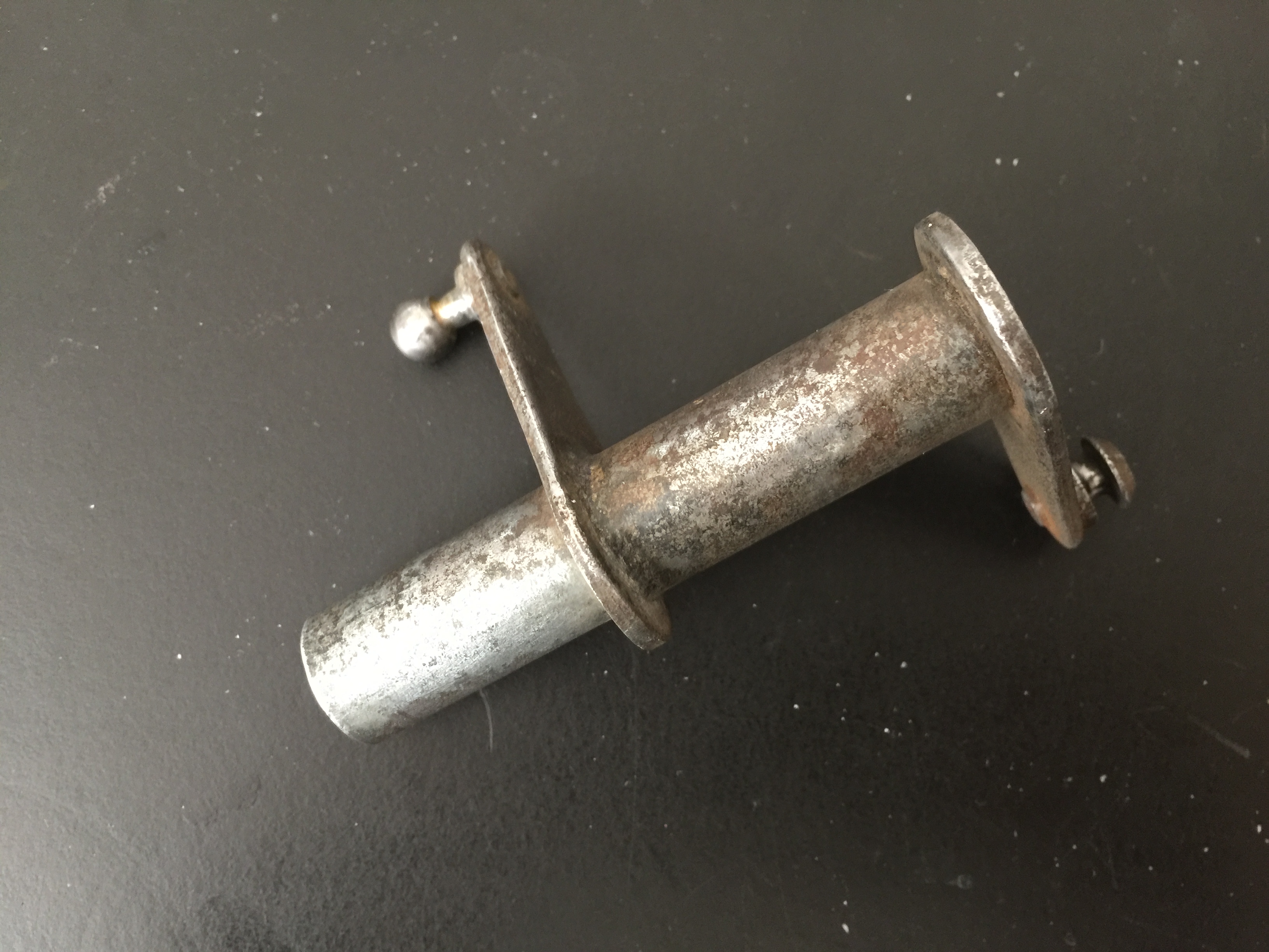

Feb 24 2017, 06:18 PM
Found one in my stash of 6 parts.
//SOLD//PM sent.
