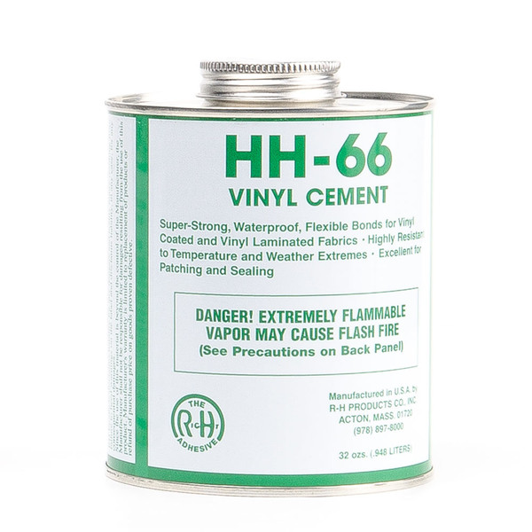

My best work was done with HH‑66 Vinyl Cement
