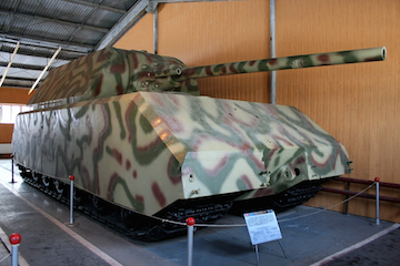

I now have a better understanding of how some of you folks feel about it. Sounds like it is to some degree a personal or cultural thing. Some of us fantasize or participate in days at the track. Others want to ford streams. Which is fitting given one Porsche design
Click to view attachment Panzer VIII Maus. The vehicle's weight made it unable to utilize most bridges, instead it was intended to ford to a depth of 2 metres (6 ft 7 in) or submerge up to a depth of 8 metres (26 ft 3 in) and use a snorkel to cross rivers.
I better put the top up.
