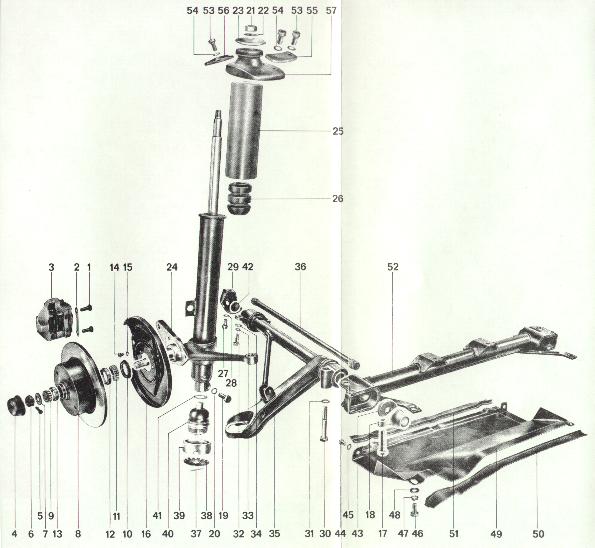

Adjusters are at the rear of the front torsion bars, car needs to be lifted off the ground to make adjustments, I believe it is 11mm, the adjusting screw.
Adjust, lower car, settle suspension, measure and no more than 5 mm .2" difference from side to side, factory manual states, 90 mm wheel center to center of torsion bar, but I measure the height from the adjuster to the ground.

From Dave at the Bird: Part # 17, "adjusting screw". Screw it in to raise the car, I think. Measure, adjust, roll the car around to settle the suspension, measure. Repeat until you've got the results you want.
