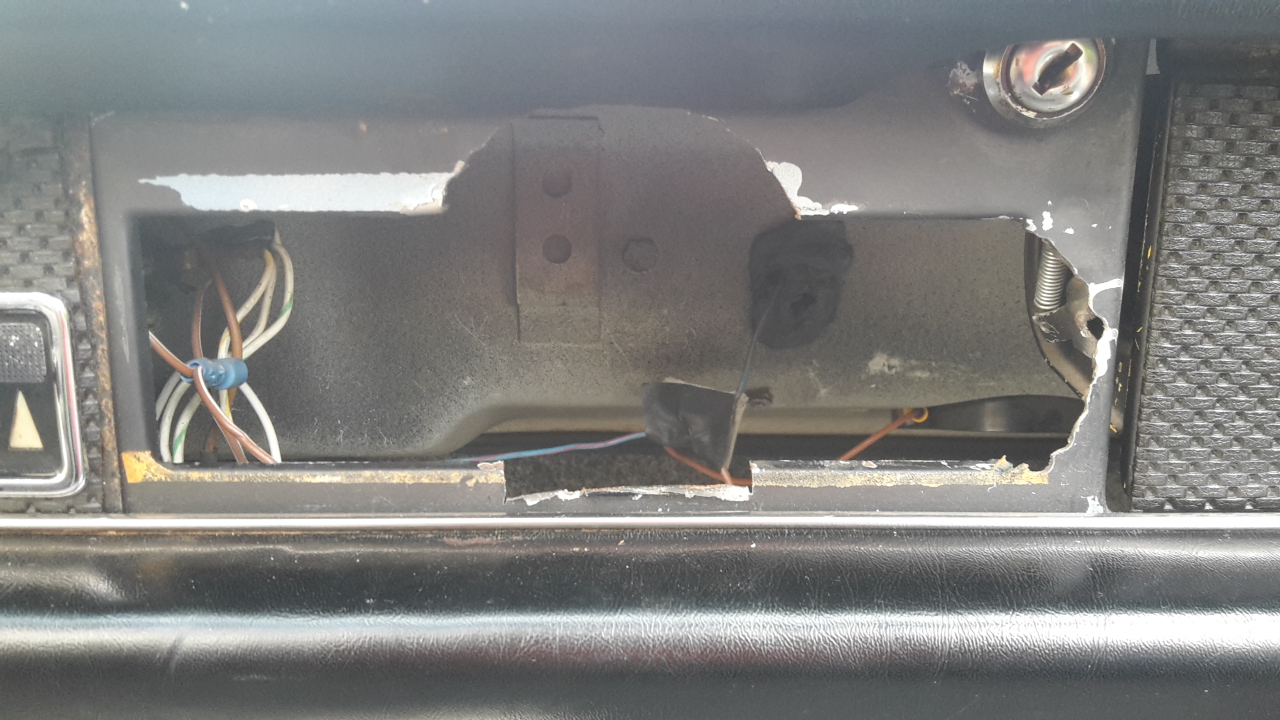

Trying to install the radio that I recently bought.
Unfortunately the previous owner cut out a part of the dash to get some gaugs in.
Anybody an idea how to tackle this mess and to firmly install the radio in the existing opening?
Under "normal" conditions, are there any accessories that I should have to install?
Thx
falcor75
I would get a new thin steel plate lasercut with the DIN opening for the radio. Then bend the pieces of the dash that are molested into shape, make a few small tack welds to attach the new plate or just expoxi it in place and cover it with a fresh piece of basketweave and then go ahead and install the radio.

914Rubber sells a radio block-off plate and a DIN sized plate with the correct vinyl facing. I believe he also has original style radio plates available, but they're not on the website yet.

You might want to put a WTB ad in the classifieds to see if anyone has a stock radio plate so you can save the effort of cutting the necessary holes in a blank plate.

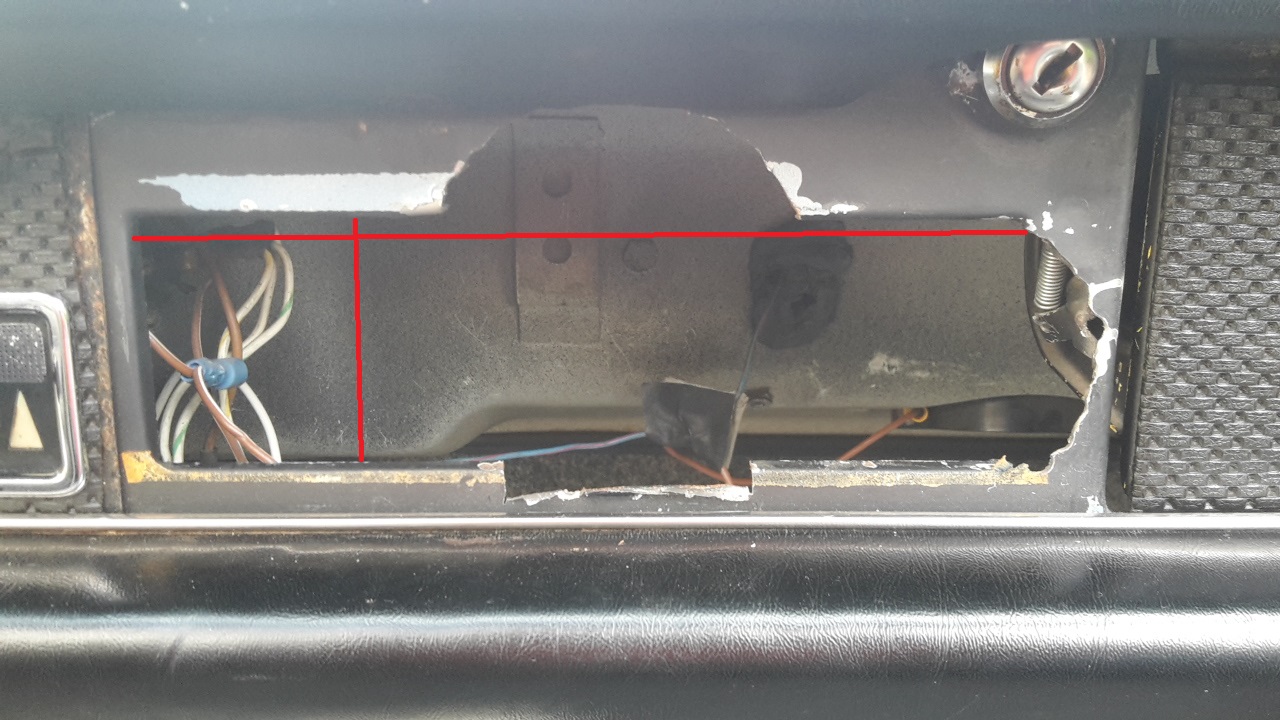

I noticed that the original opening in the dash is slightly larger than the measurements of the radio.

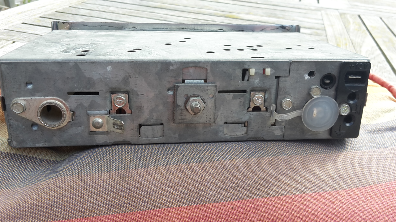

Does it mean that the face plate together with the center bolt of the radio attached to the bulkhead of the car are the only points of support for the radio?
For the moment not any connectors yet (bought the radio bare).
I imagine that the only difficult to find connectors are these for the speakers?

Those speaker plugs are on ebay last time I looked,you seem to be missing the backing pieces that that go behind the faceplate...not sure if you have them ?.
There is a locating support clip that mounts on the dash ,that appears to be missing also,I would suggest you put up a WTB for those parts and get another dash plate also.

If you can't source the correct speaker connectors, banana plugs will work.
You can attach the faceplate with double sided tape, then use the rear attachment point to affix the radio to the bracket on the car's firewall. That should be adequate to keep it in place. Alternatively, cut another plate of metal to use as a backing behind the cut up dash face.

I had a similar problem, but my opening wasn't nearly as bad or as wide as yours. I went to a car stereo place and got a generic, plastic blank.
Also, you'll need to support the radio at the rear; the front plate is not made to support the weight of the radio. I made a little bracket out of sheet metal. I cut 2 holes in it and mounted one to the back of the stereo (there's usually a screw for this; it appears you have one right in the middle) and another on the car (my car had one already). There's limited space and it's a real PITA.
