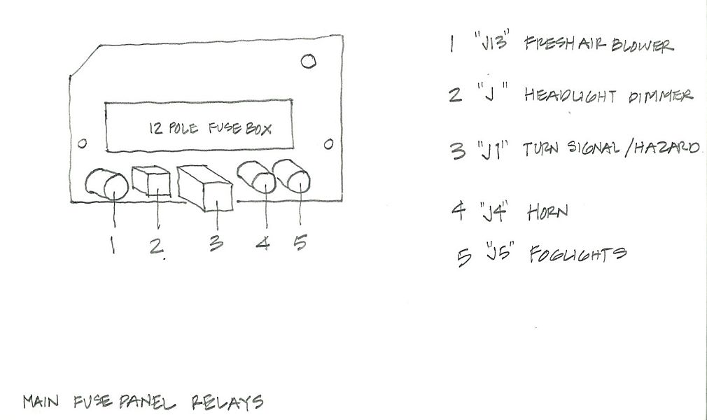

On my 1975 car it's the boxy, square relay on the fuse panel. Not sure if it's the same for your car.
IPB Image
oakdalecurtis
If it’s not like the diagram, just remove relays from the board under the dash one at a time until signals go off, Bingo!
