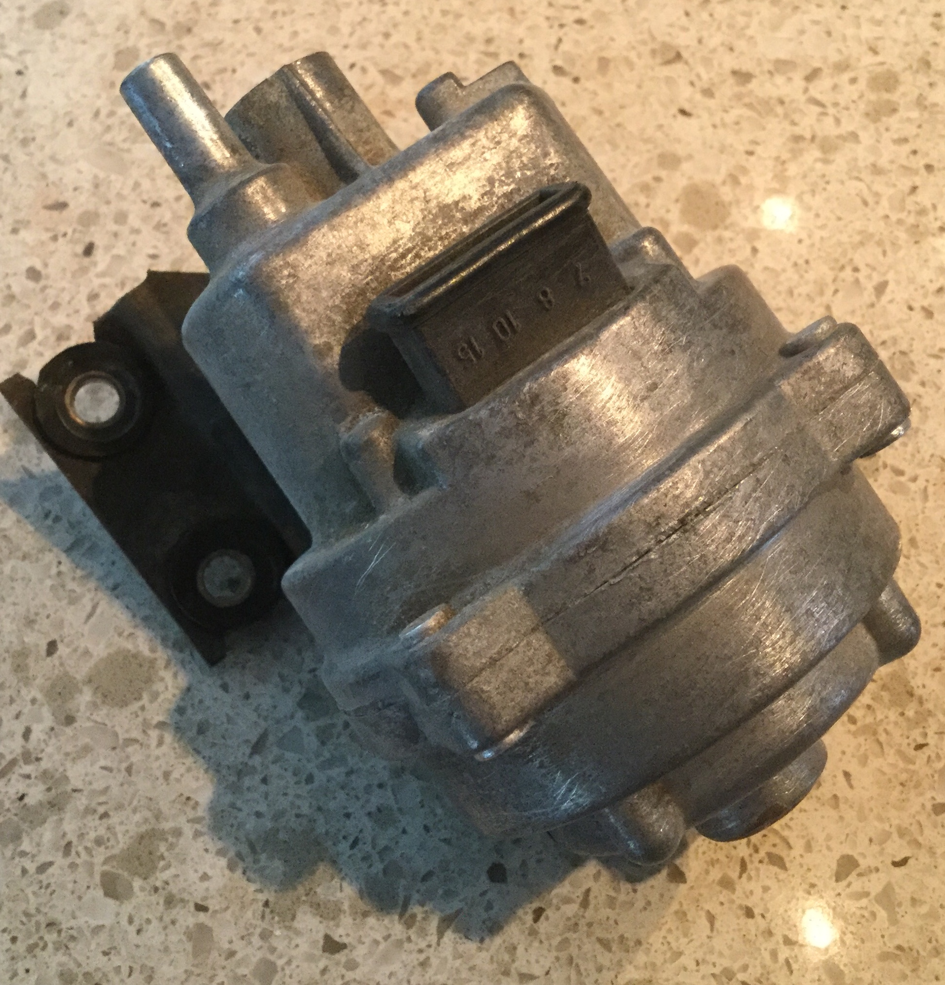

Have one from the '71 donor, not sure if it is worth anything?
914Sixer
Mar 12 2018, 12:05 PM
Jeff Bowlsby might be interested.
Tdskip
Mar 12 2018, 12:12 PM
Does the rebuild then?

Yes, nobody make a new replacement yet, they only get rebuilt.

I pulled it off so hopefully this will help someone else at the car in the road.
What is a friends and family sort of price for a core? ( it may be OK for her I know but I don't have a way of testing it )

Bowlsby charges $25 for a core when he rebuilds an MPS.

Sorry, should of asked initially if this is off a 1.7 or 1.8? Is there an easy way to tell?

1.8 is L-jet so no MPS.

If you find a part number starting with 039, it's a 2.0 application, all else is 1.7.
Physically all 914 MPS are the same, only the internal adjustments vary for the specific engine and year application.

Thanks guys, and tips on finding a part number? I can’t seem to locate it.

Ah, found a stamping.
026....
Below that is 022...

021 and 022 are Type 4 engine parts ( 914, VW Bus, VW 411)

QUOTE(mihai914 @ May 20 2018, 01:10 PM)
Not quite.
Early units have a different length spring extension in the casting than the rest. I'm not sure of how the update matches up to model & year.
Also, internally, the 2.0 units have a spacer ring which goes between the diaphragm and the part load stop plate to provide increased range between idle/part throttle and WOT.

The important part of the PN is the last three numbers, stamped into the case:
037 = 73 2.0L
049 = All 1.7s
043 = 74-76 2.0L
I do pay $25 for cores if you want to give new life to another 914.
