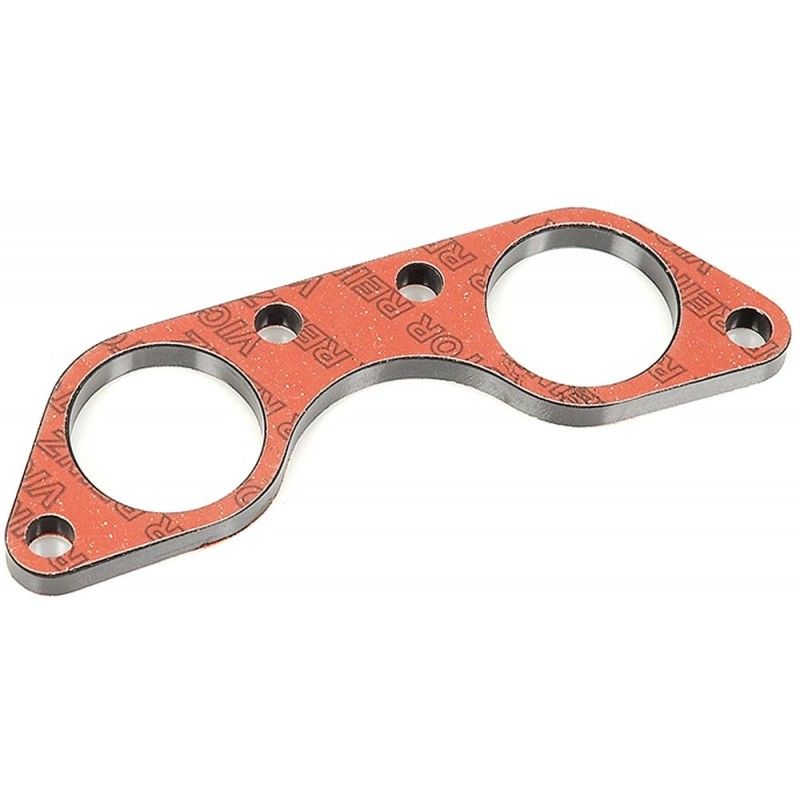

Are you running the phenolic (sp?) spacers/insulators between the intake manifolds and the heads?
They are important in keeping the manifolds (and carbs) cooler.

I have the manifold fitted to head with only a gasket.
A quick search shows up spacers from 3 to 9mm. What should I be looking at? Too far and that may cause linkage issues on the csp bellcrank linkage.

The phenolic spacers are the ones that came stock on our engines with the fuel injection and insulate the runners from the heads.
Last i checked (it's been a few years) they were still readily available from all the usual sources.
I used them on my carbed 2056 and it made a big difference ...
They look like this and go between the head and the bottom of the intake runners, they are several mm thick:
PS: I used a thin film of sealant on both sides, not sure if that is needed but it seemed like a good idea at the time

after having properly driven the car the other day on a 6 mile loop i just about limped back onto the drive.
i have the spacers fitted at the bottom of the manifolds but i think it's not enough and i still have the same problem.
