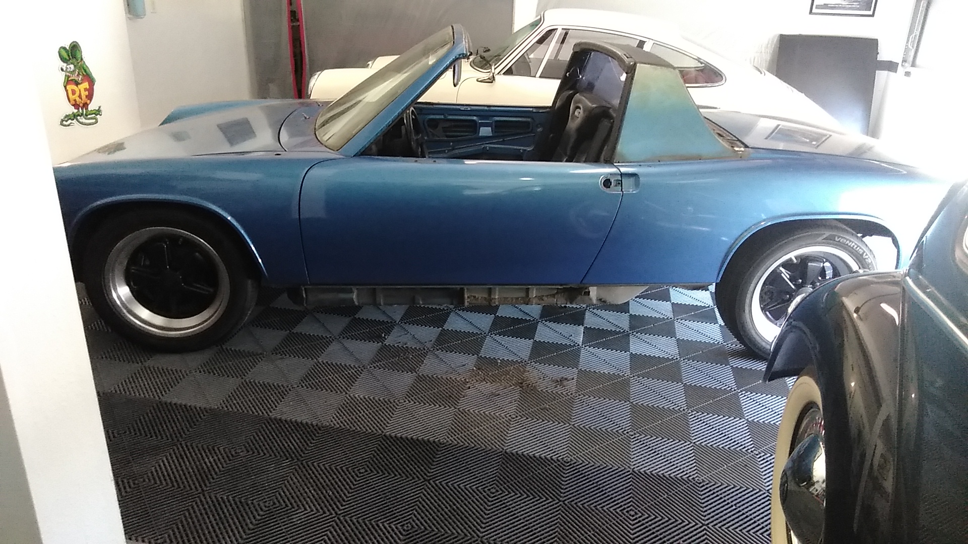

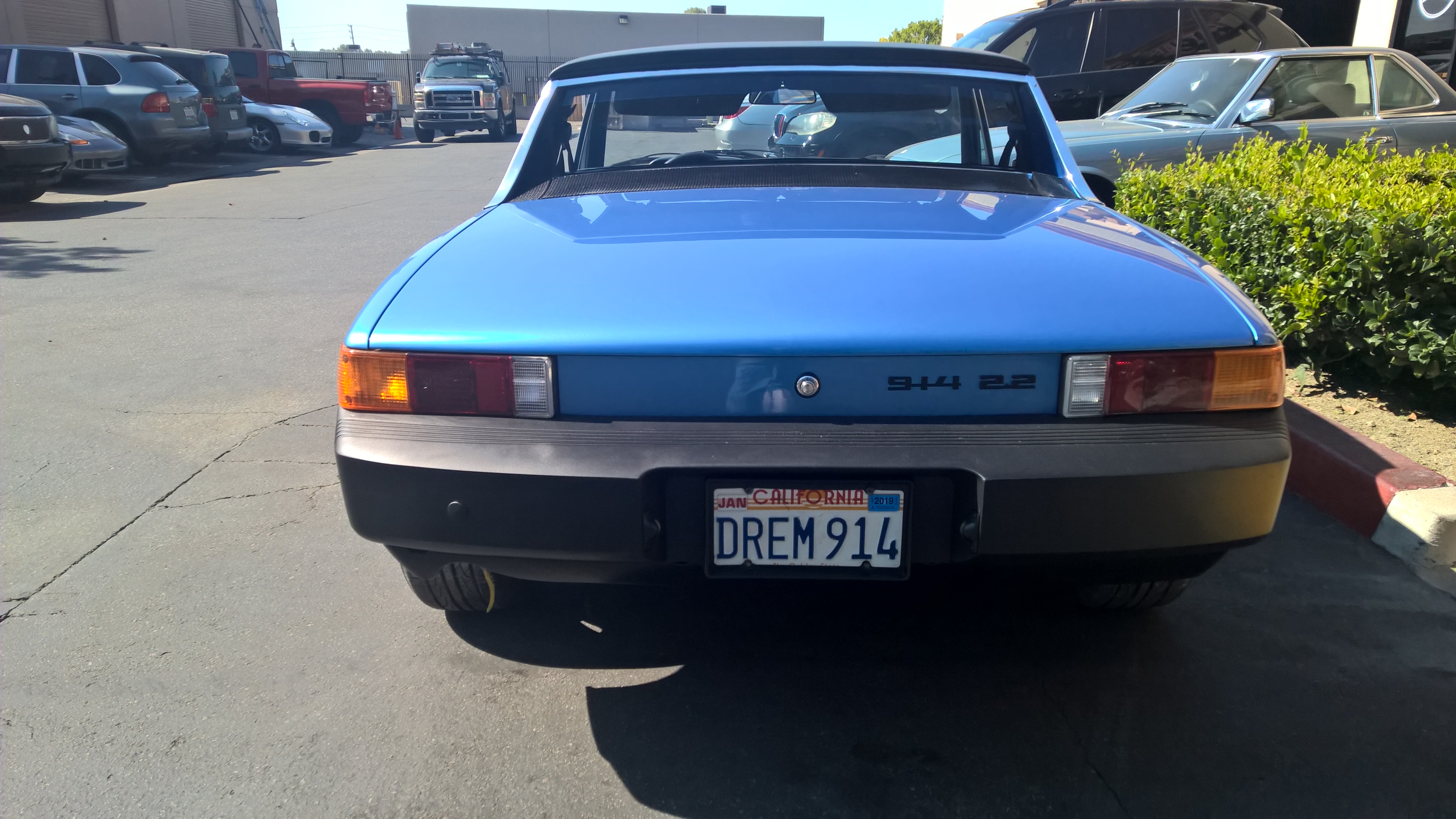

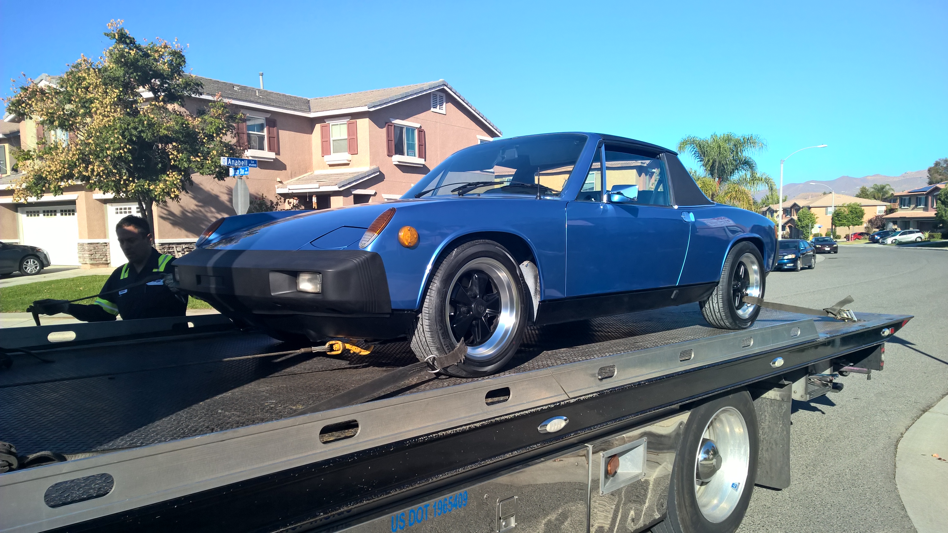

Well its been over 33 years that I have owner this car as the 3rd owner.
I have finally broken down and am getting the surface rust repaired and having the car fully resprayed. I am told it should be ready by Mid August. The car was torn down this week and the good news is that after 33 years of mud and dirt in the rockers that there is no rust. piratenanner.gif Surprising, as the car first came in to the country in Chicago and wound up spending time in San Francisco before I got it.
The rest of the car had a few rust bubbles at the base of the windshield and on the passenger door along with the usual dents and dings that come with keeping a car in a garage with little kids opening the car door next to it or traveling the So Cal freeways and picking up misc. road debris impacts.
The car is going to stay its' original color "Ancona Blue" along with all of the appearance group finishes.
As progress continues I'll continue to update.Thanks for looking.

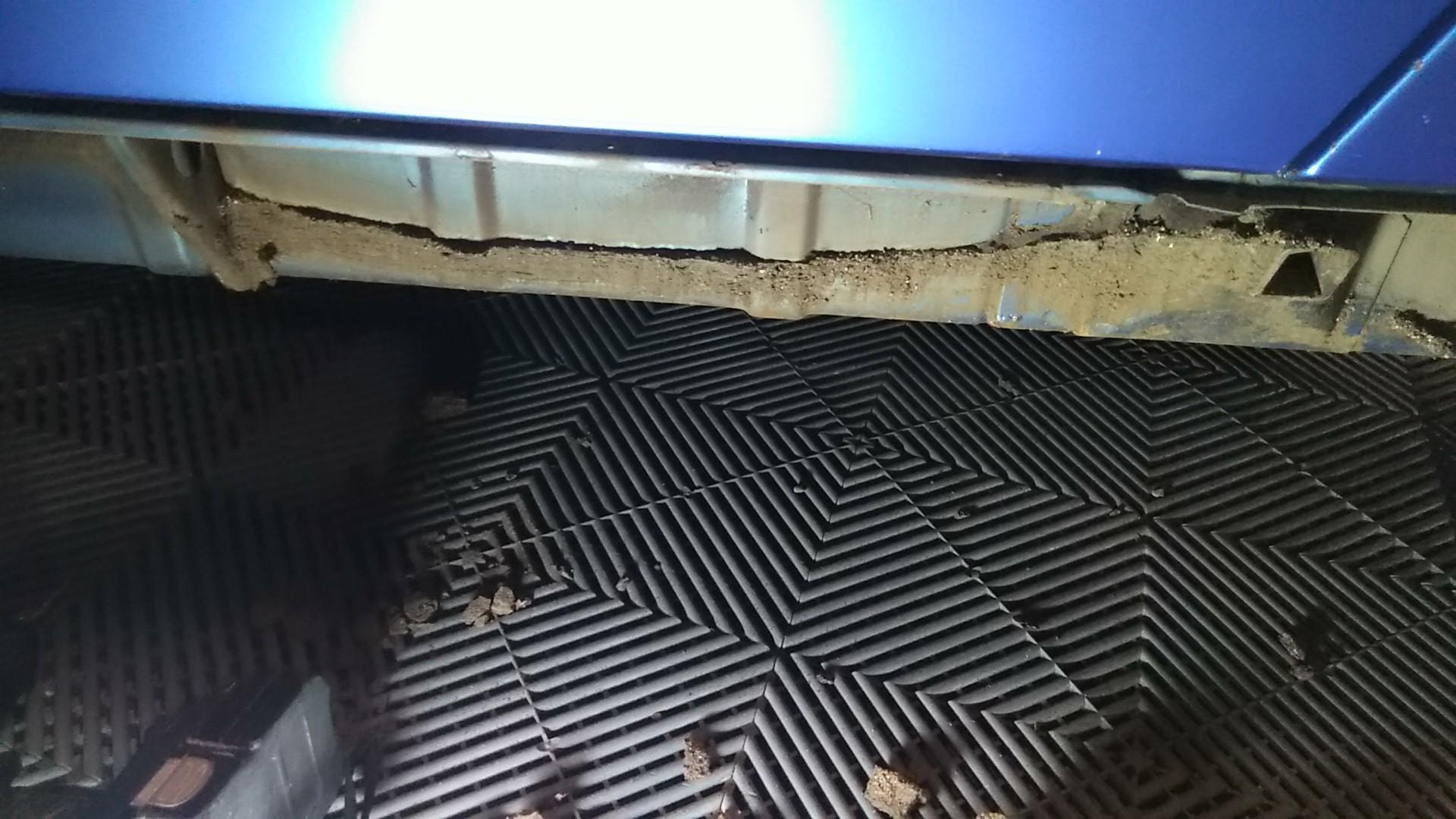

Make sure that your body shop looks into the area behind the doors below the sails and on the fender sides around the taillights for rusting from the factory foam in those spots holding moisture & rusting from the inside out. If they find any, then have them cut out the rusted sheet metal & the foam there so it won't reoccur, & then patch in 19 GA sheet metal to match the original body panels (or get the RD patch panels.
Same thing around the windshield, cowl-to-fender seams with the rubber gasket on top, bottoms of the doors under the outer door seals, up under the steering rack L & R where the MC &/or windshield washer bottle/hoses can leak down & rust trough the bottom floor of that well - which is where your steering rack attaches to the unibody, & in the hell hole & lower lip/shelf in the engine bay - especially behind the sound/heat pad.
I could go on & on, but you can use Jeff Bowlsby's checklist too - as if you're buying it all over again & doing a deep PPIn...
http://bowlsby.net/914/Classic/zTN_Gen_914CAF.pdf
You &/or they should do a thorough look through & check out all of the nooks & crannies for any rust evidence, as you did behind the rocker covers.

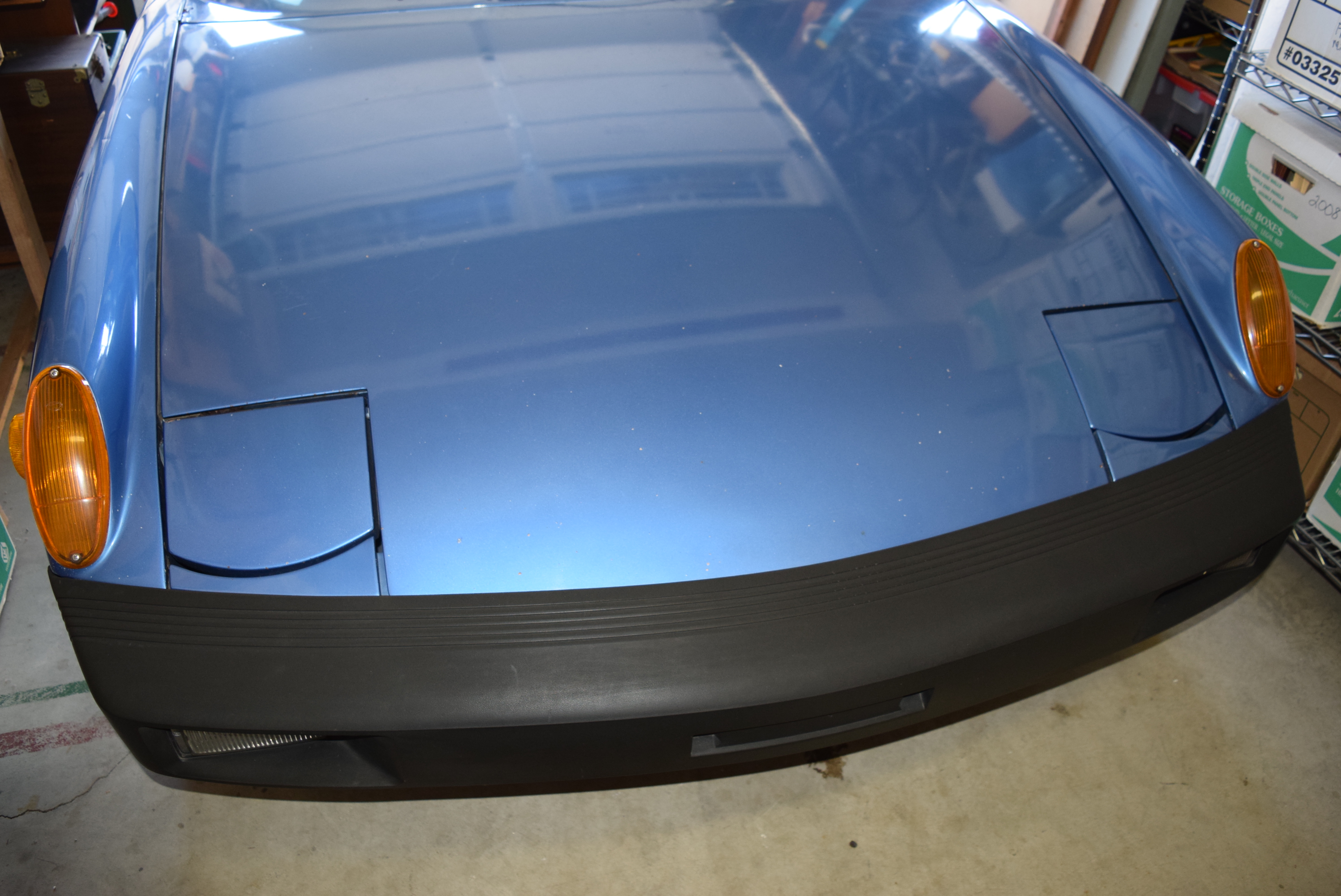

The bumbers are staying, as they are in perfect shape. Besides, it is a '75 and I dont have those extra warts on the bumbers.
As far as removing the side warts, I am not sure. I already have had the LED turn signals from Spoke and they work great.

Thanks Tom. we are doing that now, but by all acoounts I have some minor surface rust in the trunk back by the lights, under the spare tire and at fender-to-cowl seam on the passenger side and that is it. The car has been garaged since I have owned it and i think that has helped alot. Everything else is good. The painter just finshed up another 914 (his own) a few months ago and is well aware of the other spots that can be problem areas. Even the hell hole is good. Dirty, but good.

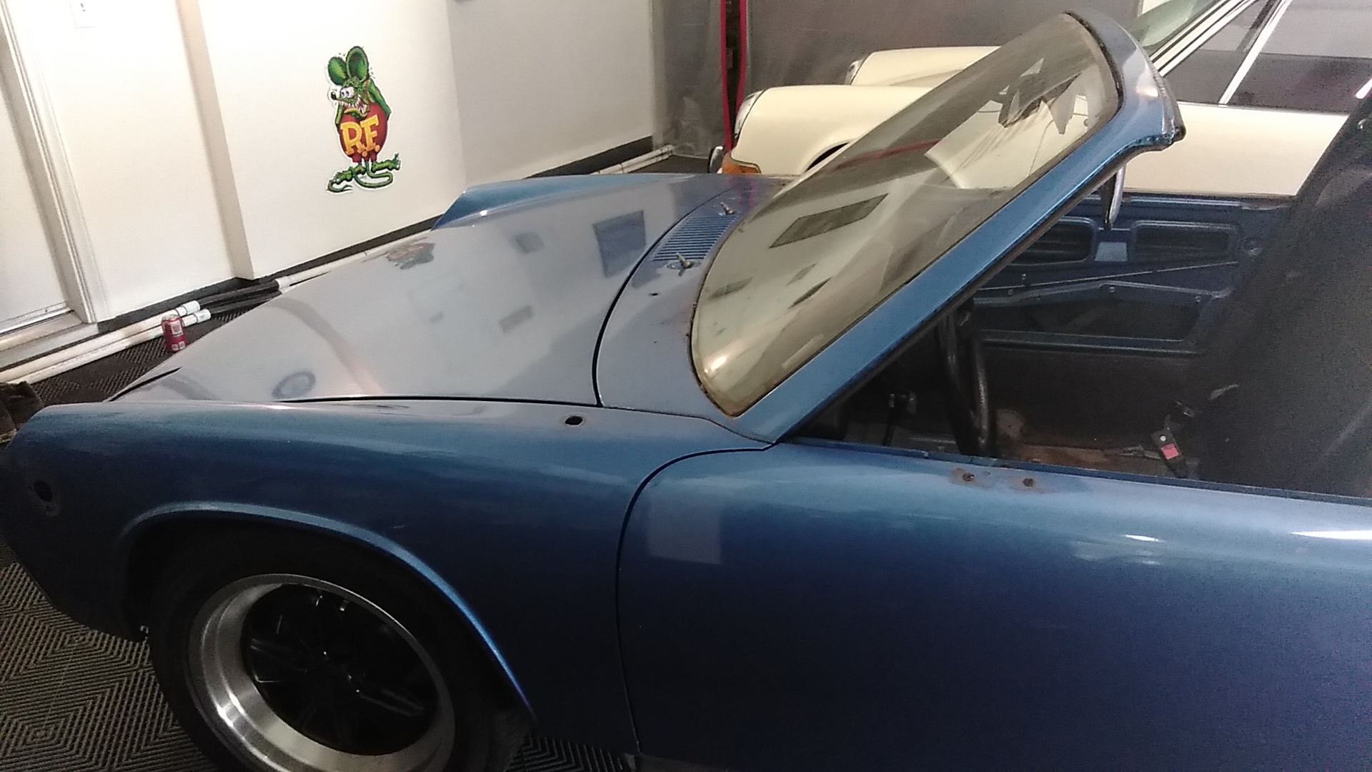

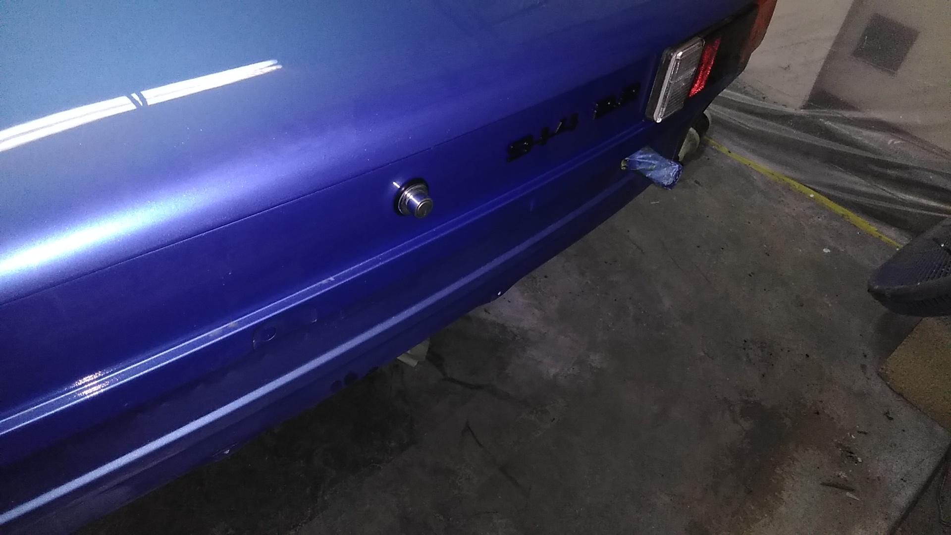

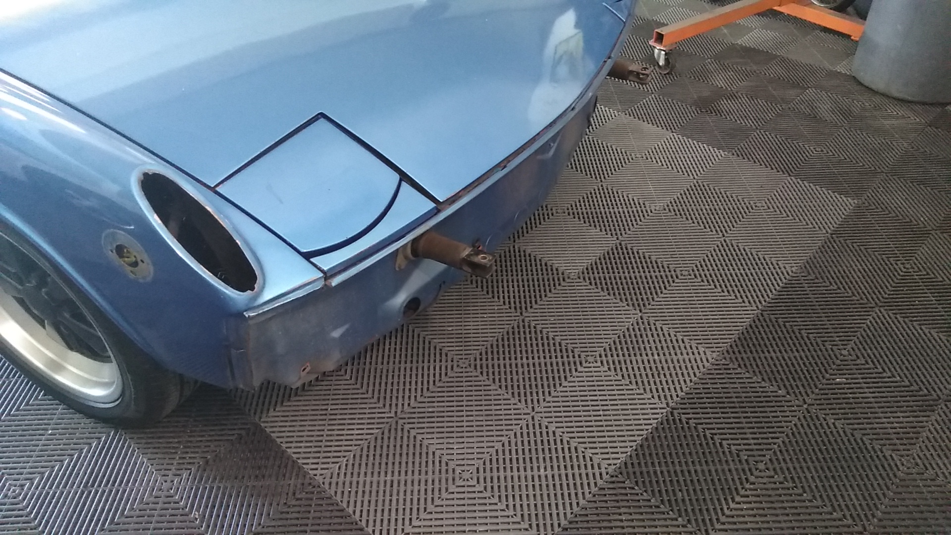

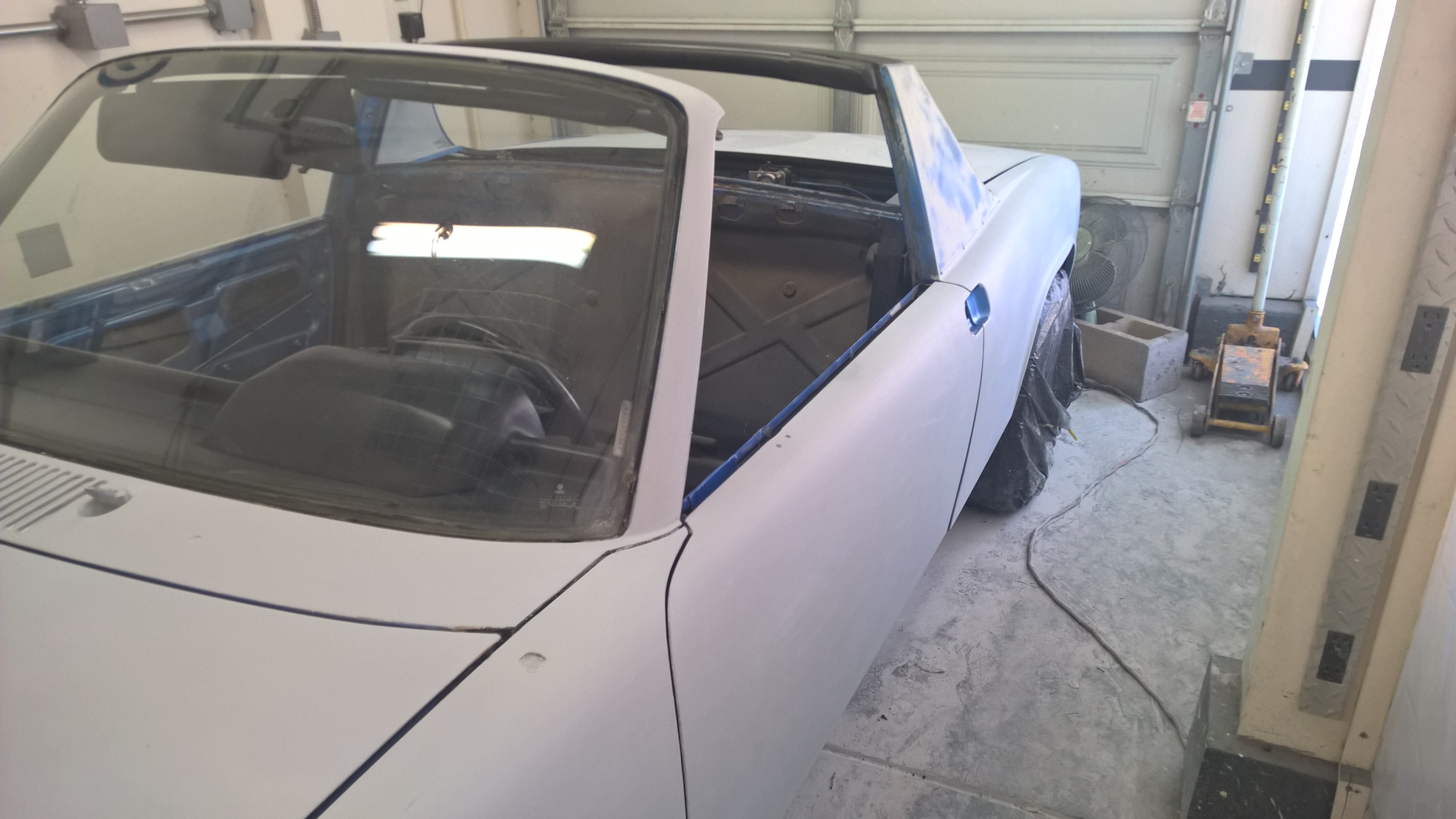

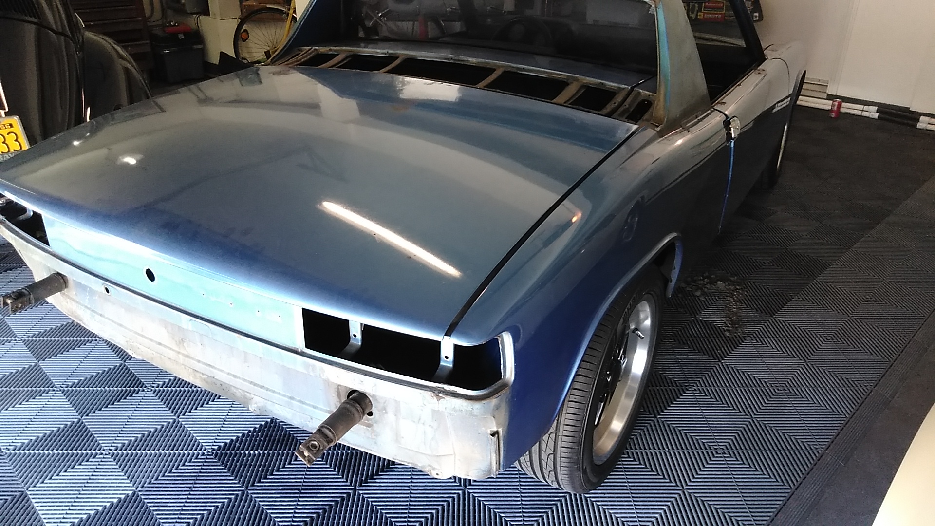

Well the car is not blue anymore and the rust is gone. welder.gif Thankfully, all has been surface and nothing through the metal. Now in primer and getting blocked in the coming week and ready for paint in about two.
drem914

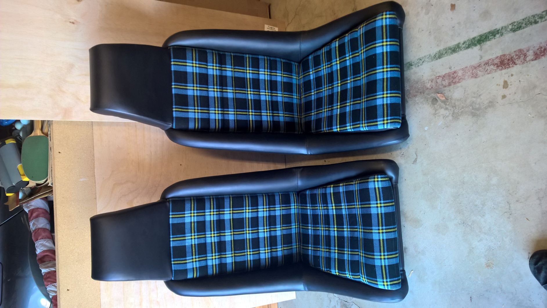

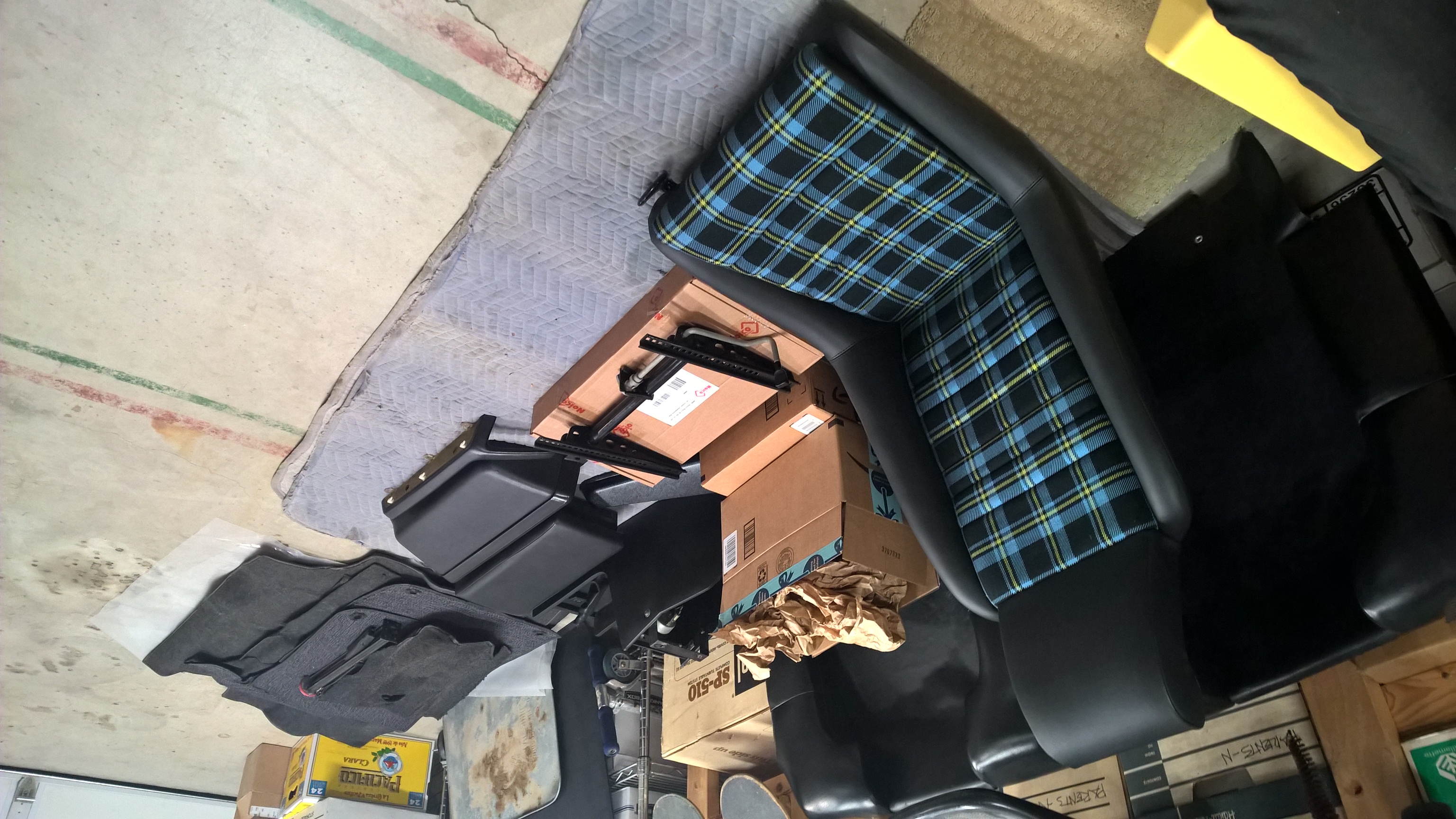

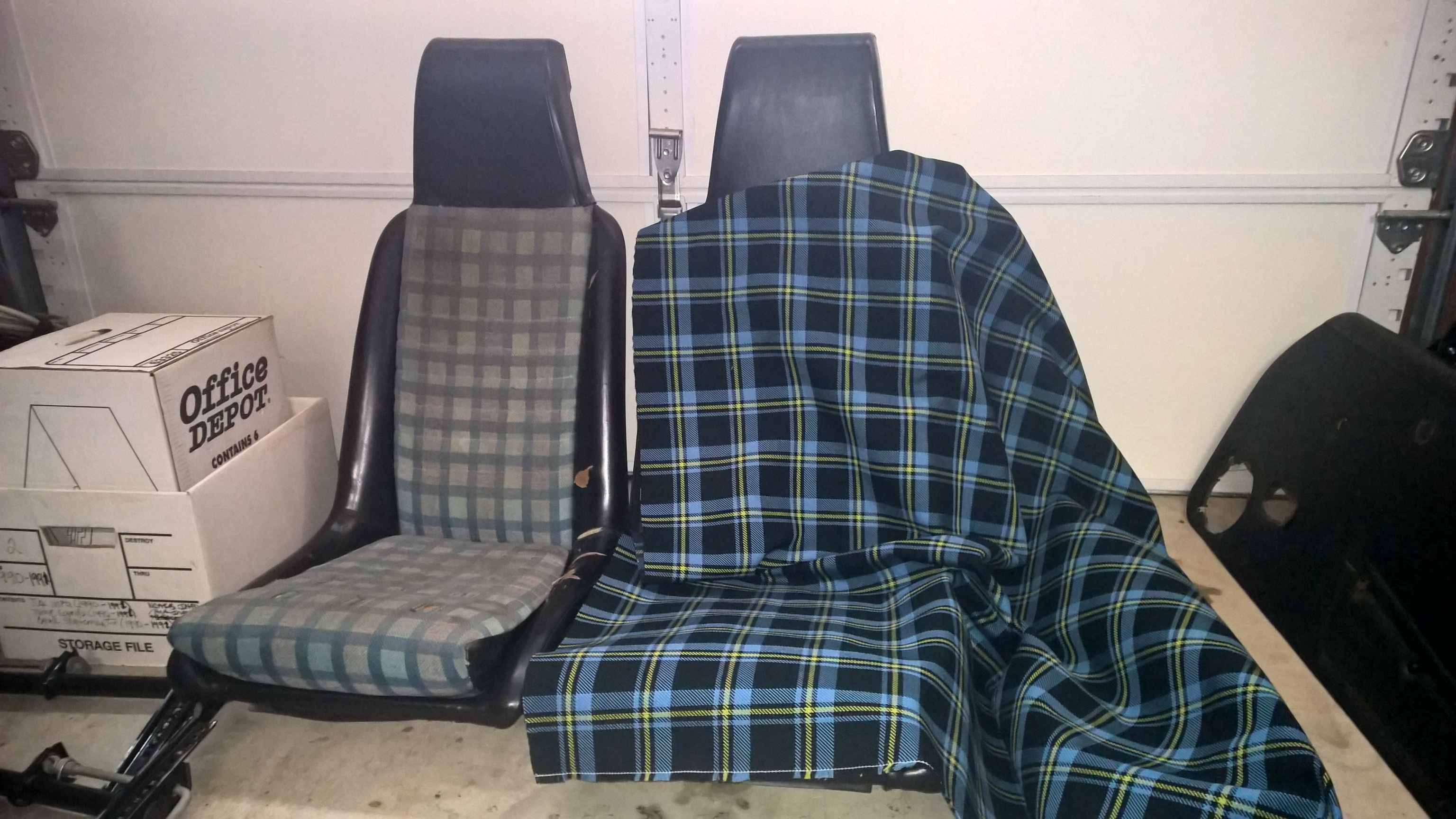

While that is going on, I now need to get the seats off for a recover. the fabric on the left is what came on it from the previous owner. A recover of the center panel. Definably not factory original, so I am going back to one of the optional factory plaids. For'75 one of the colors that would have originally been on the car is Matisse Blue #80.
drem914

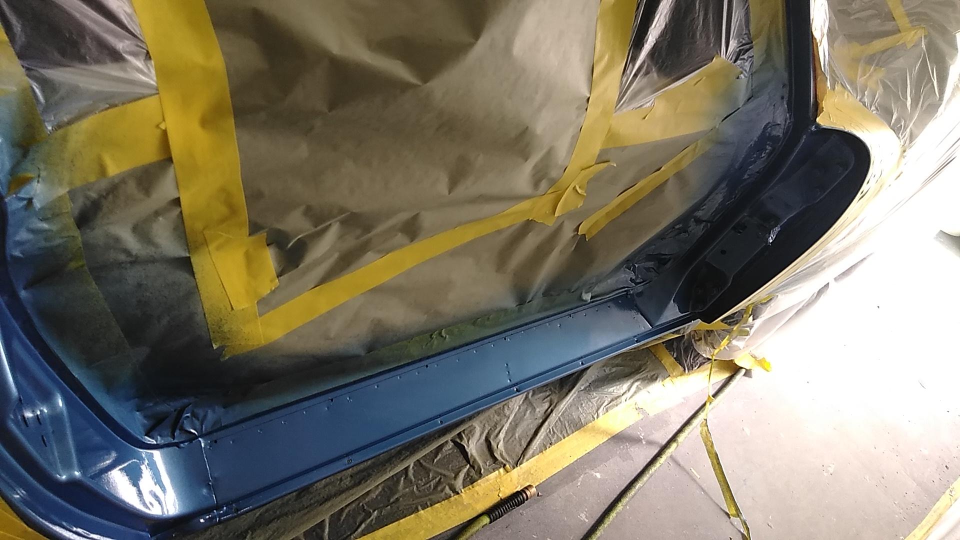

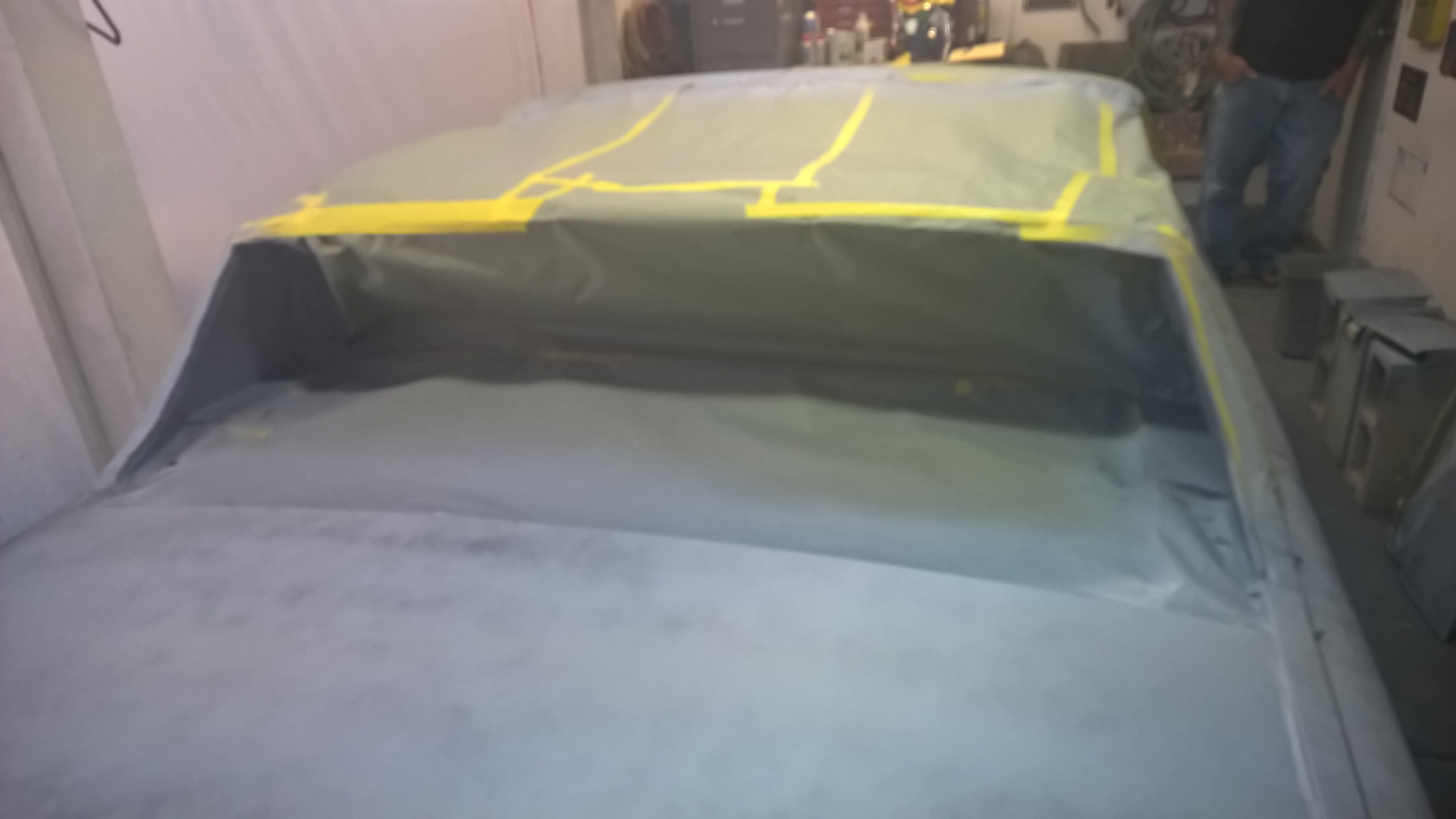

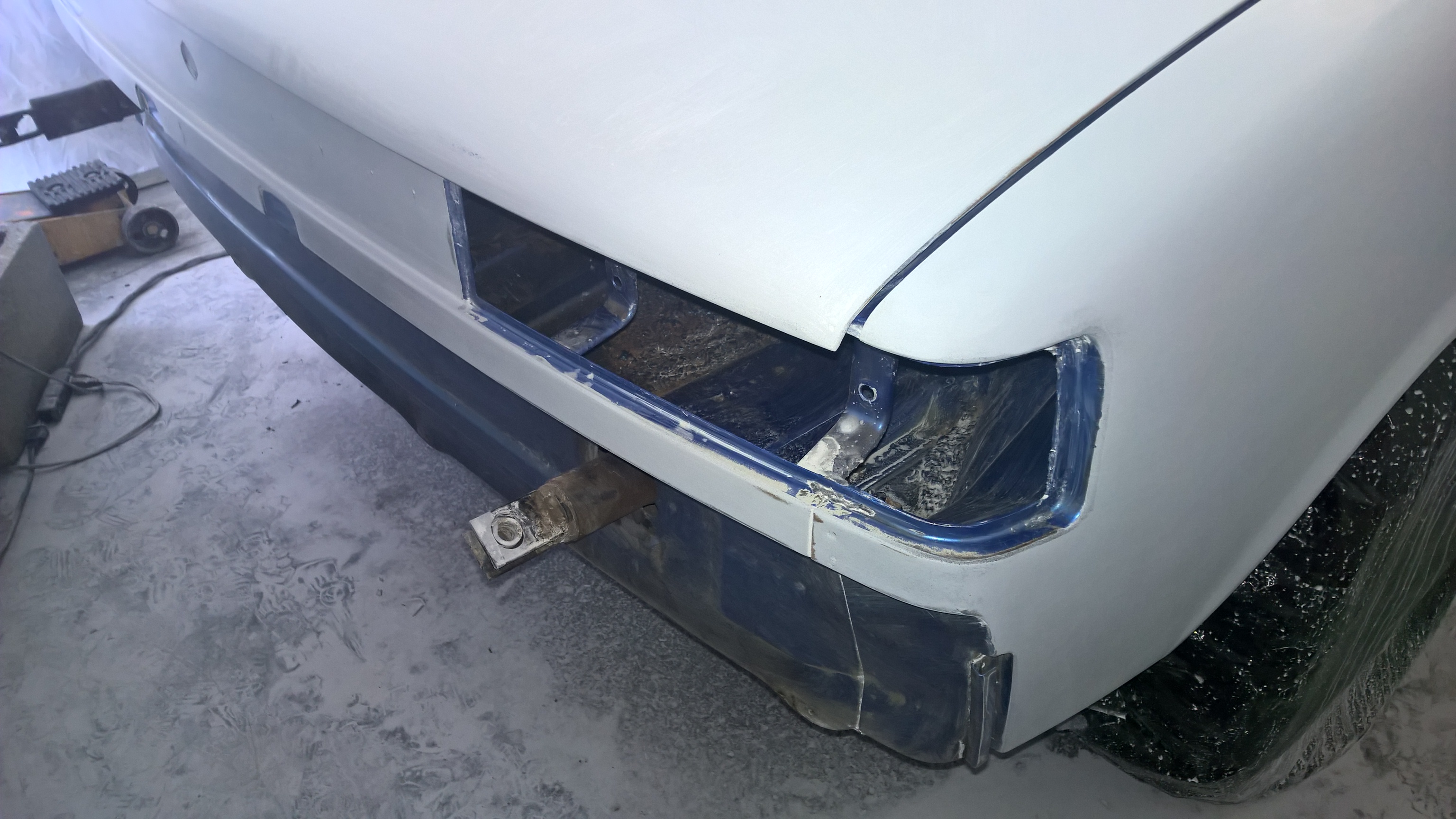

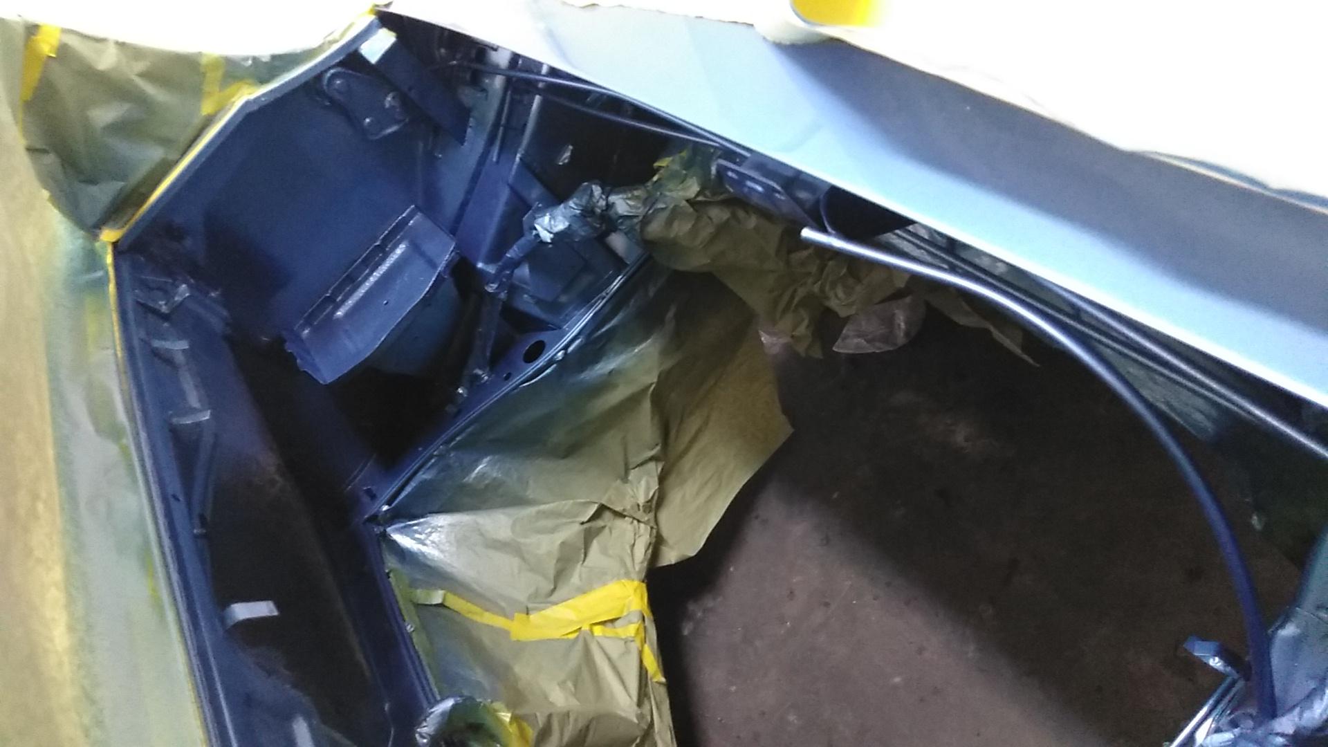

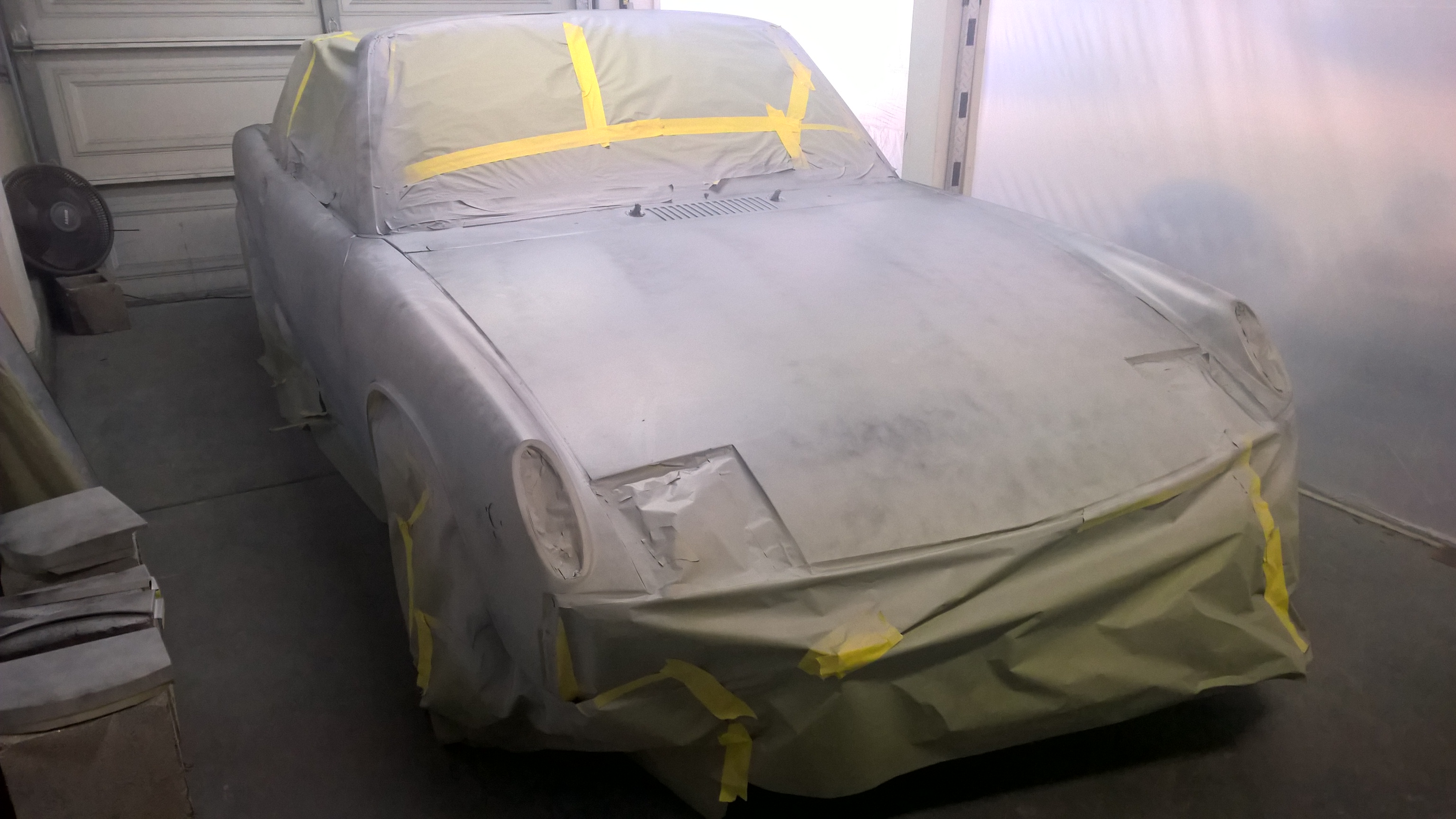

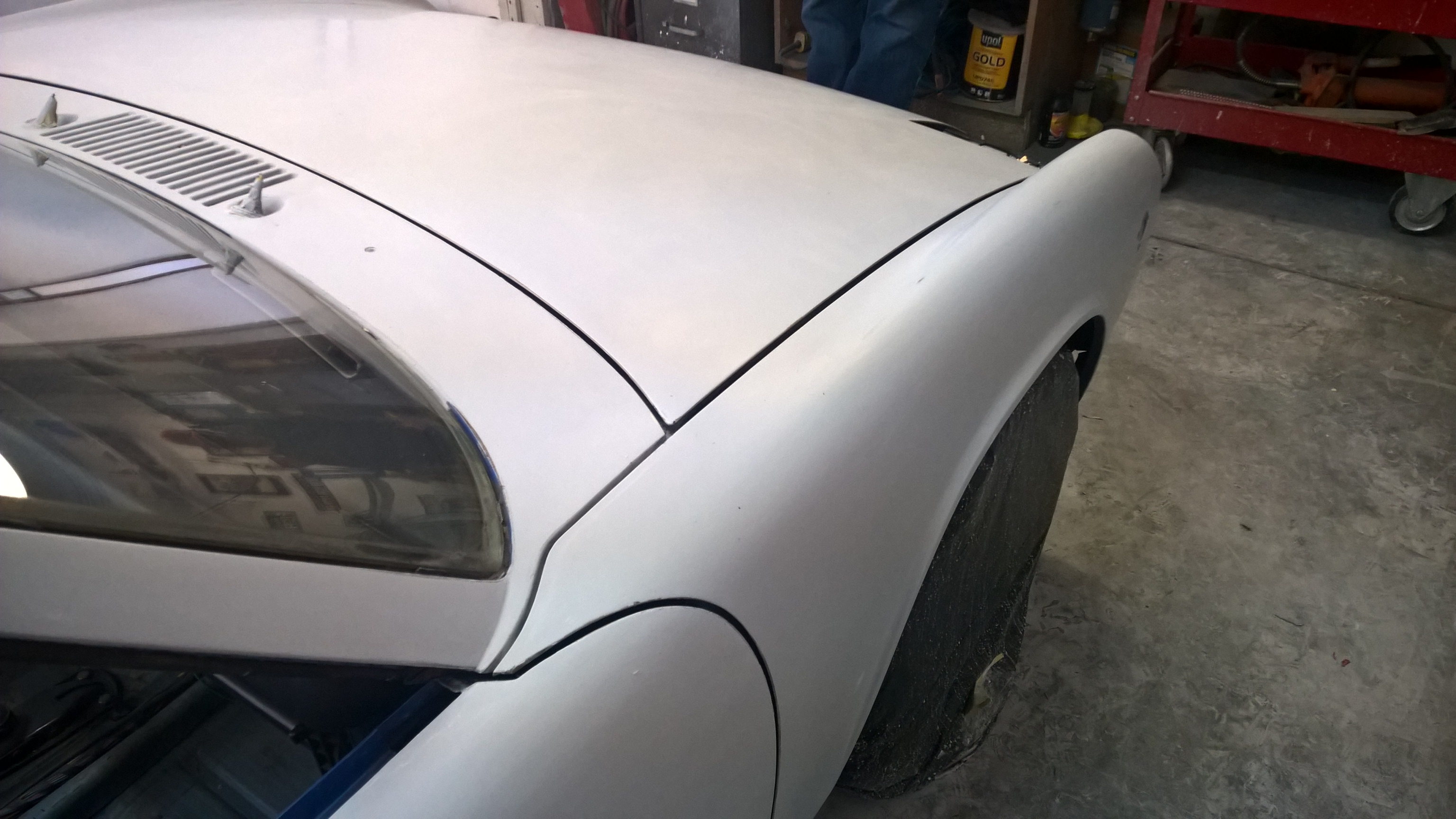

Stopped by Ron's today to see how he is doing and to do a primer check before heading off to the paint booth in about a week or two. Getting closer and closer to a new 2-stage painting of Ancona Blue. He is doing a great job. Almost all of the little imperfection are gone on the exterior of the body. I should hopefully have it back in my garage in about 6 weeks, were it will sit until I reinstall the interior. Time to get my butt in gear.
Here are some more shots of the car now that is has been wet sanded with 500 grit.
Still some more work to be done in spots like the rear tail light and then on to the trunks and engine compartment.

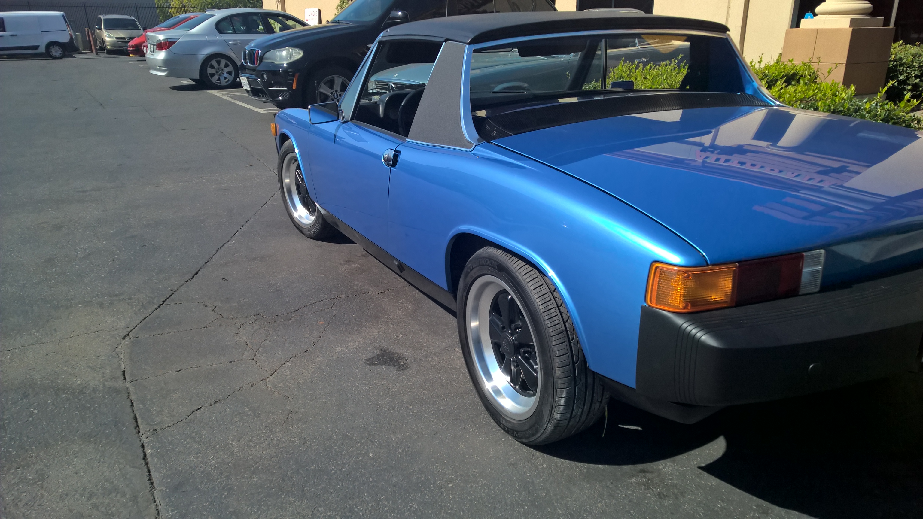

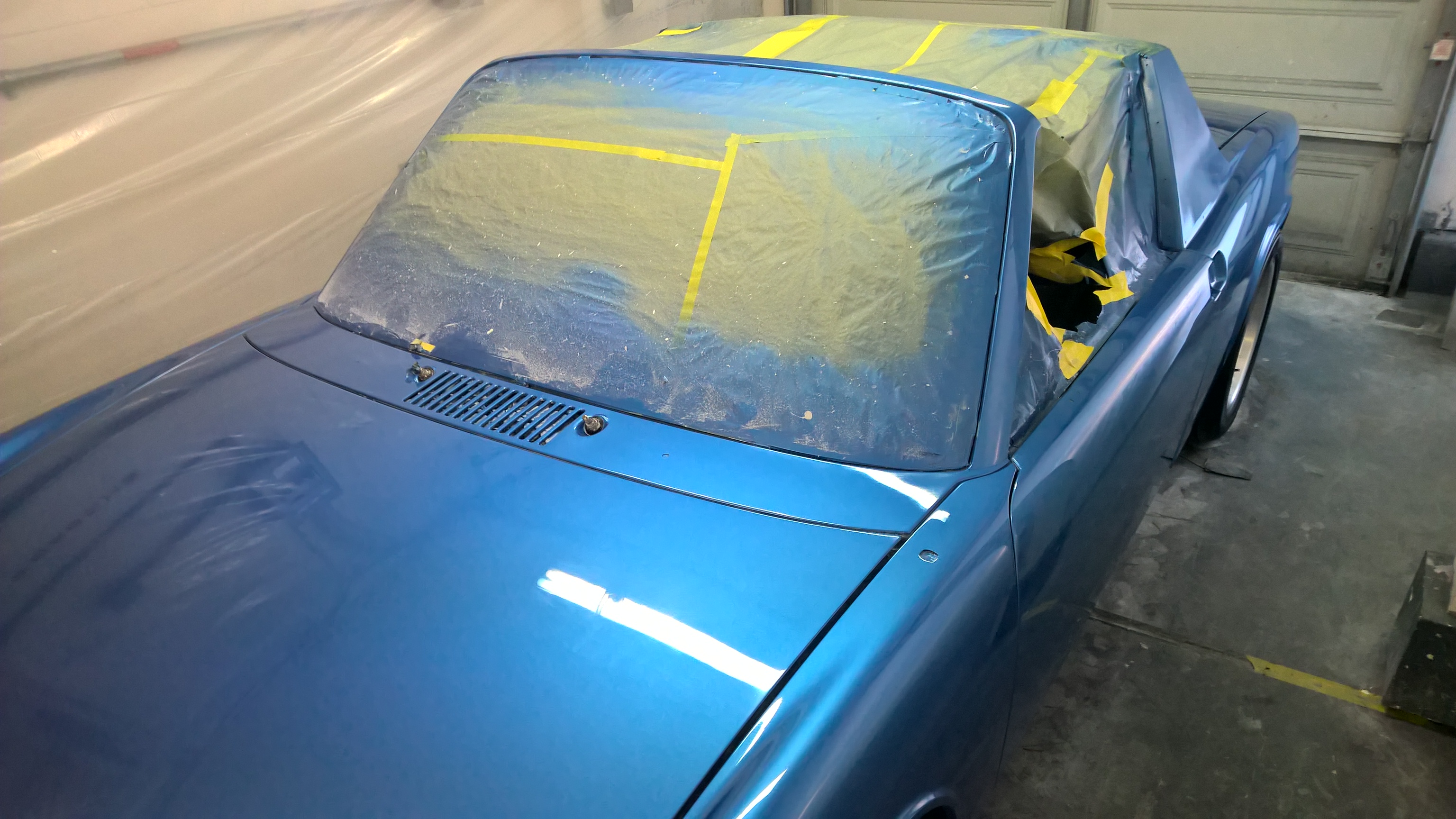

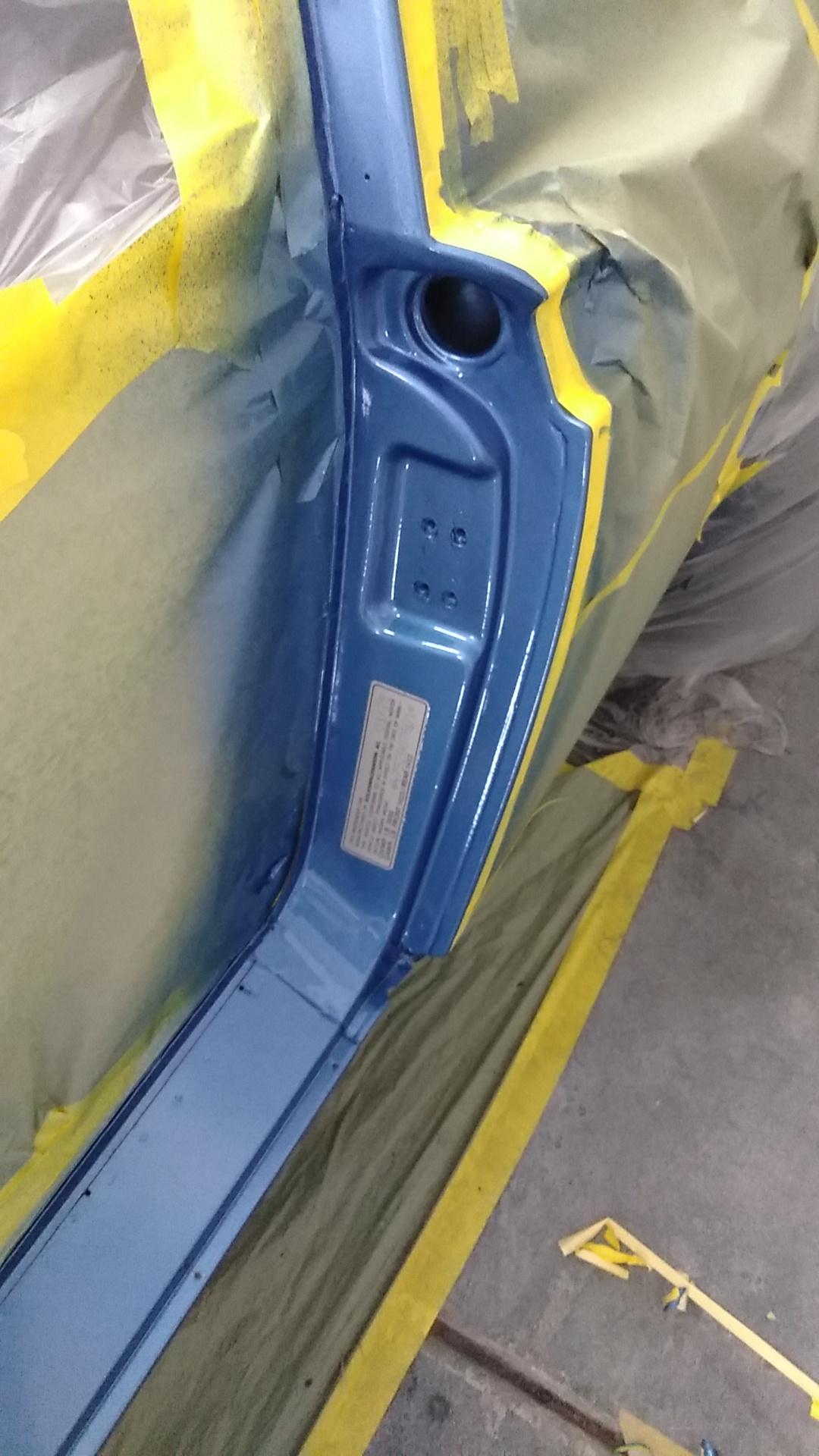

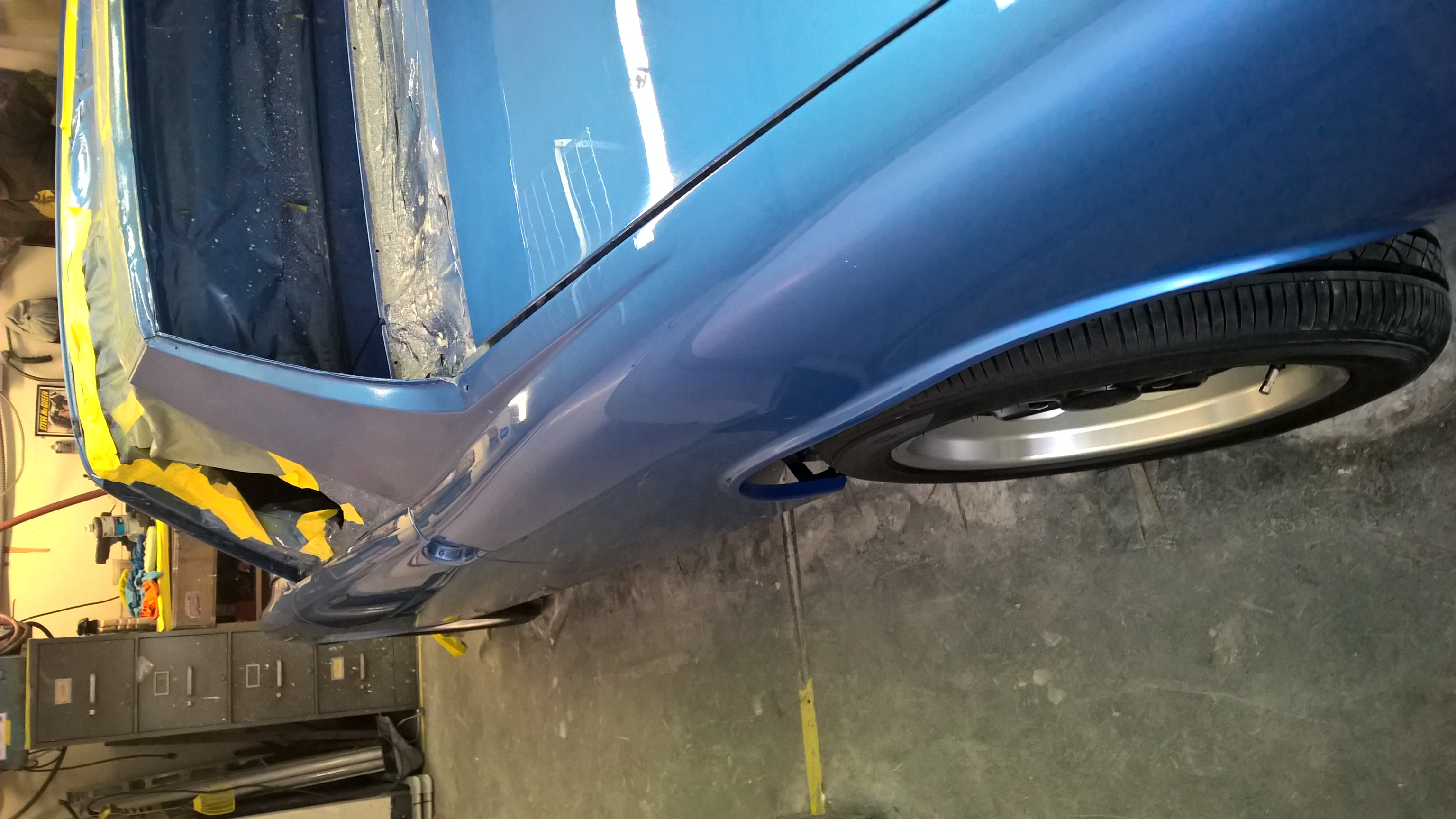

Well it has been a while since I had an update on the paint, but got to see it today after the first full round of color sand. here are some shots of the work to date.
drem914
It is finally getting closer. A couple weeks from now it will be back, getting the engine back in and working on the interior.
drem914

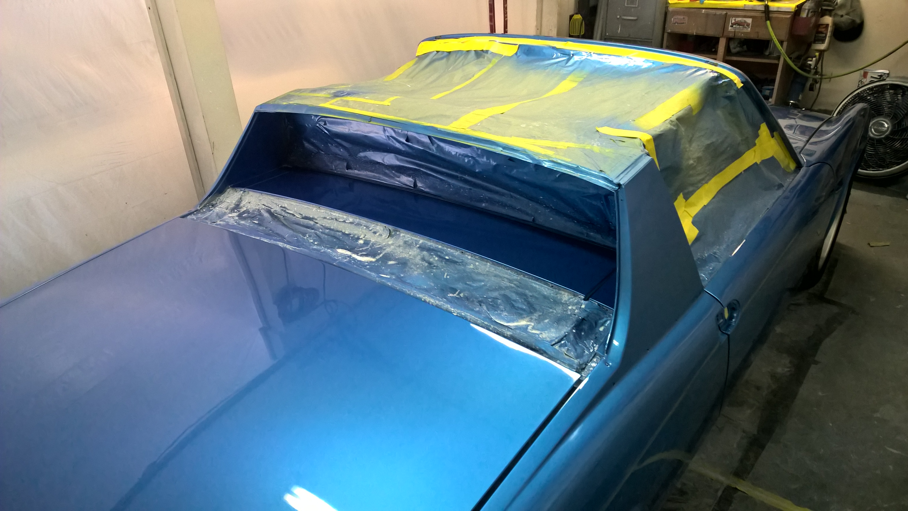

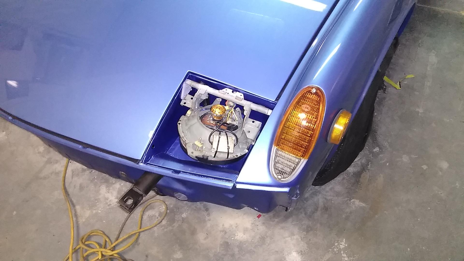

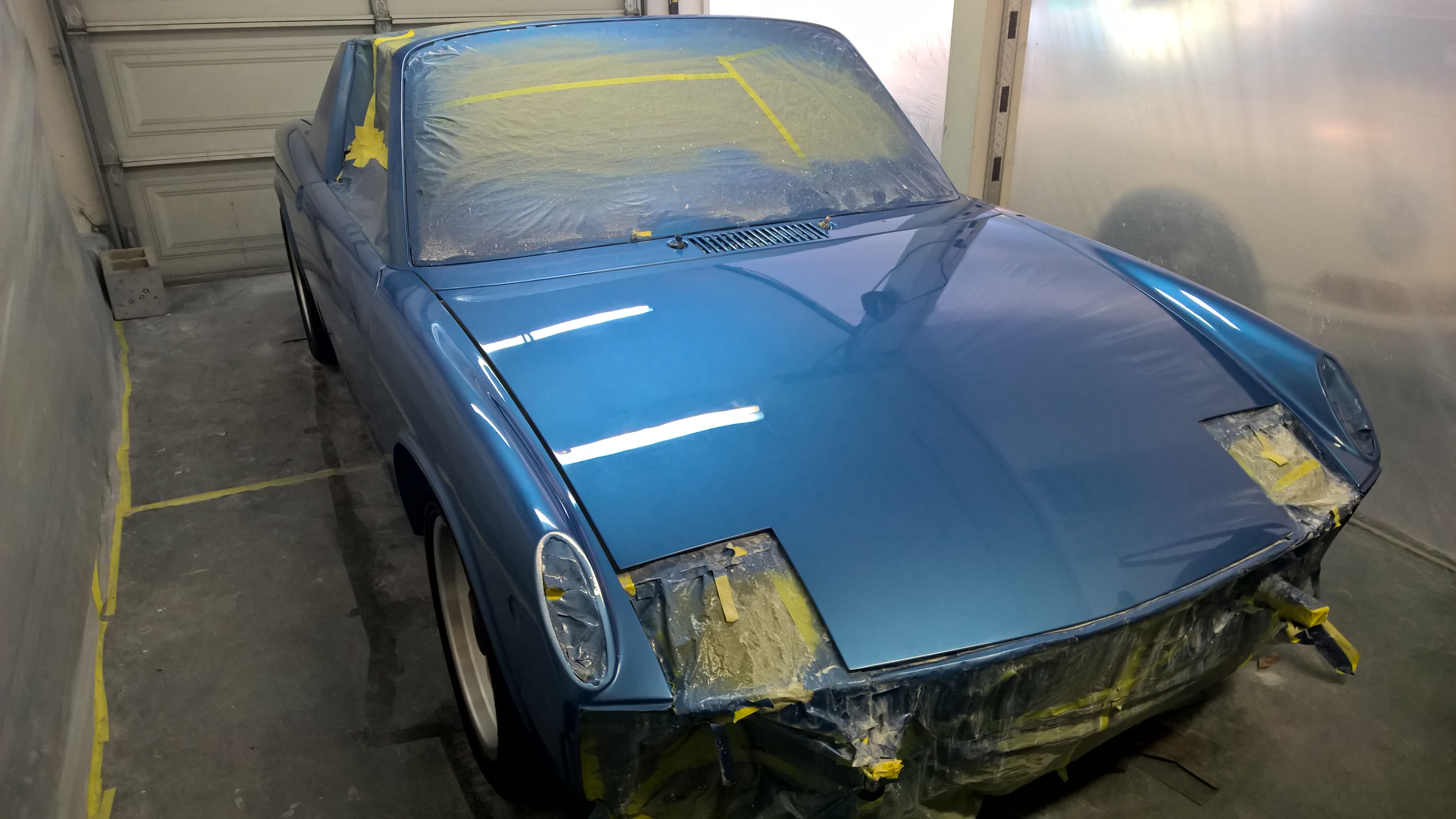

Got a nice message this afternoon from the painter in the form of some pictures. A great way to end the weekend. Getting closer to being able to drive again. Click to view attachment
porschetub
Wow nice colour wub.gif .
drem914
QUOTE(porschetub @ Sep 16 2018, 05:30 PM) *
Thanks. It's an original color respary in Ancona Blue Metallic. Ron has been doing a great job on the car. i could not have asked for more. I will have it back in a couple weeks to put the engine and and interior back in. piratenanner.gif

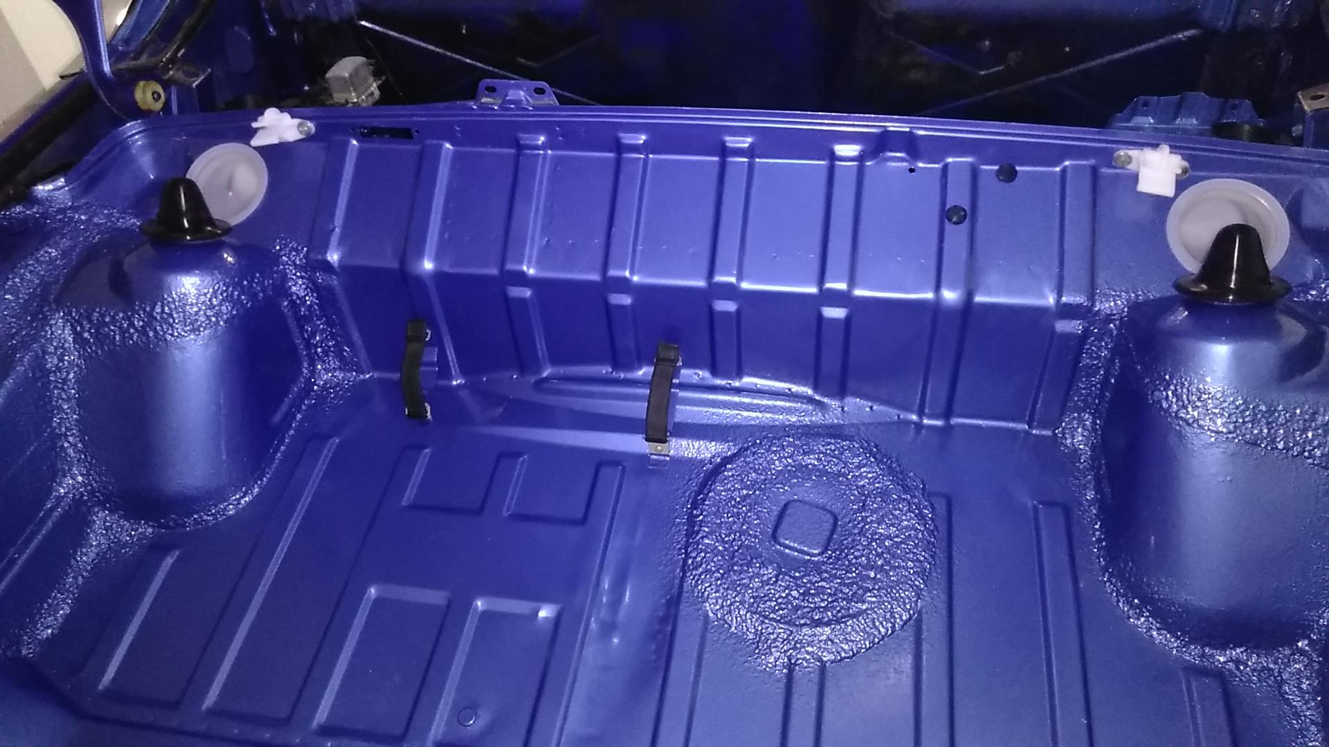

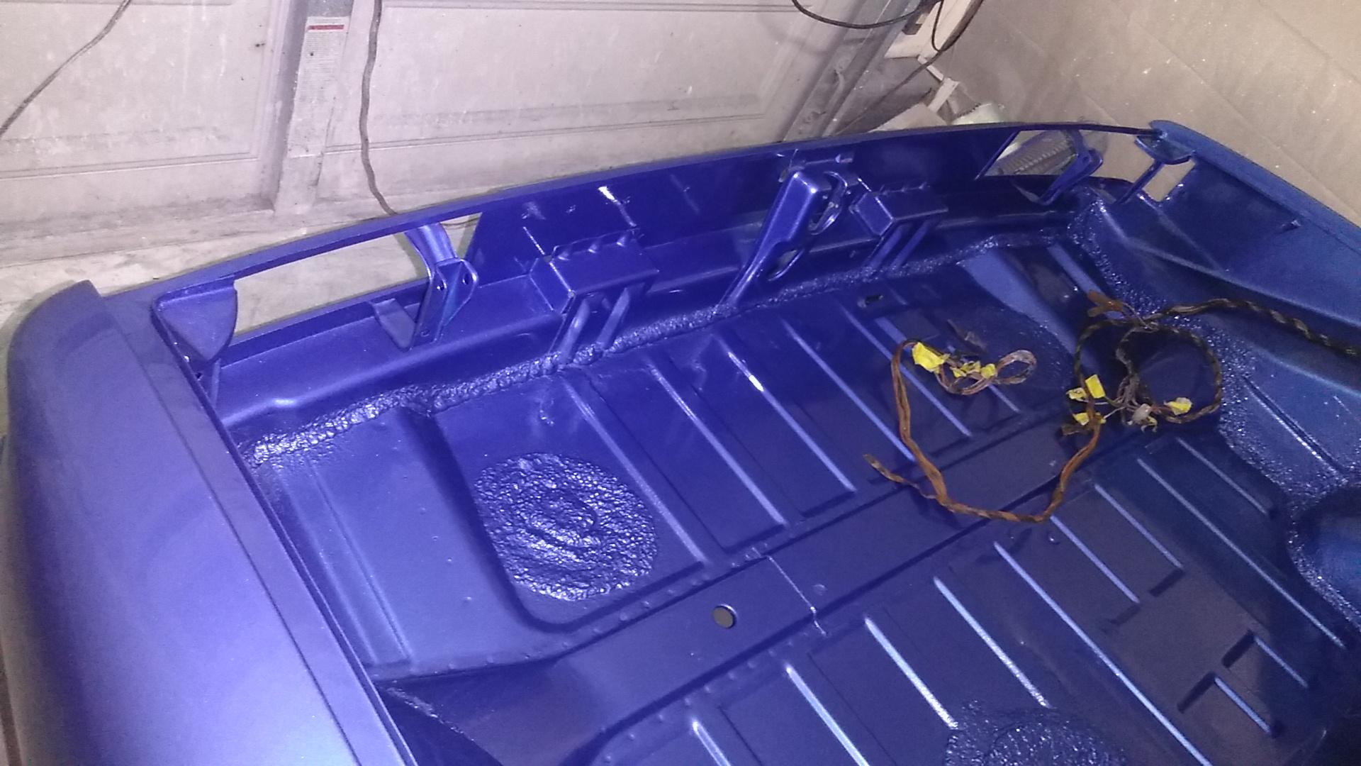

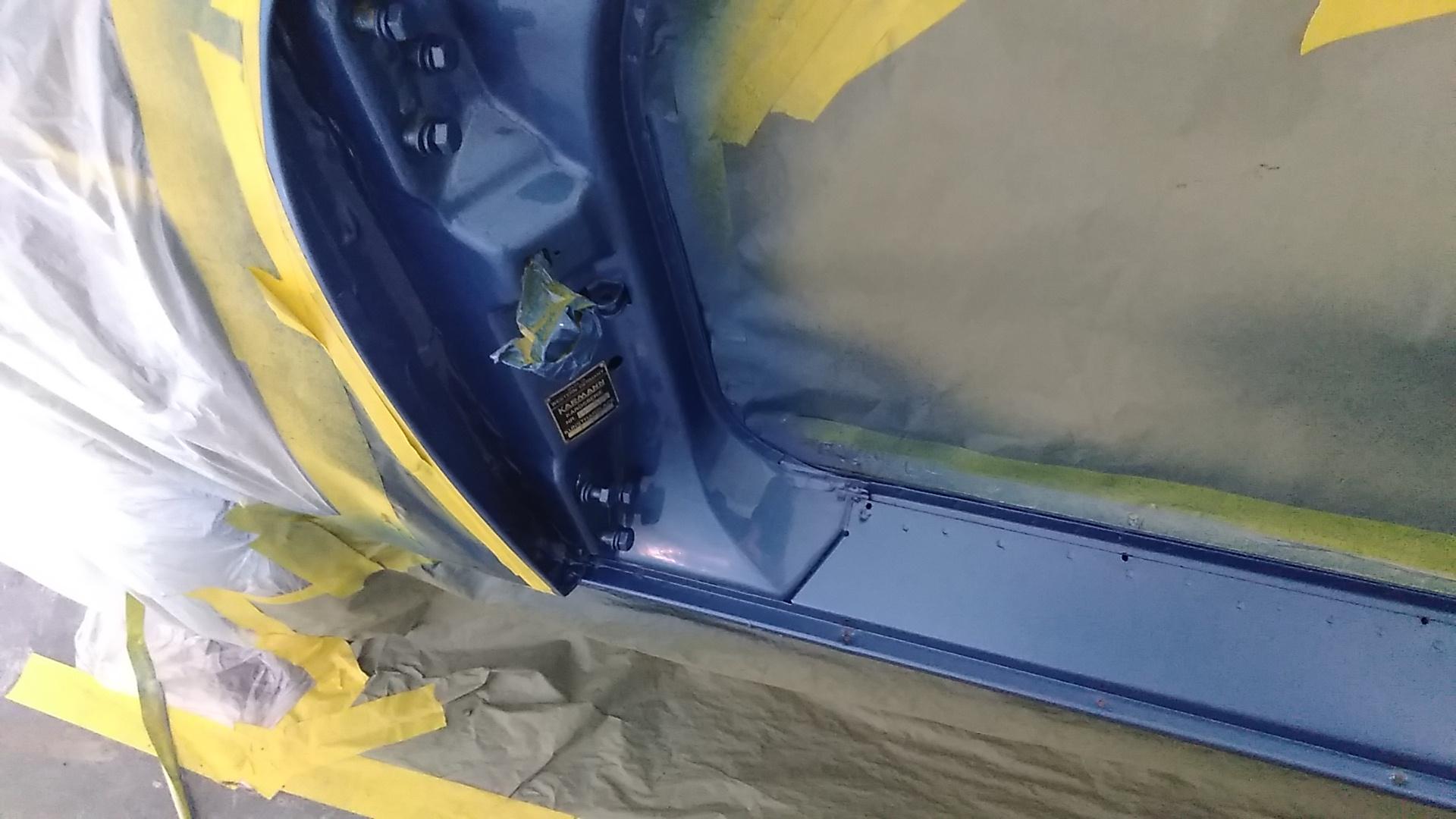

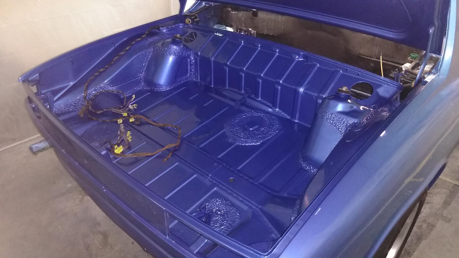

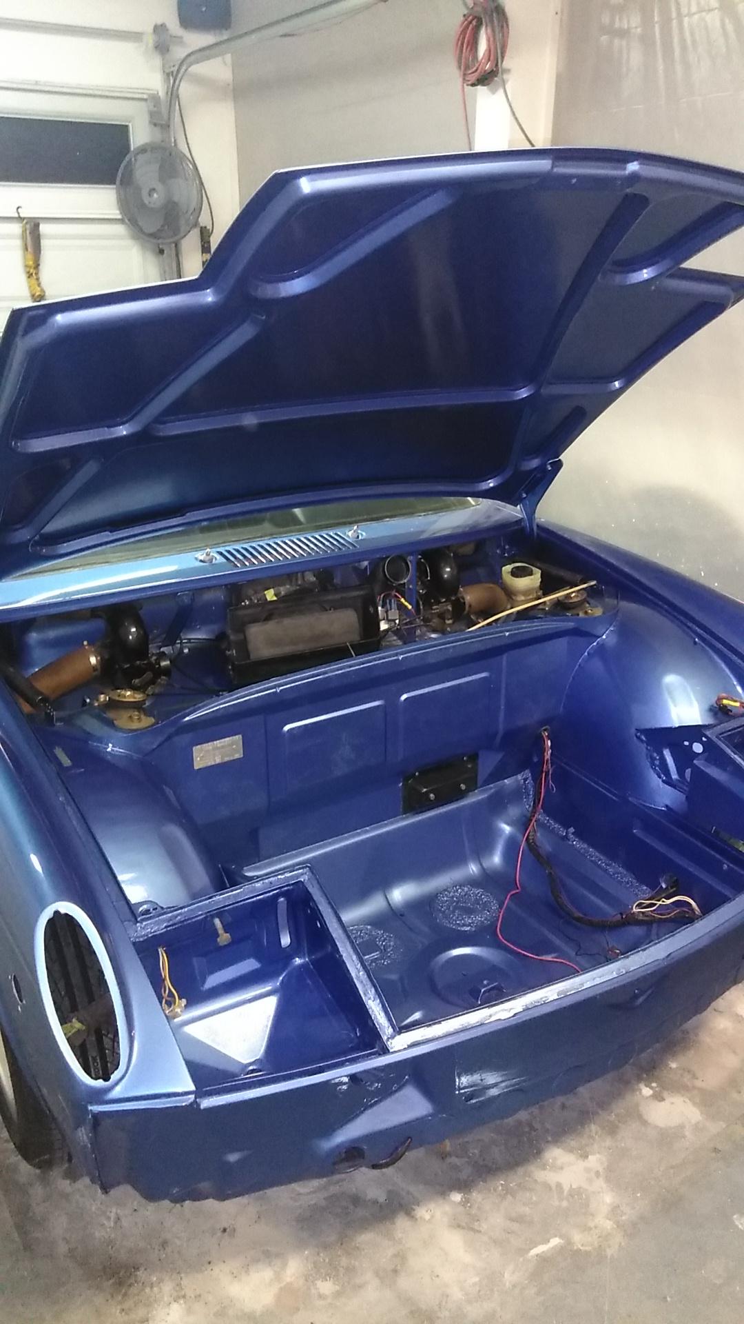

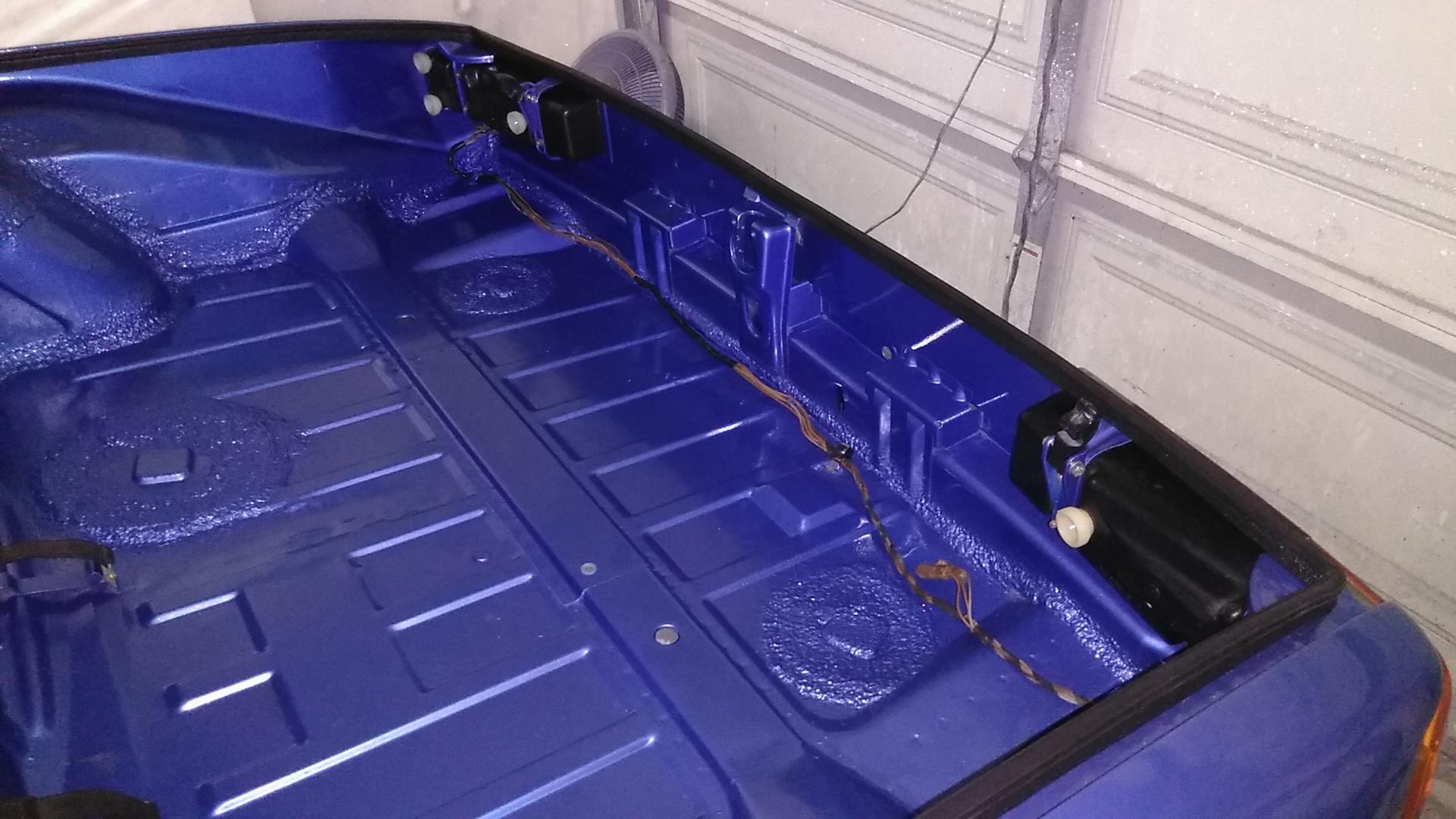

Latest update on progress. Getting closer to re-assebmbly.
Door sills are finally done
Sills after plugging Zeibart treatment holes.
Cleaned up battery tray and engine compartment
What is a amazing is how the color changes in the photo. The engine compartment is the same color as the rear trunk lid. I know because I have seen it.

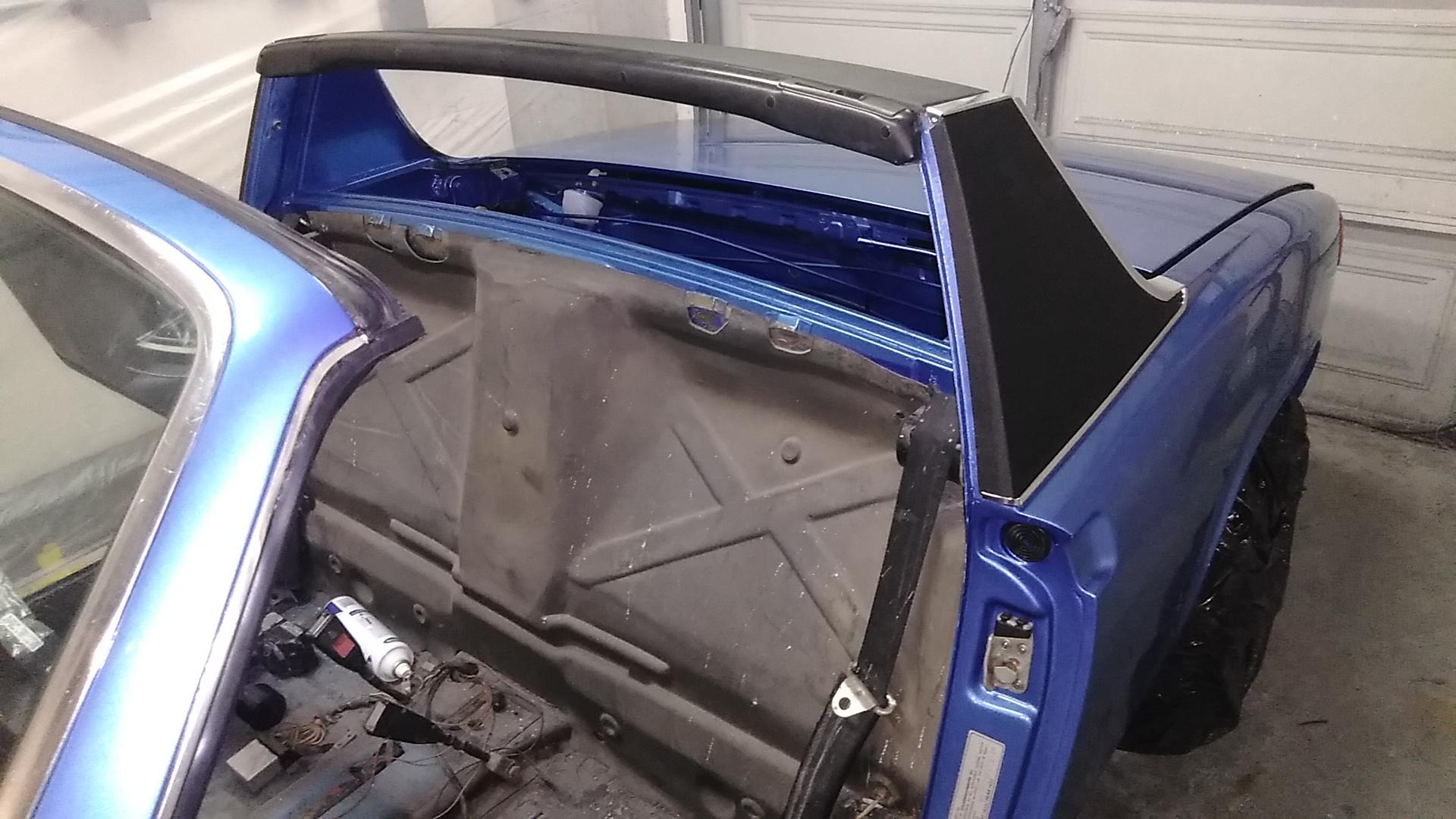

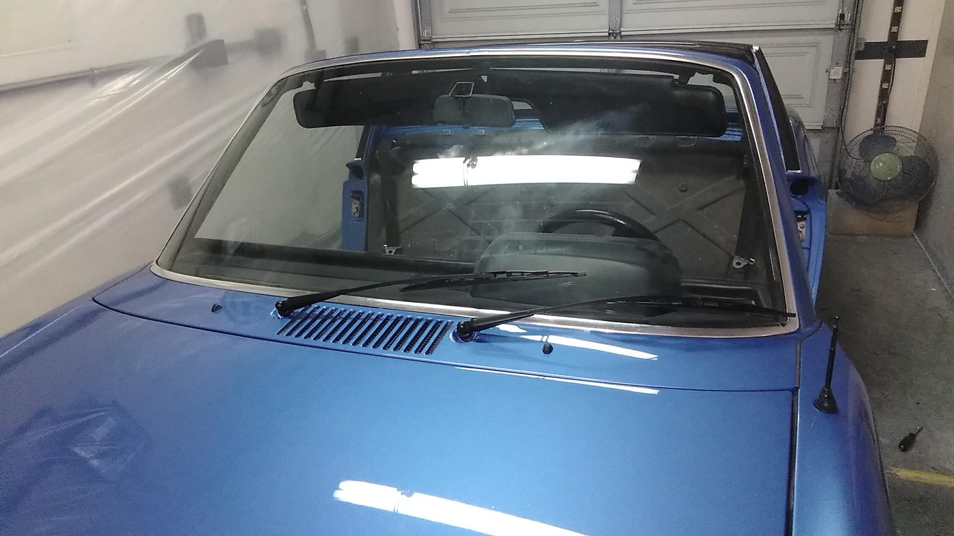

Some update photos as the re-assembly has begun.
Finally get to put all those boxes from 914Rubber to use
914Rubber new parts to freshen up the old rubber and plastic
original windshield chrome back in
New sail and targa vinyl
drem914

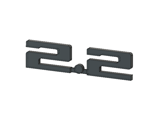

Even have my new 2.2 emblem attached (provided by 914world member Mueller).

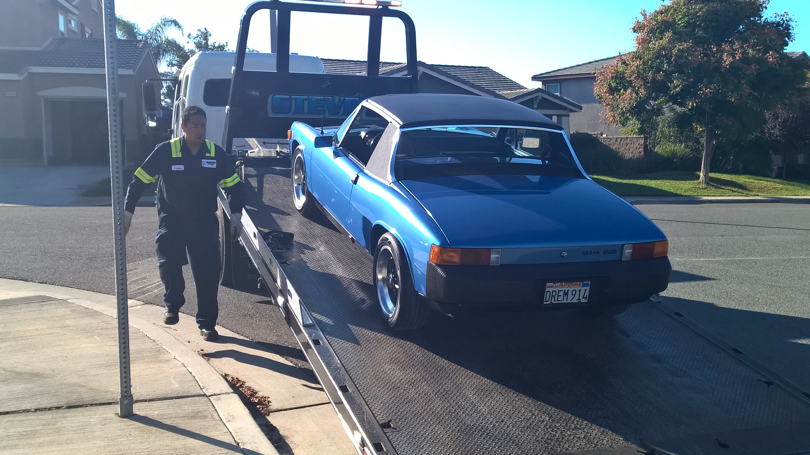

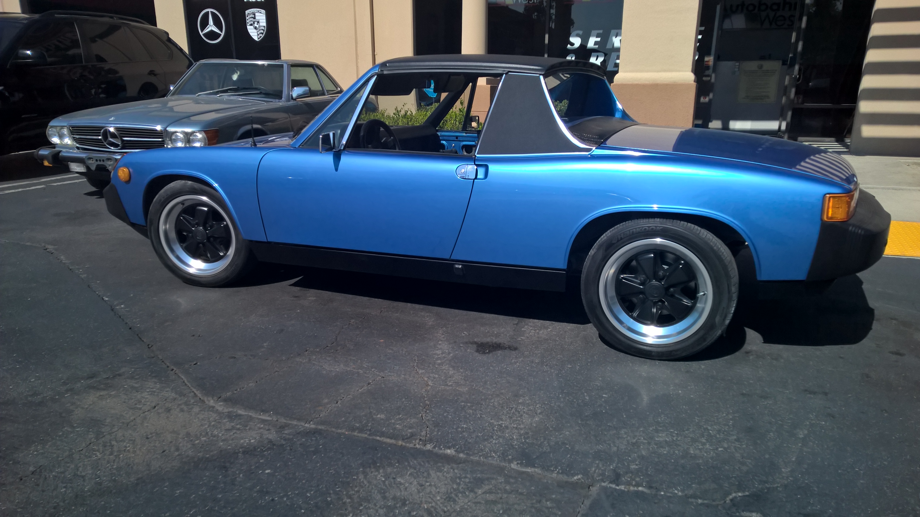

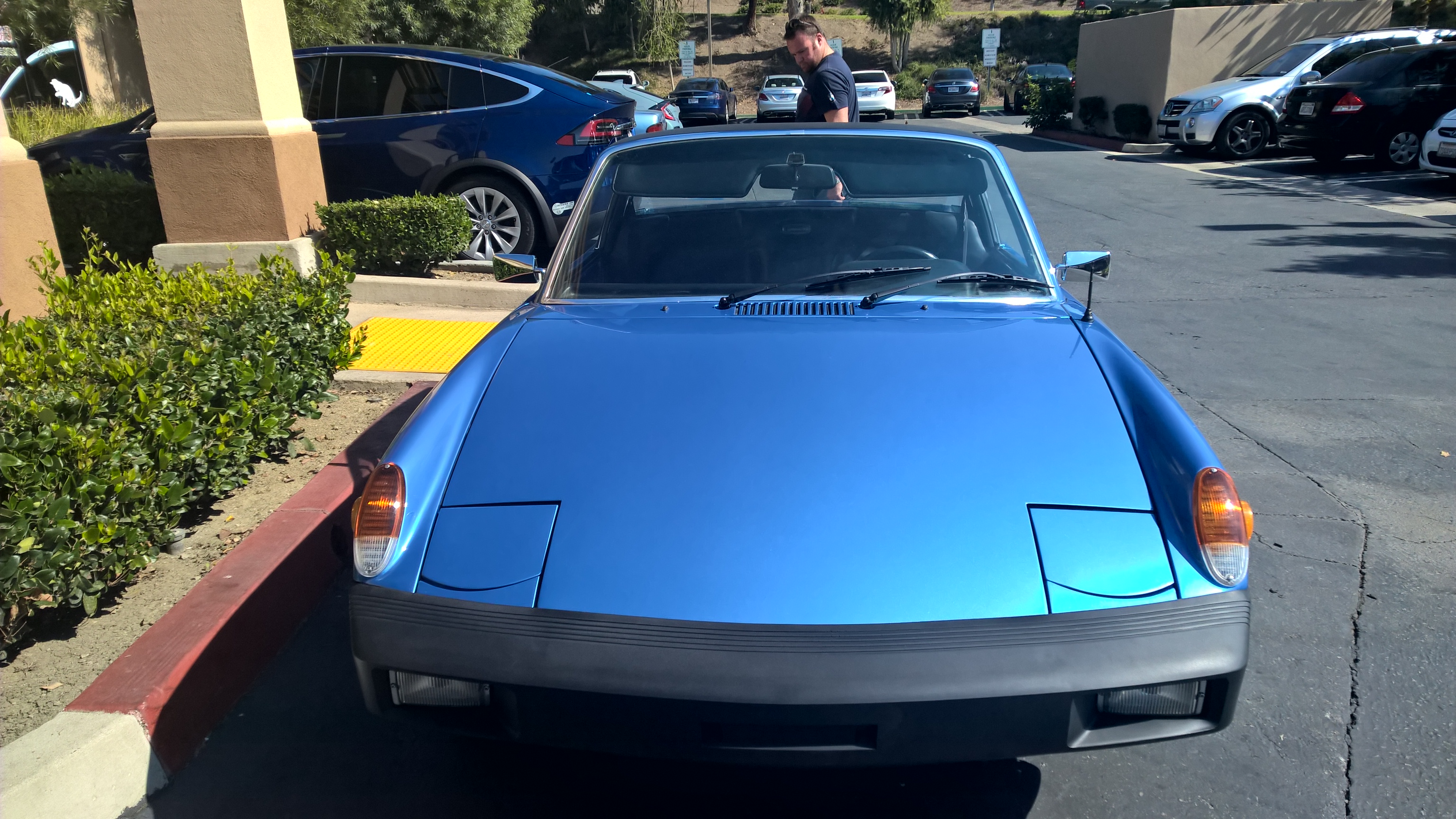

Today was the day to get it from the painter and transfer it to the mechanic. Paint and exterior re-assembly is done.
Carlos made sure it was well taken care of.
drem914
Some more shots of the progress.Click to view attachment
Once again, thank you Mueller. Still trying to decide if I put the letters back on the grill

Had not posted anything here in a bit. Currently redoing the clutch while the engine and trans are out. I picked these up today from Tony at Autobahn Interiors in San Diego.
Rails on and ready to go back in the car.
drem914
Been awhile since I updated on what was happening. Installed one of the seats back in the car so it can be test driven. I was hoping to get the car back for Christmas, but that did not happen due to a few unseen issues when the car came back from paint. Before putting the gas tank back in we found out it had rust in it and the fuel filter, for the short amount I drove it, was turning dark rather quickly. Had to get a new tank to replace it and repaint it. Did that and then found out the fresh air box was broken and had to get a replacement for that. Then before putting that back in found out the fan was not working anymore and had to go and find one of those. Ahh the joys of a classic car. The long and short of it is that I am down to now just waiting to get it back, hopefully before the new new and install the rest of the parts waiting in the garage.
Click to view attachment Sorry about the photo, can't get it to flip over.
Cairo94507
Montreal914
What is your tire/wheel combination?
drem914
QUOTE(Montreal914 @ Dec 28 2018, 07:31 AM) *
They are replica Fuchs from Euromeister 7x16s with 205/45-16 Hankook tires.
