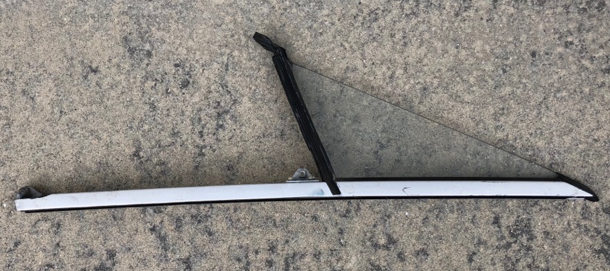

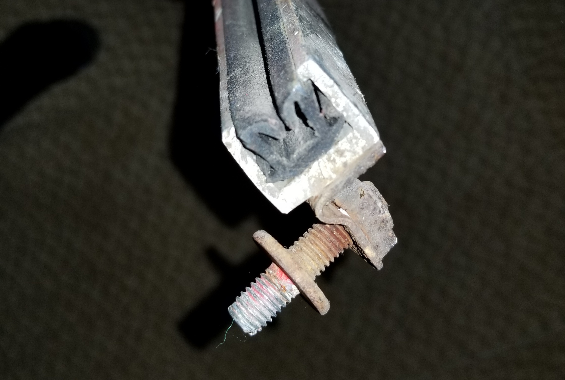

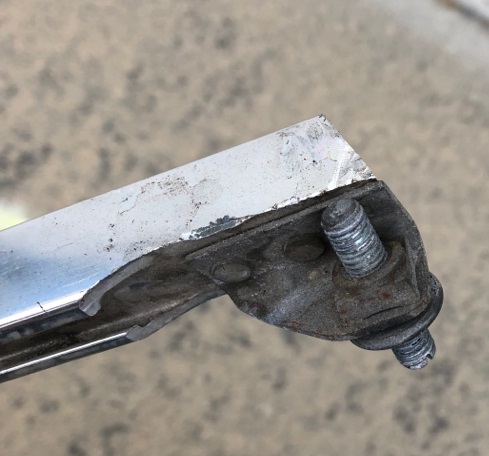

yes, but the back side nut is attached to the track- i dont think the bracket comes off it is riveted to the track, i bent the bracket even after pb blaster! then it cam off the track and the screw was still stuck in the nut! i really messed it up- i think i will need a while new track that has a good bracket and nut/screw thats not rusted on tight- i suppose theis is a NLA part?

Last I checked, the tracks were plentiful at places like EASY. Trick was finding a good candidate without deep scratches and sending it to be redone in proper ano-brite finish (polished then clear anodized).
I would think there is some way to get the bolt/stud off? Those are out there for sure...

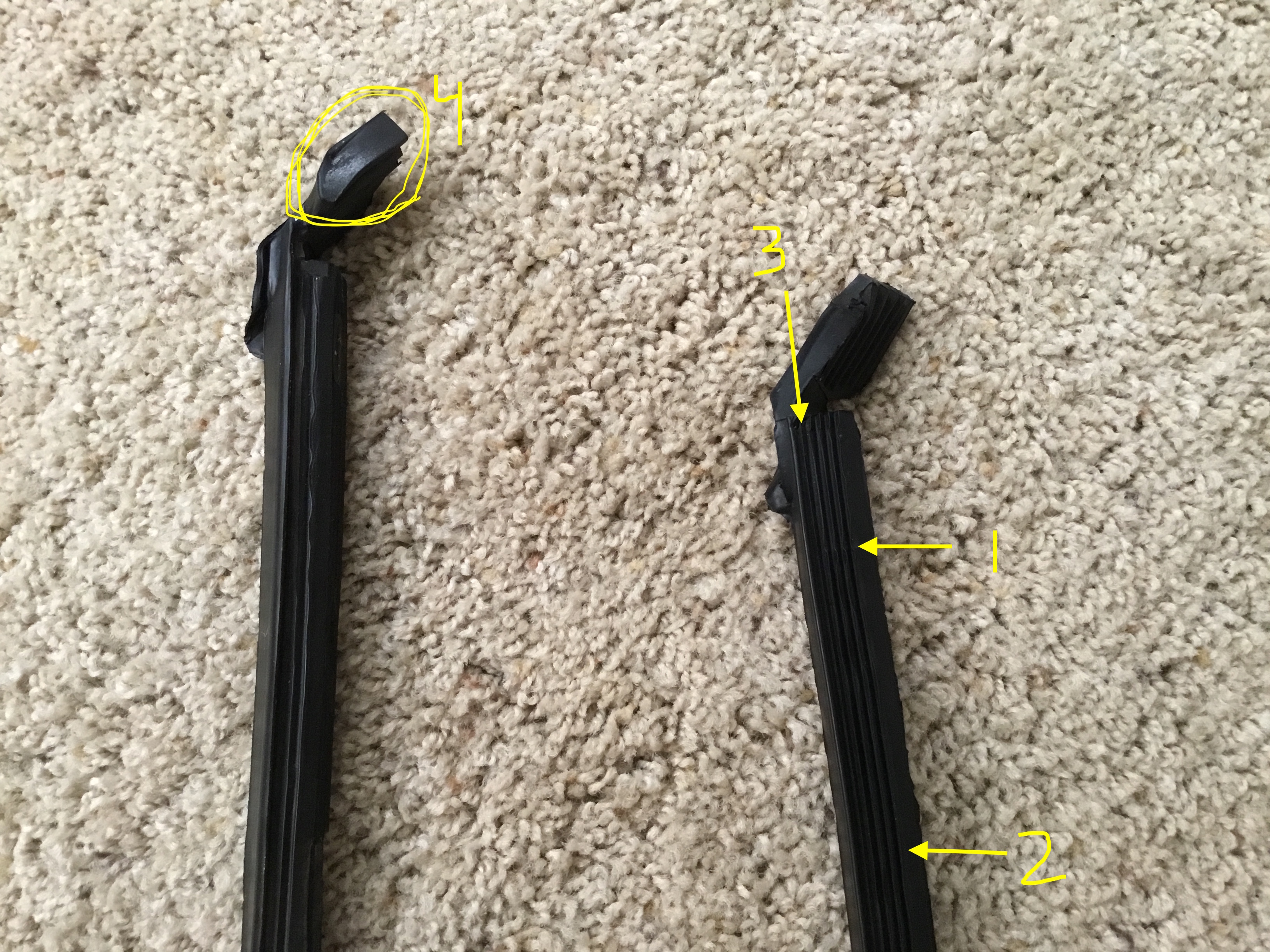

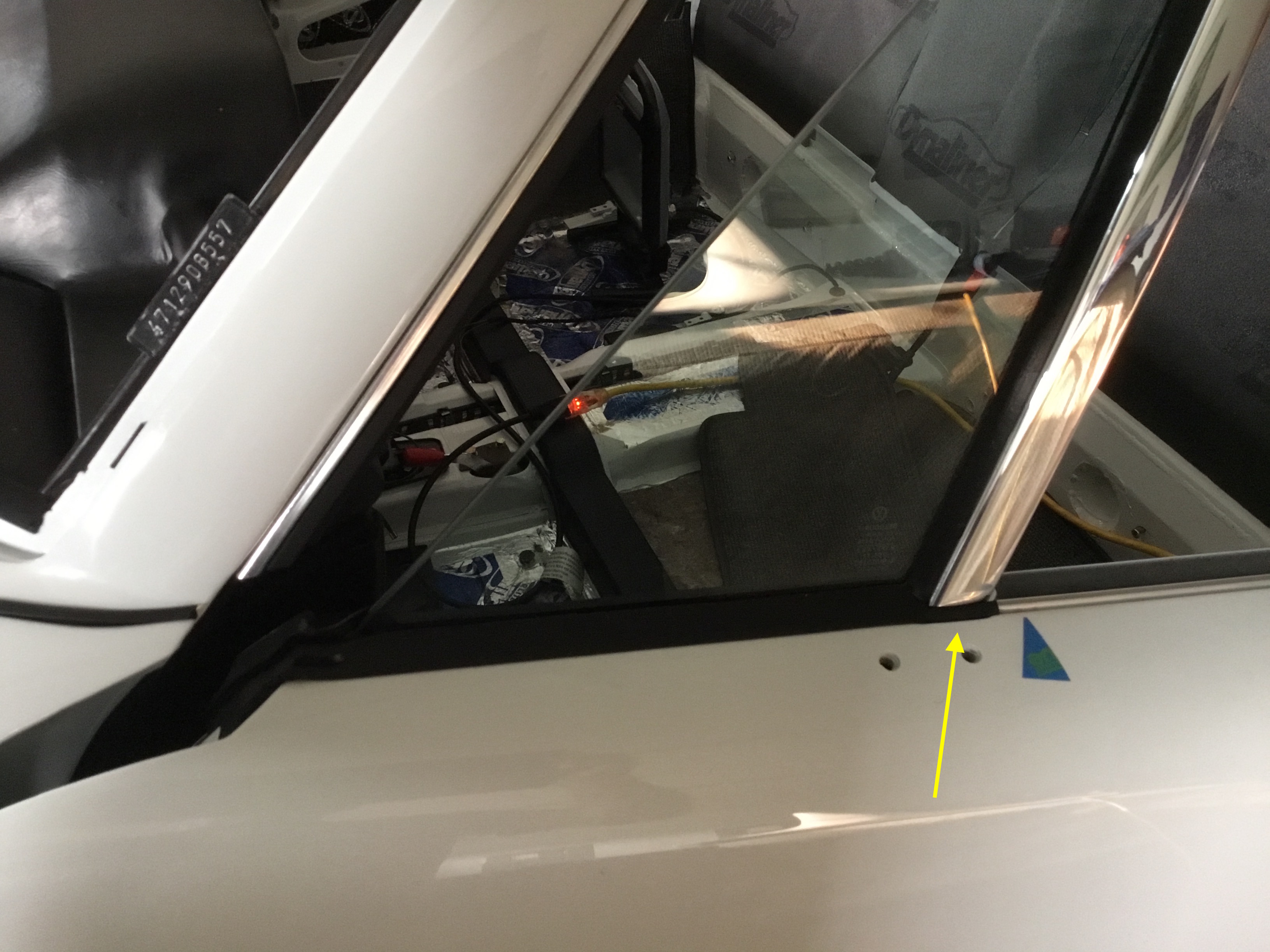

I'd have to agree with a lot of what is said here.
The 914Rubber piece does not fit all that well....especially at the front end where it fits both into the long narrow rectangular channel and where it also goes into the groove for the inner door seal.
See pic below.
The arrows where I labeled 1 and 2 are the part of the seal that goes down into the long narrow rectangular channel....yes?
This section of the seal is a bit too long to fit into this channel.
So I took a very sharp kitchen knife and made a short cut of approx. 1/8 - 1/4" along where you see arrow 3.
This allowed the front part of this seal to go into the door more and allowing the seal to fit flush.
The 2nd issue is the area I have circled with a 4.
This is the very front part of the seal that is supposed to go into the same groove that the inner door seal also sits.
If fact they will both butt up against each other flush if you've cut the inner door seal at the right place.
This part of the 914Rubber seal needs a lot of trimming to get it to fit into this groove.
I used a combination of wire snippers and again the very sharp kitchen knife to slowly whittle this leading edge into the correct shape to nicely fit into the groove.
Once you've got both of these above mods complete, you'll have a chance at getting this 914Rubber window seal into place.

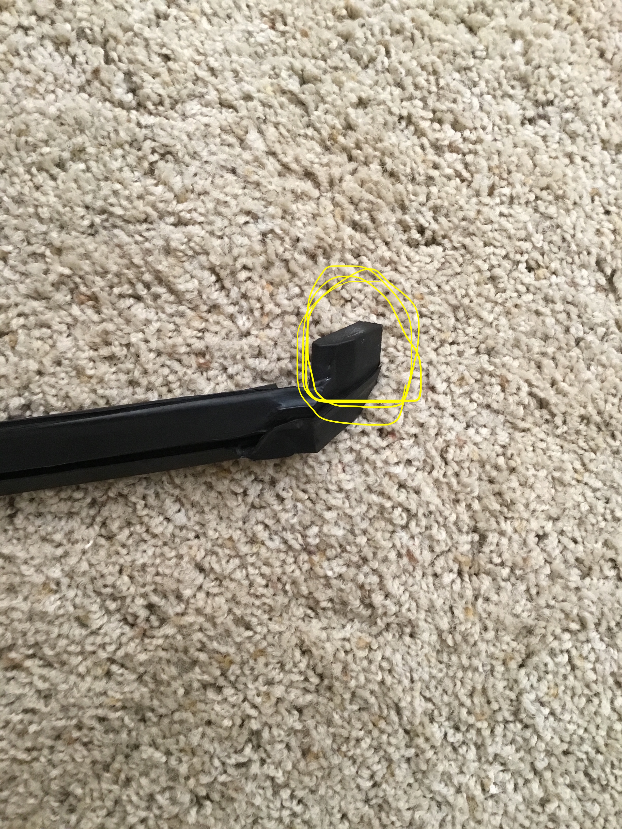

raynekat
Here's another pic/view of the offending area of the 914Rubber seal that needs to be whittled down in order to fit into the same groove as the inner door seal.

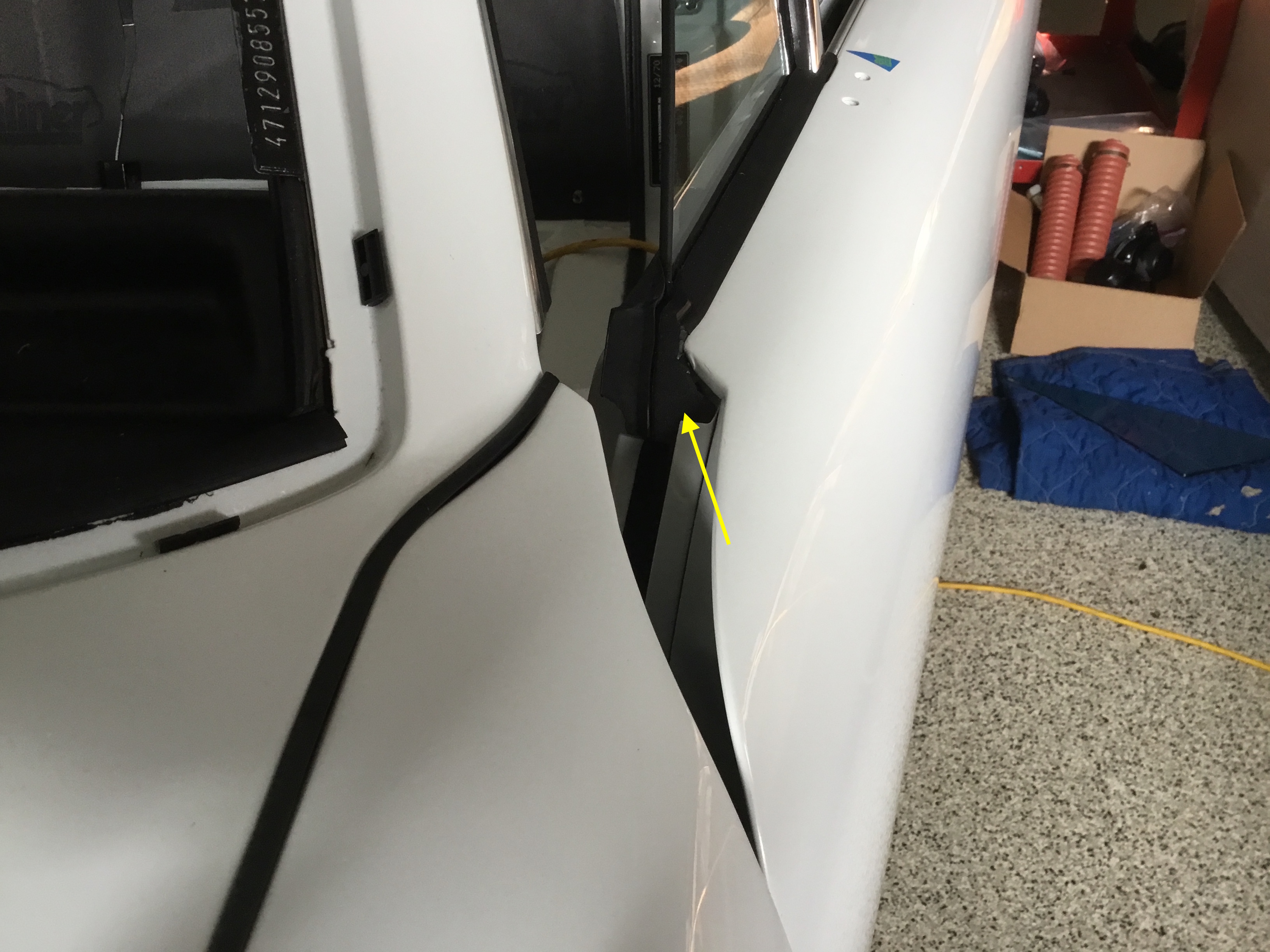

raynekat
Side view of the seal installation.
Again, it is sitting down into the slot very nicely after making the above mods to the seal.
One thing to note where the arrow is pointing.
It is said that this 914Rubber seal is supposed to be wider here thus sealing better.
In my estimation, not really all that much.
It is still too thin here to really seal all that well.
I may slide another thin piece of rubber in here to fill out the space a bit better.
You'll know what I mean when you get to this point.
As opposed to trying to install the seal, window and window guide as one unit, I took a different tack.
I installed the seal first, making sure it was correctly seated along the slot where it resides as well as at the very front that fits into the inner door seal groove.
Next I came with the aluminum window guide, while holding the seal in it's place.
You can attach the upper and lower bolts for the window guide at this point.
Lastly I came in what the window.
Front nose first followed by sliding the window down into the groove in the seal.
I used lots of silicon lube spray for this last part.
At the end, I installed the hard rubber piece that goes at the very top of the window guide and that holds the window down into place.
This worked for me on the driver's side window.
I'll be doing the passenger side likely tomorrow.
Will keep you posted on any issues or "ah-ha's" if I get them.
One note: I also used a small piece of wood to push the seal down into the door. I wouldn't use anything too sharp like a screwdriver, etc to do this.

I have this driver's side frame if you need it. Unfortunately I'm on the left coast.
-Carl

update:
well last night I decided I would try the passenger side since I had that window installed into the seal and on the rail, and I was able to get the adjustment screw loose.
Same issue with the seal base being too long to fit into the door and front side not being able to be squeezed down in all the way, but I lubed it up, made a very slight trim to the bottom front as instructed by Mr. Matt and Mr. Mark.
so once the track or frame bottom was in far enough to put the top screw in, and then the adjustment screw also at the bottom was in its hole, it looked like I had it in place and would work, but upon trying to shut the door, the front edge of the window and the seal on the car just don't line up. Huge gap at the top, and not the in or out adjustment that you would expect and be able to adjust with the screw at the bottom but rather the top edge is back too far, and the front is about a 1/4" too far forward and cant shut the door. now with out the window or seal the door alignment itself is perfect so that is not the issue., somehow the triangle and seal do not set back at the base, far enough back. and the frame somehow needs to angle more forward about a quarter inch at the top. but there isn't really an adjustment for that , with the 2 screws in place it should line up, so any ideas??
I don't have a pic sorry, I gave up as I was getting eaten by mosquitoes ,
just had had it again. 1

QUOTE(tmc914 @ Aug 12 2018, 09:20 PM) *
That triangle seal was difficult indeed. Started with the drivers side and then stopped when it came to the passengers side. Not worth it. Had to do a lot of extra cutting of the rubber, finally got the door to close properly. Do need 3 hands to make it work but somehow I did it with only 2 hands. It seemed like the grove the glass slides into at the bottom was not deep enough and the glass is pushing the whole arrangement deeper into the door than it should. Not going to try and fix it unless something pops loose. There is a lot of pressure on that triangle glass right now with the door closed.
I am going to have to recheck the triangle glass groove depth. I had not really considered that as an issue. on my car the whole bottom of the seal is too long to set into the door groove.
I re-tried the passenger side last night and did it 2 different ways, no luck, but closer in that when I pulled the glass out, and got the vertical frame lined up then adjusted in to proper place where the top angle cap was up into the frame seal properly with door closed, I then put the seal in with out the glass, but still too tight in front even with out any glass. so I did a slight trimming of that front bottom leading edge just as suggested by Mark and Matt to get this to sit donw into the channel and I am closer to getting this in, the door actually shut, but this is all with out the triangle glass not in the seal. I tried to slide the glass into the seal with out moving the frame out since it was lined up perfectly now, but that was not working either!!

what it looks like right now is when the window is in the seal ans installed in the track, its so tight and too wide and long so i cant get the front end and leading edge of the glass back down and back far enough to not hit that car seal, and then of course the door will not close,
Mikey914
To be honest this one had me swearing quite a bit too. The window in the front does tuck underneath however the back needs to rotate down so as long as the base of the seal is fully engaged into the door it should be a matter of the center of the track coming back just a little.
In other words adjustment for and aft

I know we need a tight fit to not allow water past the seal, so I know it hst to be snug. The fore /aft adjustment is minmal, not much room for adjustment at all on the upper small bolt. The lower can shift a bit which will cause a counter-effect on the upper end, and if you move that lower bolt down/back the pivot will move upper forward and the leading edge of triange slightly down, which I did do and that did help, in fact it was almost a perfect fit at that point- with out the window though lol!!
I am going to keep coming back to it but not until I get the motor in and car running, at that point I hope to have enough time to revisit this. Also I know these cars do vary a good bit due to the nature of manufacturing back in the day, so I am fully aware there will be differences in fit and finish from car to car.
