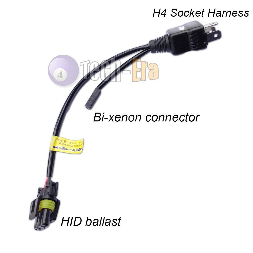

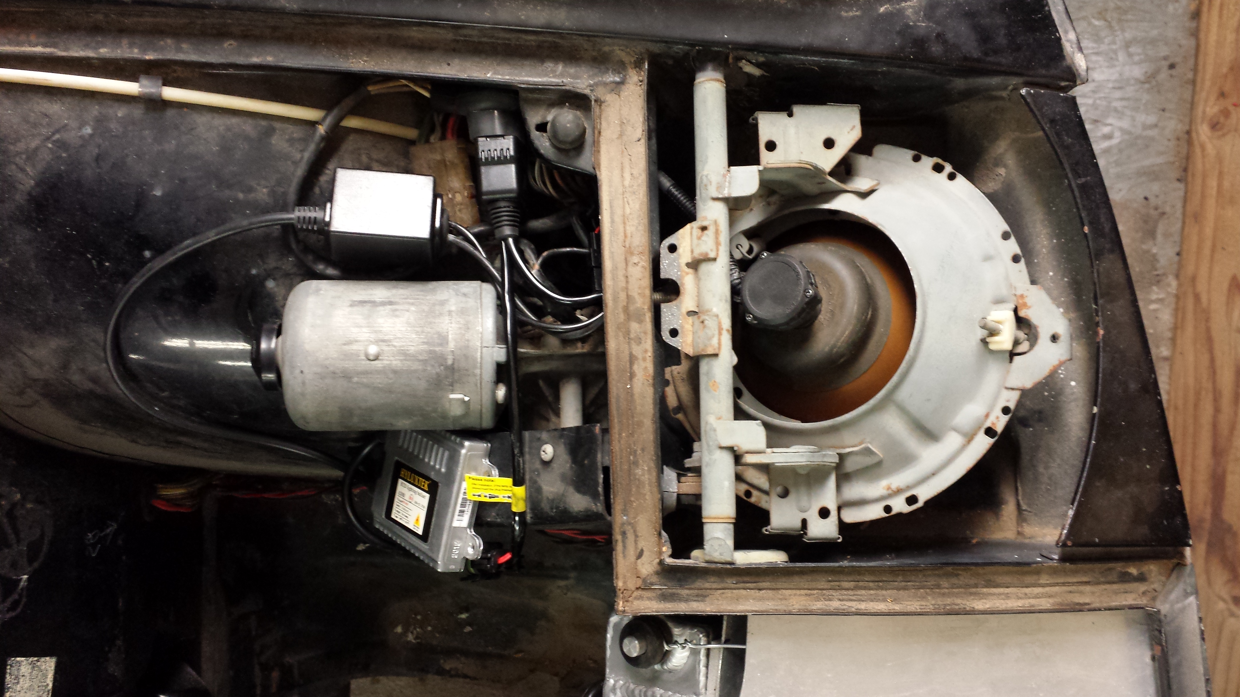

My ballasts just plugged into the headlight connector. At 8 amps at startup and 3 nominal it's not drawing more than stock current.

OK, my kit came with the standard battery harness too. I bought the h4 plug adapter harnesses separate.
