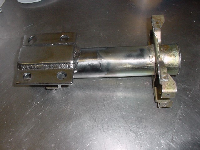

I plan to/will install a 914/6 type column/converted 911 into a 1975 chassis, no idea what year my 911 switches are from, so it will be an adventure electrically. I have two different wiper switches, and the harnesses from them are radically different. I have pig tails cut from the chassis side of a 911 harness, with the connectors so I don't have to hard wire it in the car.

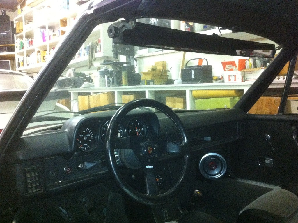

Planning on doing the same on my 72 914 as im building å GT car

I’m talking to someone who is very experienced with Porsche wiring and custom harnesses about doing a plug and play harness for my 71. If successful, we would make more and adjust it for other years.

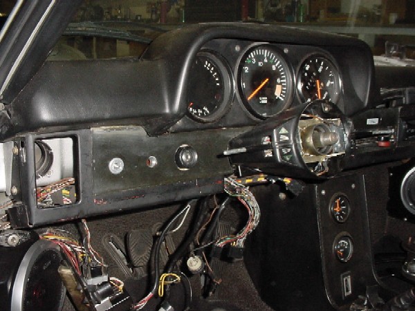

Unfortunately i didn't document the electrical part, but i don't remember it being difficult.

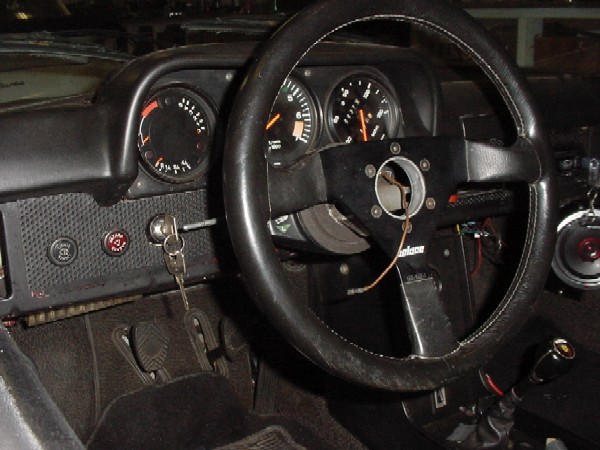

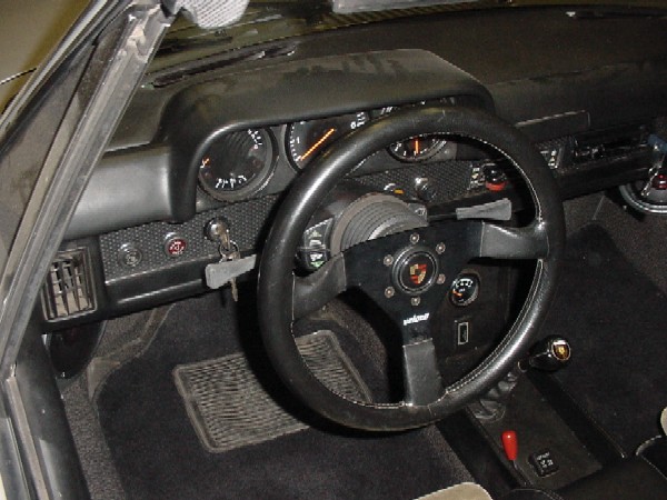

The only trouble I had with wiring was the wiper switch and the washer switch. I had converted the 914-4 column to electric long ago following one of the old UpFixin' articles back in the 1980s, so it was a bit funky, but once I got it all sorted, everything has been fine.
On the topic of plug&play, it may not be so easy since some of the earlier cars had a separate switch for wipers and the pneumatic washer system, but good luck with that. I know my car will never go back to stock.
I try to keep my mods Porsche-esque, but I also want the later tech like dash vents, movable passenger seat, retractable seat belts, later model passenger footwell, door bars, etc. Most folks dont know what they are looking at anyway. I do like the left key placement, but I doubt I would ever do it again.
I believe I used a 1973 911 steering column as a donor. I did have to find a 911 MOMO steering wheel adapter to go along with the 911 steering column for my steering wheel.

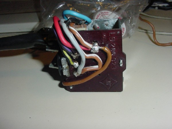

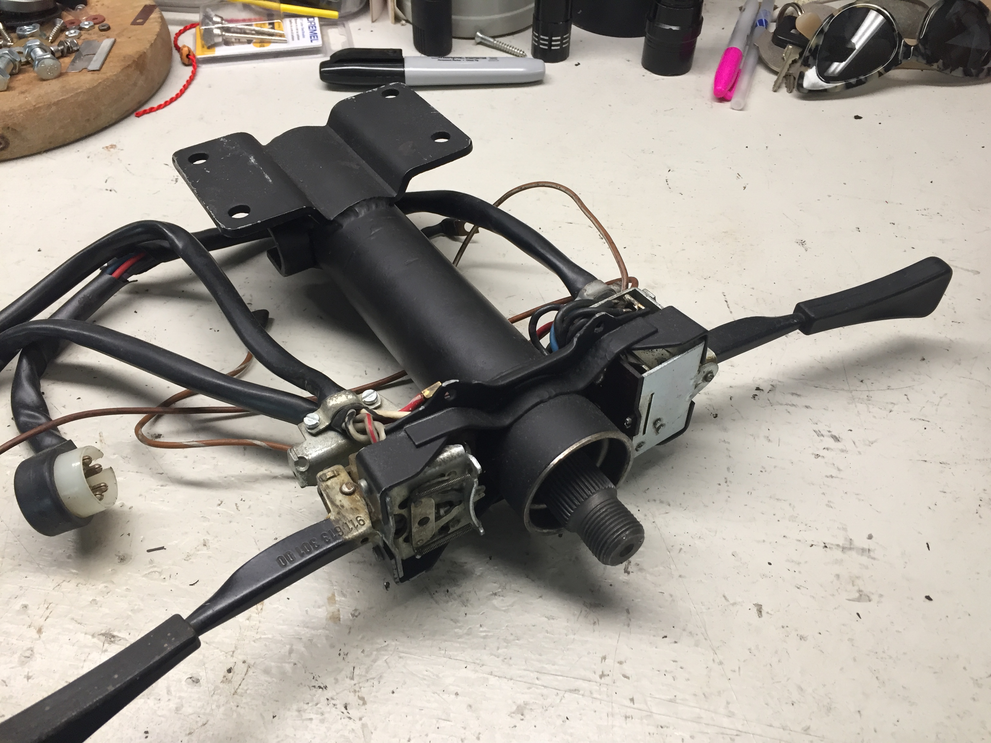

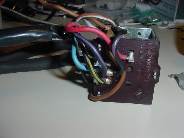

Here is what I currently have. As previously mentioned, I have no idea what years the switches are from.
Again, thanks for all the useful info from everyone.
MB
