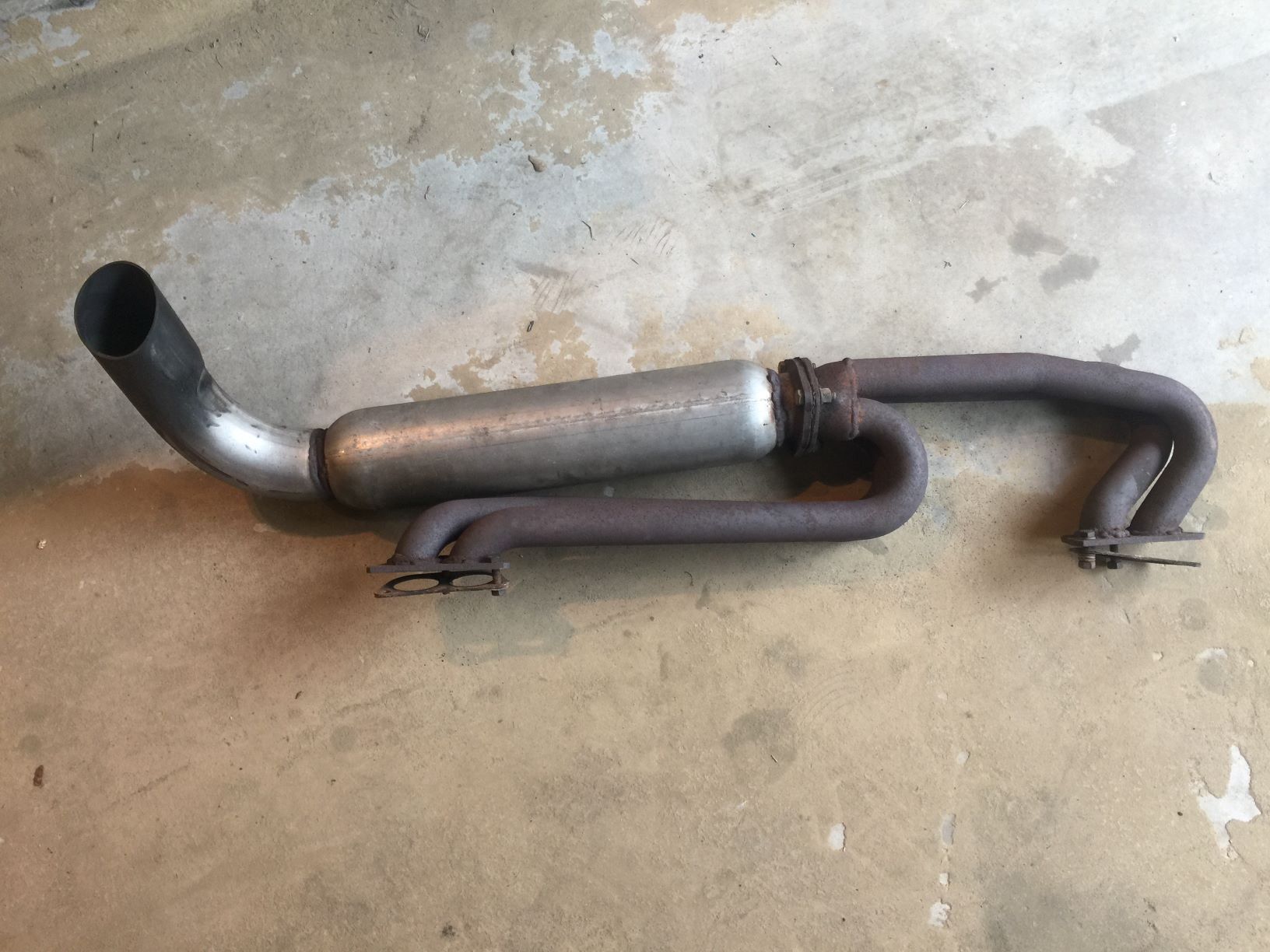

This is what the car came with, which was way too loud:

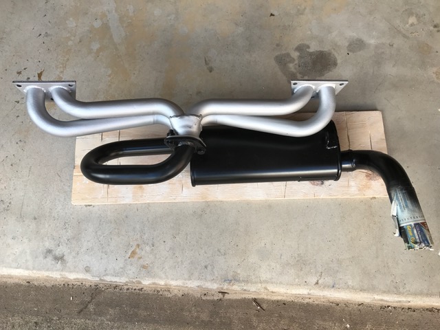

This is what I'm using now, which is very restrictive (noticed significant drop in power), but the sound level is good.
