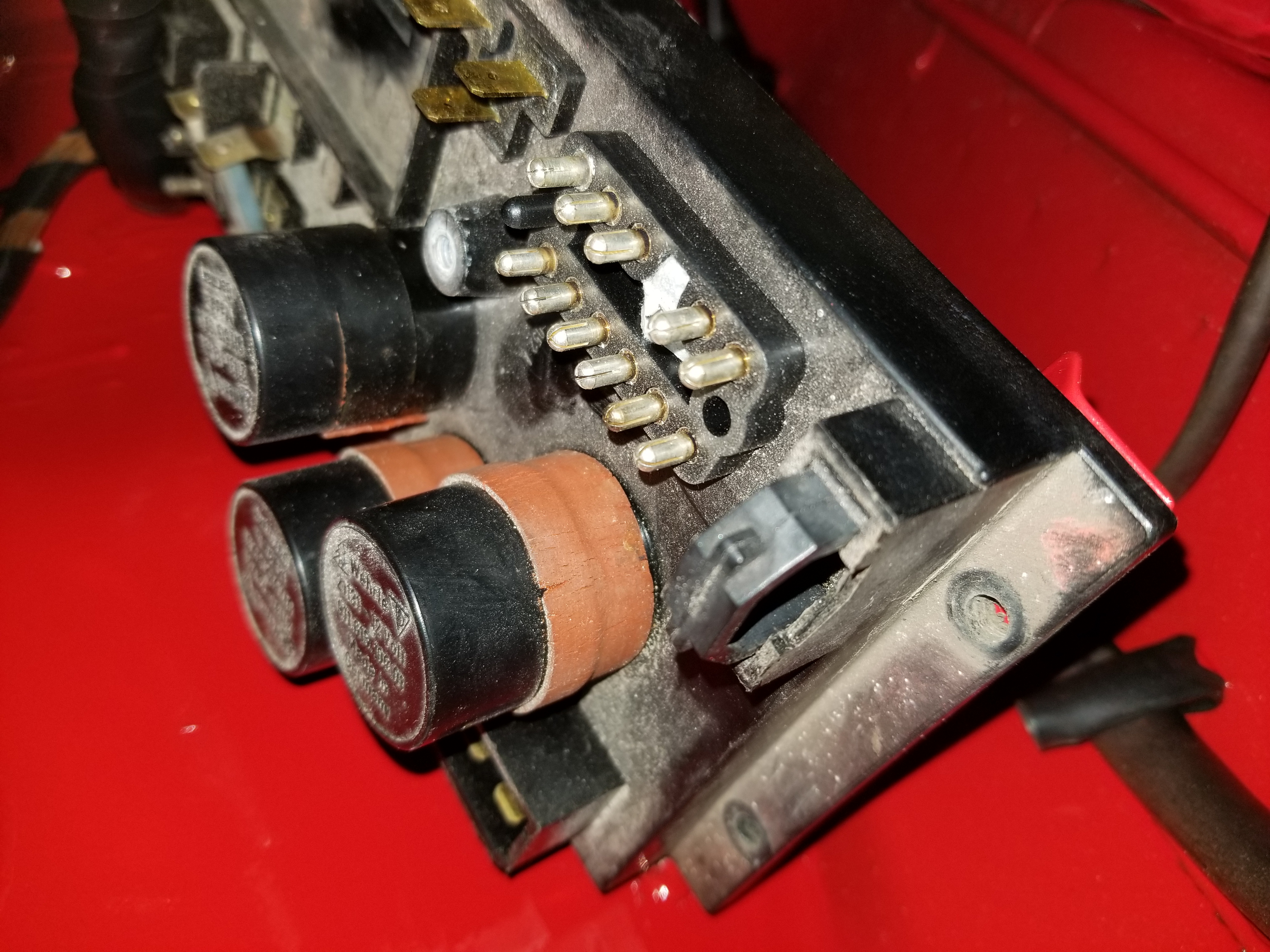

yellowporky
Does anybody make these?
Mike Bellis
Not sure. Never seen them. They look like they would trap moisture and cause premature corrosion.
sithot
QUOTE(yellowporky @ Nov 30 2018, 08:27 PM) *
There are many varieties of heat shrink tubing. Keeping moisture out appears to be the reason for these. Marine grade utilizes a sealant. I use it all the time on wires that can be exposed to the elements.
bdstone914
I do not see the need for them on a 914. Would make pulling a relay harder. One time use. Other ways to reduce corrosion of electrical contacts.
Bruce
914Sixer
They were just big rubber bands. They were added around 72-73 to keep moisture out of the relay. Most died after a short period of time. The ones that did not break are like yours. Most are hard and crusty. They will crumble when you start to take them off.
