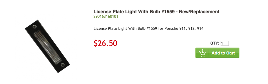

Why the difference between the 901.631.601.01 license light...
...and the 901.631.601.00
Both say they are for the early (70-74) 914s.

George,
The screen shot I posted is from your site and what I ordered from. I changed the quantity to 2 and clicked "add to cart". It says "License plate light with bulb #1559 for Porsche 911. 912, 914."
If the description is correct on another place on your site, that's good. It probably should be correct everywhere, however...especially on the screen that the customer uses to order the part.
If this is partially my fault because I should know my car better than I do or because I should have done more research on your site, no big deal. I can't use them and I'd like to return them even if I have to pay return freight and a restocking charge. I've had good luck ordering parts from you. Good stuff, good prices, fast shipping. I won't let one little problem stop me from continuing with AA.

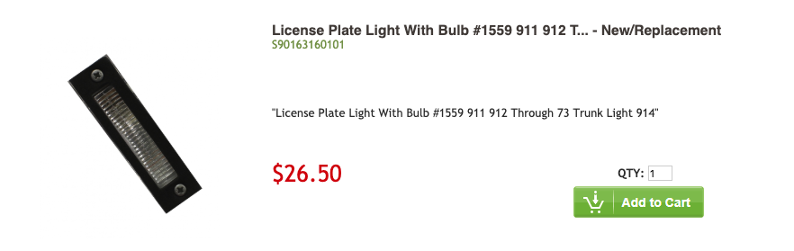

DickSteinkamp
George,
Thanks for correcting the description. Looks much better smile.gif ...
