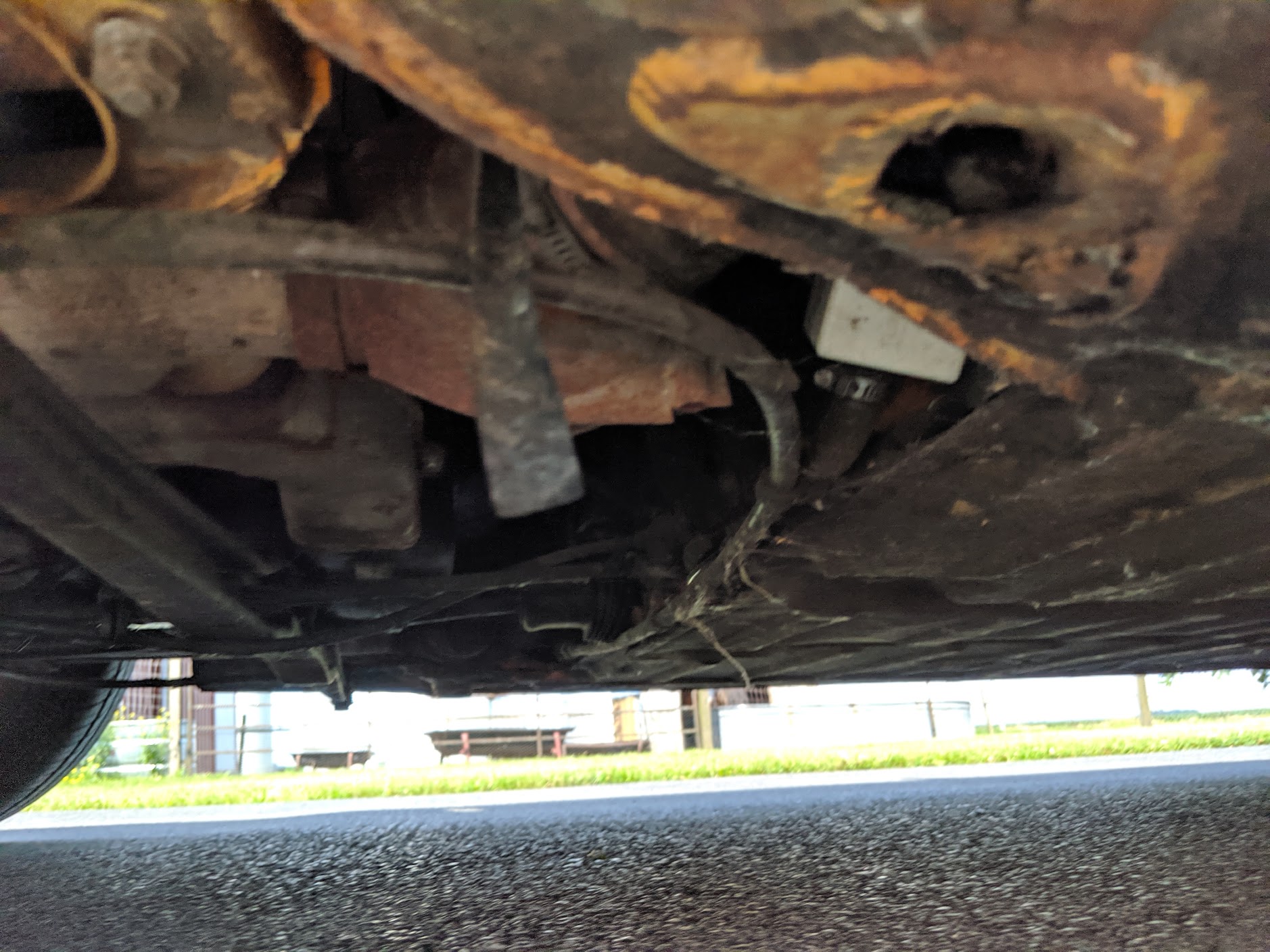

Does this look correct? This is on the passenger side, in front of the rear tire. I had been looking for something like the Mahle canister.
(Sorry for the bad pic!)
Pelican sent me a Mahle filter...round, not square...can I use this?
Part# 311-133-511-D-M67
Mahle KL 11 OF
1971 Car, 2.0 with some various bits from a 1975...just trying to sort what's what.
JawjaPorsche
The original location of the fuel pump and filter were not an idea location. Not only change the fuel filter down there but the fuel hoses to avoid fires. Get High pressure fuel hoses. The original filters were square. Also get the correct fuel hose clamps too.

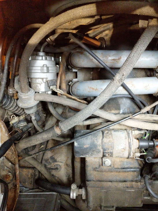

1971 914. 1975 2.0 and various bits...
The fuel filer is the boxy one, under the car...but need locate it so I can order lines. I just pullled up the gas tank and I don't see it under there. I thought that's where I'd find it.

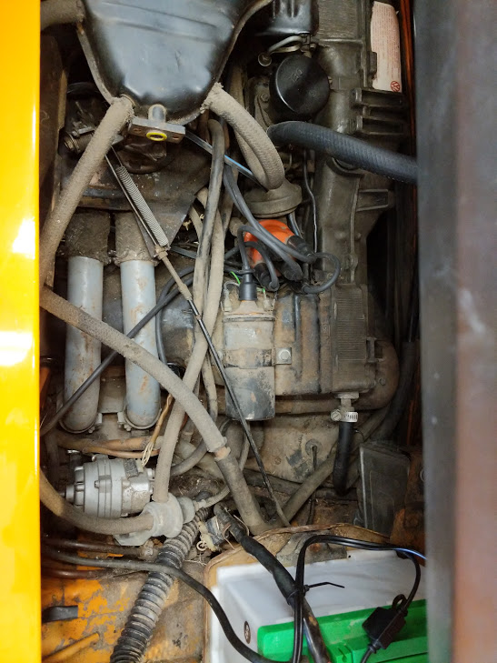

Is it the shiny silver pump here?
Click to view attachment Click to view attachment
dabird
Take the plate off that's covering the steering rack underneath the front of the car . It's probably been relocated to there
On a '71 the fuel pump is under the pass. side engine shelf near where you found the fuel filter. Follow the fuel lines from the filter and you should find it.
That shiny round thing on top of your engine is the mps sensor which should be mounted to the small bracket next to the battery tray.

I didn't think that was the pump, but figured I'd ask. Someone was trying to convince me otherwise.
I'll follow the lines from the filter, but if it's in there, is buried up pretty good, I cant see anything on first/second glance. All I need is a confirmation to make the order with Chris F.

Found. It's under the car, by the rear passenger tire.
