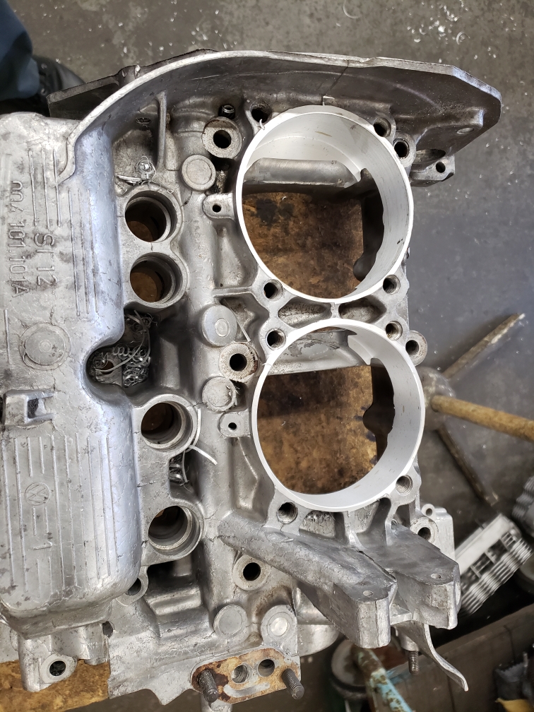

Ok so some of you may know I am doing the build of my life.
Put the case together for checking fit all went fine everything turned great. Disassembled and found this break in the case at the cam.
Click to view attachmentI have a massive amount of money in this case and it is opened for my 102s.
Anyone think of if and where I can get this repaired quickly?

If you have it welded you're still going to have to take it back to the machine shop to have it checked/honed
mb911
Aug 9 2019, 07:32 PM
It looks like aluminum so most any good TIG welder can do it. I leave for Nashville mid next week so if you wanted me to get at it I would need it Tuesday so I could ship back Wednesday
Mblizzard
Aug 9 2019, 07:40 PM
QUOTE(mb911 @ Aug 9 2019, 05:32 PM)
Bit can you machine it back to being true?

Sorry to see this.
It can be welded up. Maybe a little extra material welded to the back side.
Then have the cam bore can be rebored.

It can be repaired but not cheap as you need to weld and rebore the bearing seat.
But,do I see a hairline crack between the cam bearing and the left pushrod tube hole?

Slow down. Desperation and trying to do anything quickly at this point will only lead to more problems.
Anything can be fixed with enough time and money.
Question is do you have enough of both?
Old joke is you can have only two of the three.
Quick job
Affordable job
Quality job
If you want affordable repair and a quality repair it won't be quick.
Want a quick repair and don't want to spend money, it won't be quality work.
(In no way am I referring to Ben - he will do quality and will do affordable to help a member I'm sure. But the machine work isn't quick)
Think long and hard about trying to save this case. At a minimum you will need to line bore the cam. After welding the cam I'd closely remeasure the crank bores for deformation. Highly likely you would want to line bore the crank too in addition to the need to line bore the cam.
Line boring cases is not for the faint of heart. I know it is commonly done but honestly it is hard to do it right and maintain proper dimensional relationship between crank and cam bores. Even at the factory they dealt with this by select fitting cam gears to take up any dimensional variation between crank centerline and cam centerline.
Are you ready to consider rechecking the cylinder openings too after welding?
After all that - a new case looks better and better.

I would repair it if it was mine.
Careful build-up with TIG, no use trying to weld the broken bit back on. Then hand grind/file/scrape until a custom made gauge pin barely fit through the bore - always being careful to not cut into the remaining original bore surface nearby.
I wouldn't use a reamer - too much chance of removing material from the other case half.
1 hour for the weld process and another 3-4 hours of hand work.
Tedious, but doable and worth it to recover the investment.

Damn, so sorry Mike , you have alot of work in that case , timeserts, bore for 102's,
shuffle pins, ect, , I might try and save it , I would put a correct dia. (cam bearing o.d.)
bar in the cam bore , v-out the crack inside ,pull the piece back against the bar with
small clamp gently , Weld the outside crack let it cool ,remove clamp & bar , then
weld the v-grooved crack , once it's cooled dremel down the weld , check it by
sliding the Bar back towards the welded cam saddle seeing if the bar stops , using
it as a gage , clearance it until it slides in smoothly , then assemble the case with
cam+bearings only , torque it down little by little checking for cam binding by tuning
the cam , then mill file the parting surface to match , just another idea Bill D.
ps you can hold the bar in the cam saddles with a couple of straps going thru
the cylinder bores and around a wood 2x2 ,

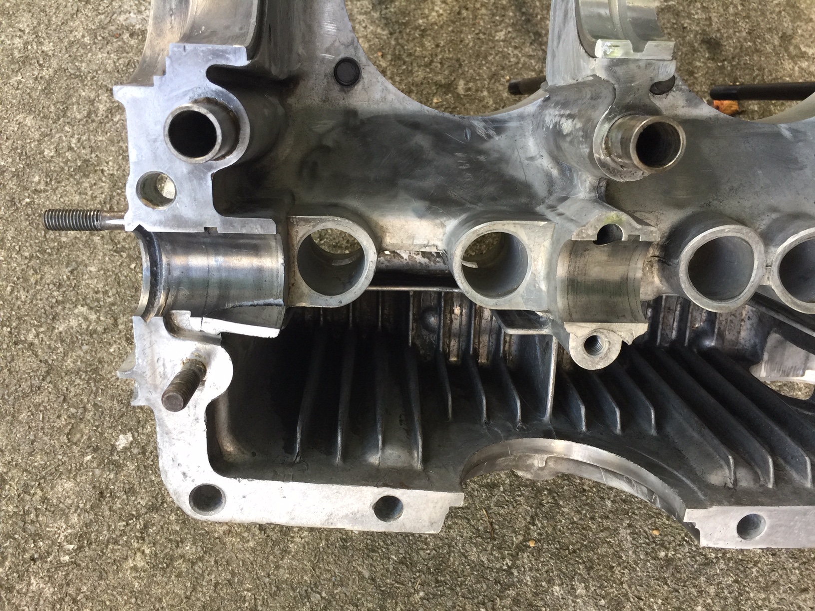

Mblizzard
Aug 11 2019, 06:42 PM
QUOTE(ChrisFoley @ Aug 11 2019, 07:20 AM)
QUOTE(Mblizzard @ Aug 10 2019, 06:52 PM)
QUOTE(ChrisFoley @ Aug 10 2019, 08:45 AM)
Chris I would love to hear a recommendation on who could do this.
Metal craftsmen with the required tools and skills aren't too common nowadays I suppose.
Someone who restores antique cars maybe? An old machine shop that also does welding?
Someone who likes to work with his hands and has plenty of patience.
If its going to be a back-up and you don't mind waiting a few months, you can send it to me.

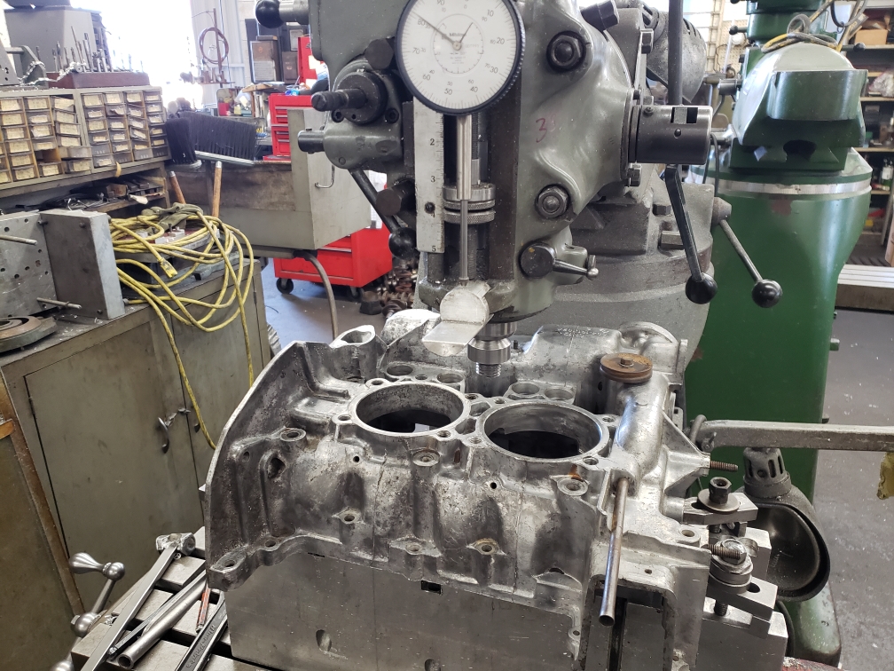

Mblizzard
Aug 13 2019, 05:18 PM
Aug 13 2019, 05:43 PM
Mike - I have a good case that I can send you (or your machine shop) for free but I’m headed to Maine tomorrow and won’t be back until Wed. Sorry about the timing but it’s yours if you want it. Mark
Mblizzard
Aug 13 2019, 07:05 PM
QUOTE(mepstein @ Aug 13 2019, 03:43 PM)
That offer is so meaningful! But Jorge at European Motor works seems to have one ready to ship tomorrow.
Click to view attachmentClick to view attachment
mb911
Aug 14 2019, 04:33 AM
Mike all I can say is wow.. I hope you have no more hurdles and everything goes smoothly from now on to completion..
Mblizzard
Aug 14 2019, 01:25 PM
Well I have to give Jorge at European Motor Works a big thumbs up!
New case opened for 102s, lined bored, and the oil galley plugs drill and tapped is on the way!
