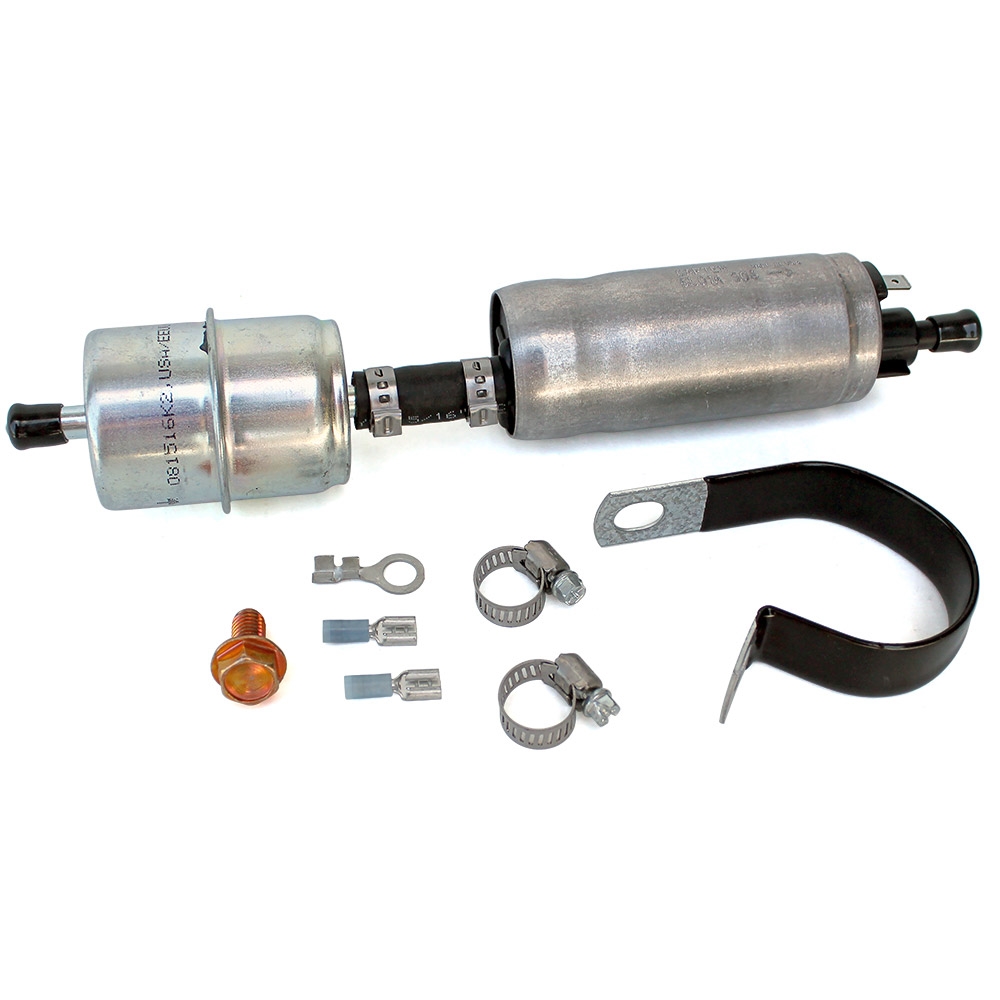

I always hated the noise the facets make. If you have to replace the pump, the CB performance rotary pump has been good to me. It hums a bit, but I haven't tried to insulate it and I think the body is touching the trunk wall.

QUOTE(Tbrown4x4 @ Sep 26 2019, 09:47 AM) *
https://www.cbperformance.com/product-p/3193.htm
