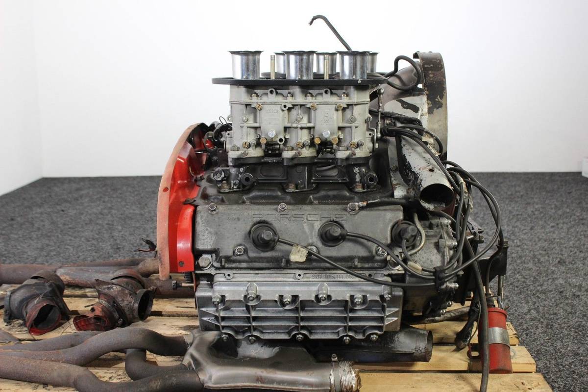

Any idea how much this would be worth?
Porsche 914 6 2.0L Engine 901 36 110HP 1970
Front yard mechanic
Feb 8 2020, 07:13 PM
A dollar two fifty
rgalla9146
Feb 8 2020, 07:28 PM
The engine is worth the most to the person who owns the car it came from.
IF the car still exists...IF the car owner cares. IF that car and person can be contacted.
A 2.0 6 cyl magnesium engine is not very sought after. It is entry level and as expensive to rebuild as larger displacement engines.
It has to be considered a core if there is no known history.

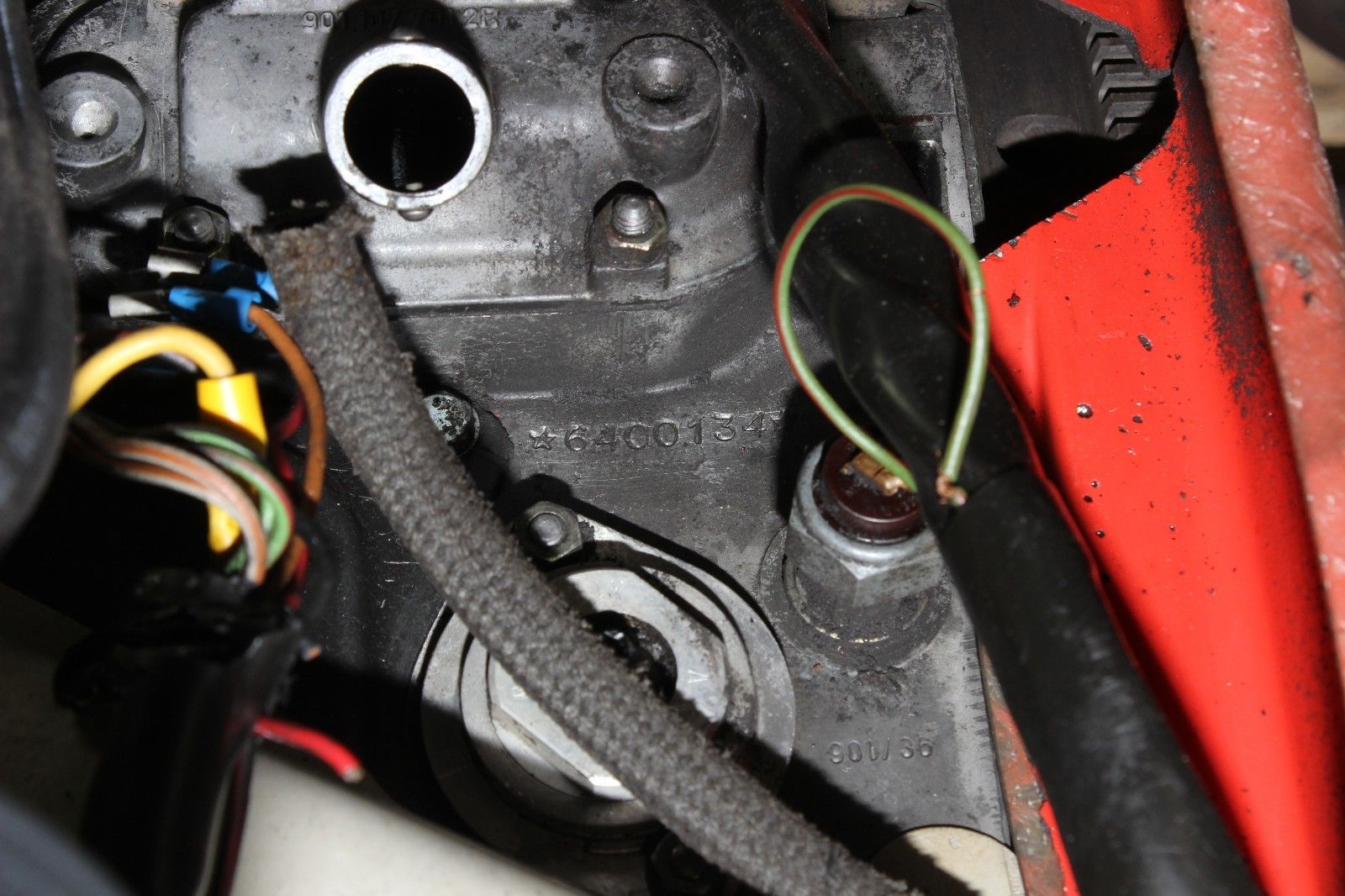

Click to view attachmentTop of engine case, flywheel end. Between the oil thermostat and the breather cover.

Worth more than the average motor due to how complete it is,930 valves covers are a bonus plus flywheel,heatexchangers front mount ,etc.
These engines are relatively cheap to overhaul , the top end and can be uprated to 2.3l and better cams they make good power,wear is limited due to low HP with the 2.0l ,however it must turn over and some service history would be real handy,unless theres a numbers matching guy I would say 6k on a good sale.

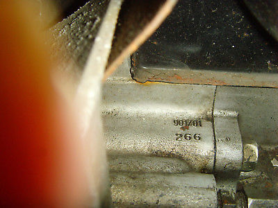

Is the picture showing 901/01 as the engine type of your engine? Or just showing an example?
901/01 is aluminum case 911 engine built from 1964 to mid 1966 or so. It would have had Solex carbs as original and 6 bolt exhaust side cam cover rather than the 11 stud version in your picture.
Hmm... confusing.
So, this is not an engine from a 914-6?
The picture was send to me from the guy who has it.
I’m happy with my 4cyl 2.3L. But of course a six, if not too expensive would be great as well.

QUOTE(roblav1 @ Feb 9 2020, 10:31 PM)
if the engine for sale is a 901/01 it's worth more than a 914 6 engine.
If it has 11 stud lower valve covers it is no longer a complete 901/01
a 901/01 is a desirable 'builder' block for higher performance or racing.

Here is the engine number.
gereed75
Feb 10 2020, 09:09 AM
I believe that is from a very early 914-6 chassis number European model. Ref here
http://p914-6info.net/Engine_Numbers.htmAs previously stated this a fairly complete unit. Heat exchangers are worth $1500 if in good condition. Heat valves are there too if original six are worth something. Also has front motor mount and carbs Depending on what all else you have agree worth About 6000
sbsix
Feb 10 2020, 09:11 AM
That is a 1970 914-6 European engine number.
