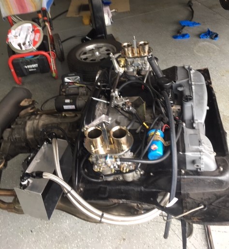

Need some guidance from the World Collective. Since rebuild by an "Old School" engine rebuilder of type IV motors who I've known for decades, the engine runs suburb but has had consistent oil leaks. He was surprised at the HAM heads instructions for the inclusion of the heads in this build to bring you up to date.

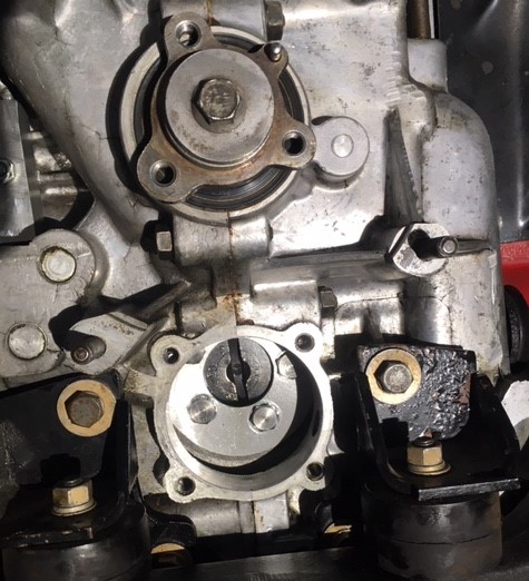

The engine uses a Melling oil pump M-79AHV that has consistently been a leaker.
Upon return from Octeenerfest last Sept with a few engine leaks we removed the engine and went to work. Billet Taco Plate, new valve cover gaskets with valve adjustment as a bonus, rebuilt oil filler breather assy with new gaskets and inspection for any additional leak areas, surprise !!!
Additionally we upgraded with a Chris Foley/Tangerine Racing remote oil cooler system. No leaks there.
With Engine reinstalled and running we've now found the Melling oil pump leaking. This design is split housing and cover design leaving not one but two places for a leak. I want to replace the pump with a single body pump - no cover. The Type IV Store sells a Type IV replacement with a pump that is a single pump body removing the potential gasket seal leak potential.
