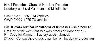

2449628
The last two digits are the running number, where the center number begins with 95 and increments as you roll over from 99 to 100.
So your day started with xxx9501 and rolled over to xxx96xx after the first 100 cars making xxx9628 the 128 car that day.
Montreal914
QUOTE(SirAndy @ Aug 22 2020, 06:37 PM) *
2449628
Every new day starts at 95? The 9 being the factory, but it always start with 5? And how many cars per day were typically produced, and was this 1, 2 or 3 shifts type of operation? Cool stuff beerchug.gif
QUOTE(Montreal914 @ Aug 22 2020, 06:48 PM) *
For '70 - '74 cars yes, every day starts fresh with xxx9501 and the 5 would roll over to 6 if that day had more than 99 cars produced.
For late cars, the 5 was dropped in favor of a 3 digit running number.
IPB Image

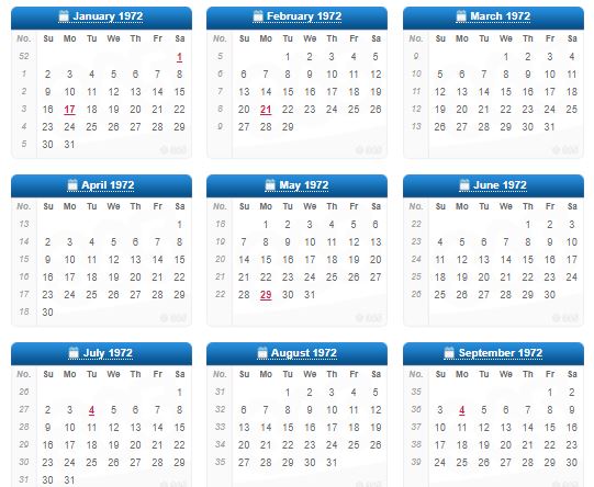

January 1972 started on a Saturday. If you look at a 1972 calendar, there is just one day in that calendar week. Does a week start on a work week or an actual calendar week?
My chassis # is 0729595. So was my car the 95th one made Tuesday, Feb 8?
(7th week, 2nd day of week, #9595=95th car)
Montreal914
Here is the week calendar for 1972:
Based on this, I would say Tuesday February 15th 1972, but I am far from being an expert in this... biggrin.gif
VegasRacer
QUOTE(914 RZ-1 @ Aug 23 2020, 08:33 PM) *
I remember reading that the count starts on Mondays.

This thread of course caused me to look at my Karmann plate on my 1974 car.
My plate only has 6 digits 429530 so I can only assume 4th week, 2nd day, the 95 of course, and 30th car built that day.
Am I right or WTF why does my car only have 6 digits? Appreciate a clearer understanding. Great thread! Thanks!

Early /6 cars only had 6 digit chassis numbers.
www.914world.com/bbs2/sources/action_public/pop_helpchassis.html
QUOTE(Lucky9146 @ Aug 24 2020, 08:52 AM) *
Looks like the leading digit is missing.
Do you have the build date from the door jamb sticker?

QUOTE(Lucky9146 @ Aug 24 2020, 07:52 AM) *
Yes, if the first digit is missing then likely it is in the first 9 weeks. However, I need VIN's to be certain of this. When we get into the late 74 cars, then there are a few things going on with changes to the Karmann # system. I also like to know the paint code to see if they are painting batches of one color at a time.

UPDATE UPDATE UPDATE
Thanks to davep who contacted me via PM and suggested there should be a 1 in front of the chassis number.
I just went and looked again (5th time) and took a very close up picture and there is indeed a 1 right on the edge of the box that the number is in and very hard to see.
It actually just looks like the edge of the box.
That said it is 1429530 which makes it the 14th week 2nd day OR April 2, 1974 and the decal in the door jam says 4/74 so it fits.
Mystery solved!
Thanks again @davep
