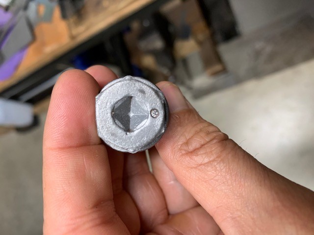

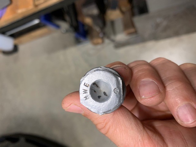

Thanks, Dave. I medial blasted the originals from my car today. I have two that are shorter (.75" of threads) that I think you had said were probably from a bug, and the rest were the correct length (1" of threads). The correct ones do, indeed, have a VW logo on the head. The shorter ones that are presumably from a bug say "HWE" and have the VW logo (see attached pics below).
So, based on your having just stripped 3 original sets of steelie bolts, your conclusion that the should be finished in silver seems strong. My plan will be to zinc plate them and then use a blue chromate which should give me a fairly similar finish to silver cad.
