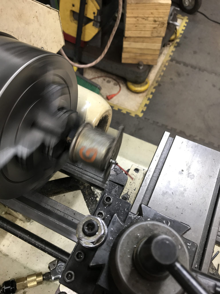

I’ve read the posts about opening up the Auxiliary Air unit, and I have one that I’ve opened for a 2.0 D-Jet.
My problem is the wIre. Mine is broken off, way up inside the casting.
Is there a way to reattach it? Any tips on what to do or not do?

I had an AAR with intermittent short and tried to peel back the portion of the steel ferrule that covers the wire when it exits the main body. I did this using a lathe and I still failed to get an acceptable fix that I would trust.
I eventually disassembled the whole thing just to see what was inside. Not very promising to fix if it broke off up inside that ferrule.
Mabye someone else has good advice for us. AA has "rebuilt" units but pricey at $285+200 for core.
Here was someone that succeeded.

Thanks for the link. I was hesitant to drill out the rivets without knowing what I was getting into.
