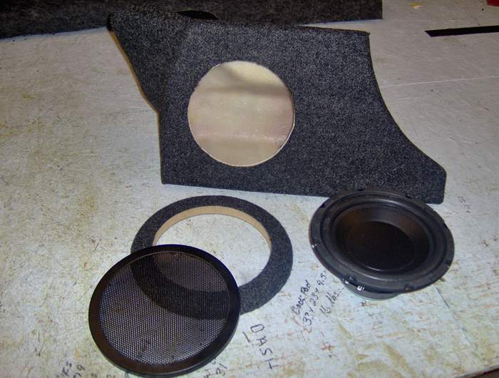

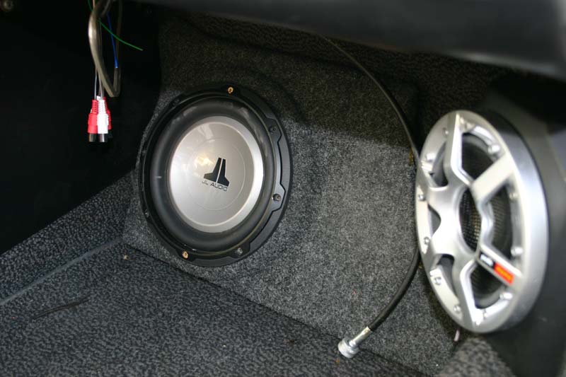

I have the foot foamy replacement enclosure, I'll sell it to you Ian. smile.gif
Pics below aren't mine, but it's the same box in new condition.
I don't like how the speaker is on the footrest and I'm not going to cut up my original carpet, so I doubt if I'll ever use it.
I too want a console based sub enclosure.

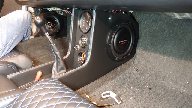

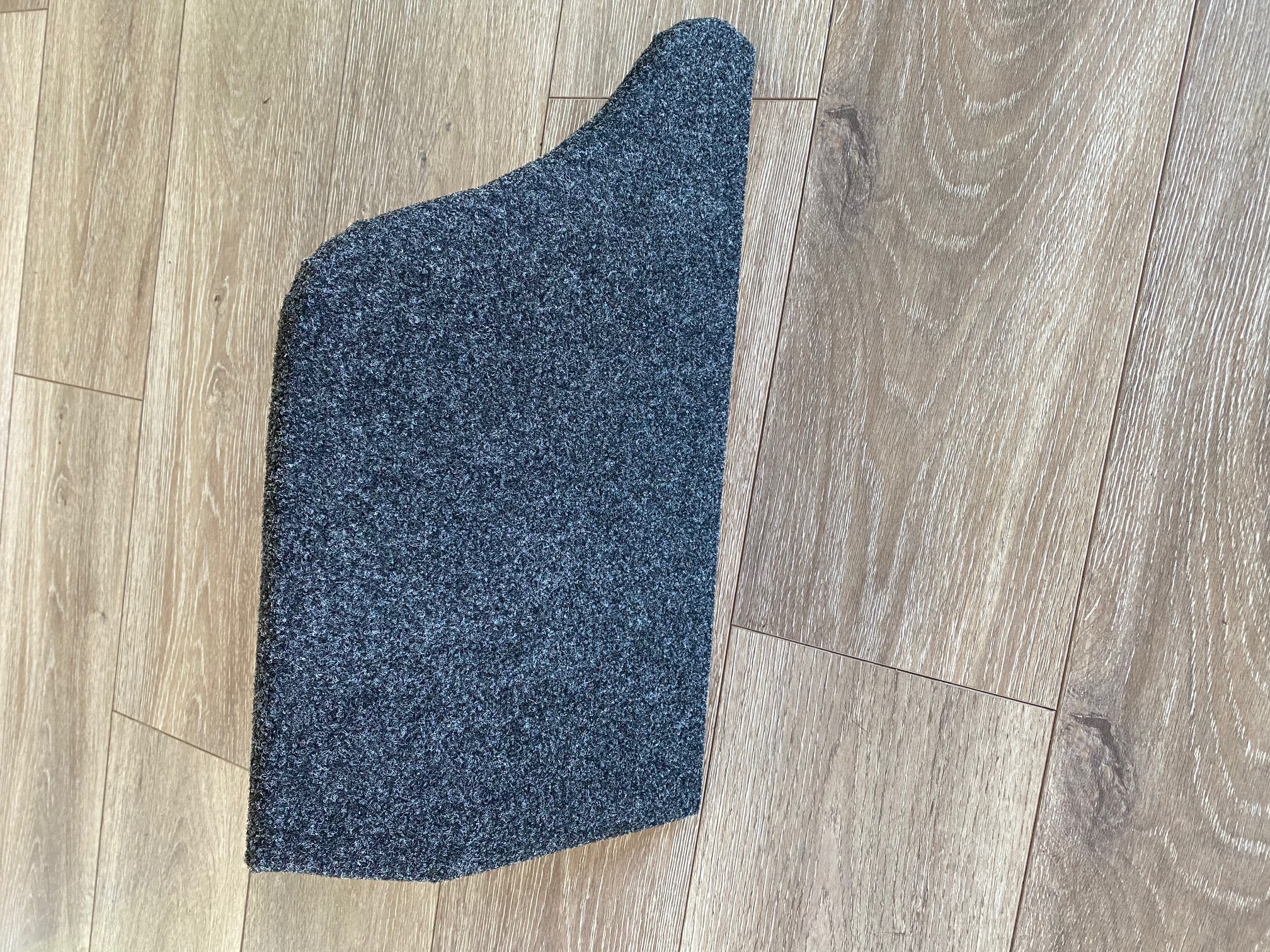

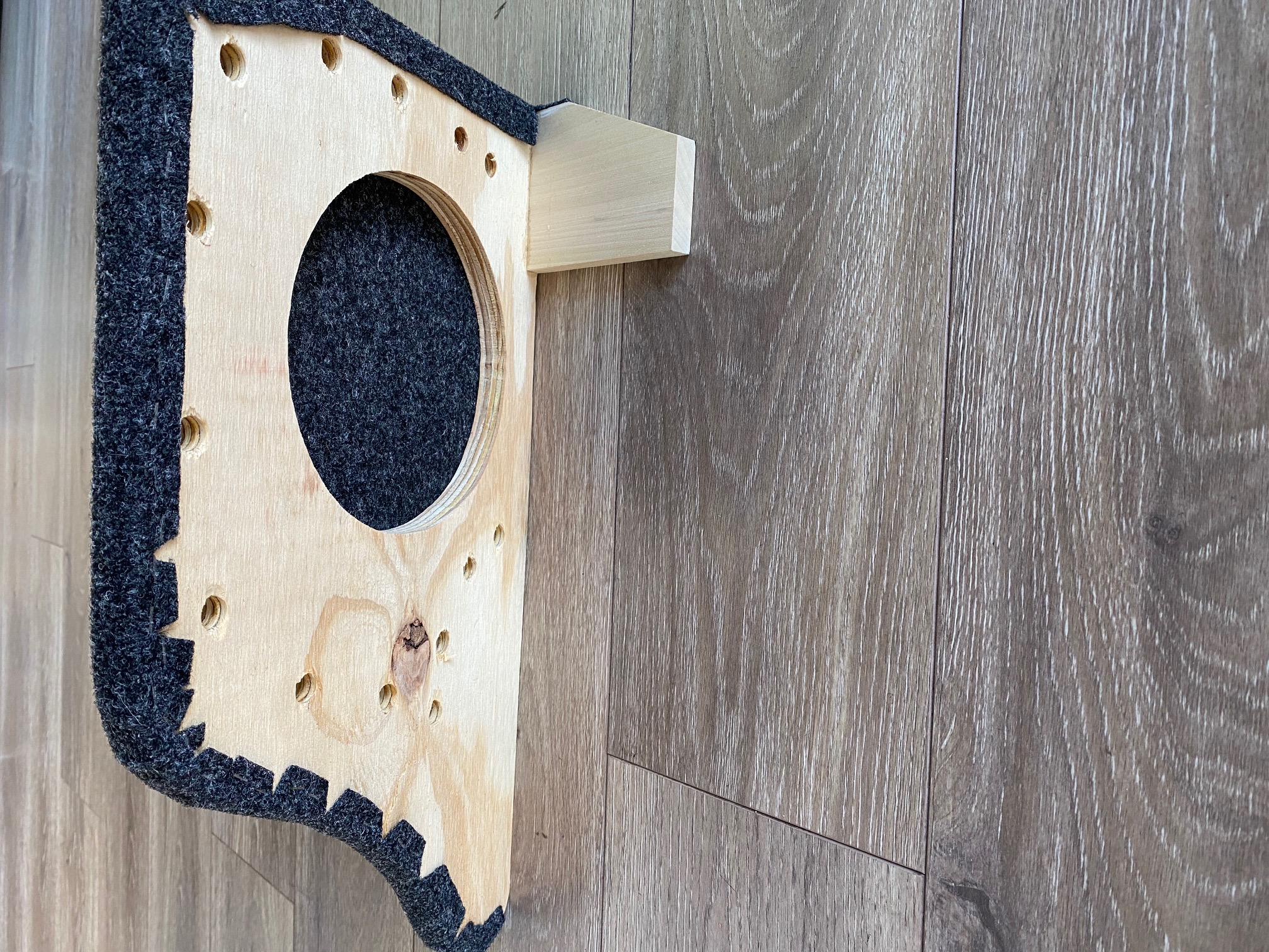

Easy to make, fits perfectly, totally replaces the factory foam block, holds an 8 inch sub, factory carpet fits right over it so it becomes a subtile sub, and no need to cut up a perfect center console (plus when it is in the console you still do not have a chamber for the bass like you do when it is in place of the factory foam blockClick to view attachment Click to view attachment

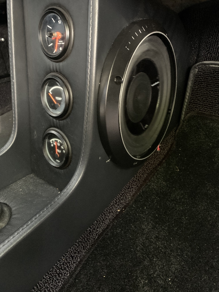

Here is mine. I can say better that nothing but you really need to enclose the console to make the most.
