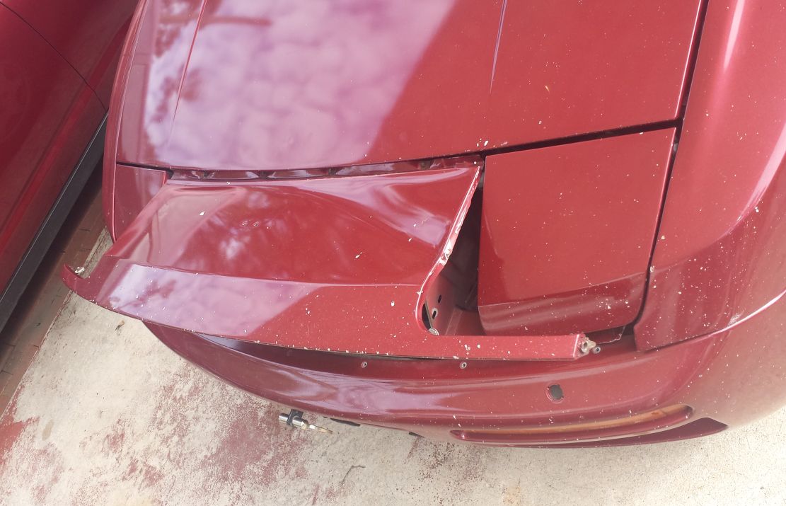

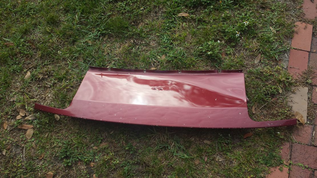

the Nose Panel on my 944S2 came loose and Folded up at 140mph. Now I have new piece of Garage Art
I was going to modify it, now will just buy another

Looks like the end fastening were missing,pretty sure they mount via tabs on to the very front of the fenders.
rhodyguy
Maybe only rated for 130. Is that a washer laying near the end?

A strip of racer tape (or something clear) to keep air from entering the leading edge?
jmitro
if properly attached, it's impossible for the header panel to fold backwards like that at speed. early 944s were welded in place; later 944s like the S2 were bolted in place.

the panel is held on by four bolts with washers that go into slot on the body. There are supposed to be a 10mm bolt on each end that were not there and then there are 4 screws at the top by the hood.
The fact that the 2 10 mm bolts were missing is the reason it came loose IMHO

Some hardware either failed or wasn't there.
