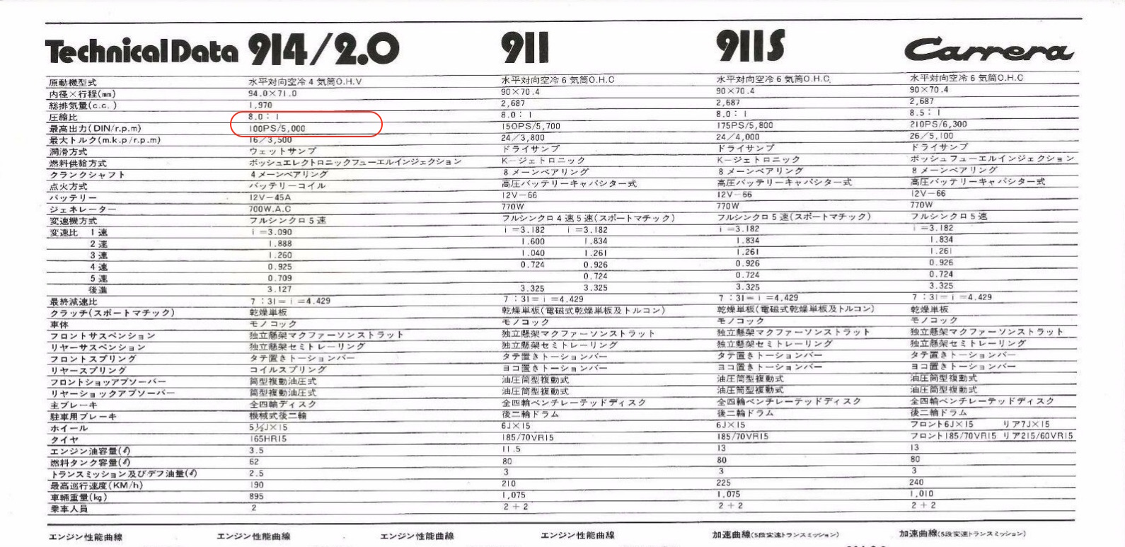

but japan
definitely the high compression engine.

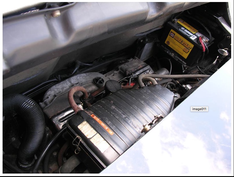

see images below. matsuda 914 engine bay has the can in it like all usa 74s.
which meant it had to have a drilled out fan casting with the inset sleeved tube to take the blower bleed hose to the charcoal cannister. euro cars did not have that.
and given the engines were built in hanover that meant it had to be built that particular way and identified so the correct engine was delivered at osnabruk and put in the right car on the assembly line.

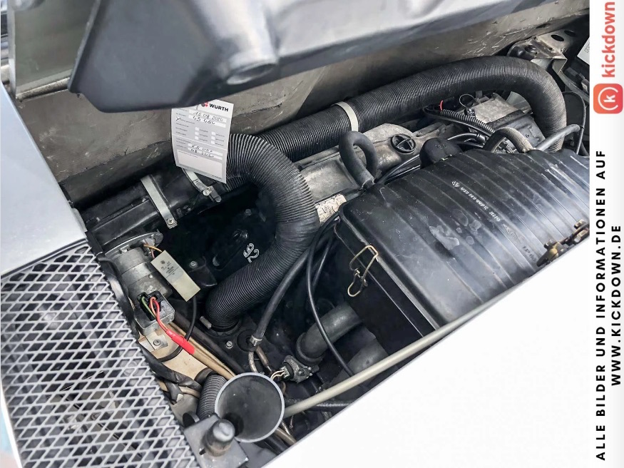

i got tantilisingly close to the number on the 75 euro 2.0 with a car for sale in germany. there have been a number of excellent condition 2.0s for sale in germany recently,
we know the USA 75 2.0s take 924 and 925.
and whatever the euro one is its either taking up 922 or 923 or a number sequence after 925. might stumble on the number one day.

i haven't found a 73 J market car with sufficient documentation in original condition to verify the EVAP system inclusion. however its clear from @dr914 's limited documentation that the matsuda 74 LE does have it.
