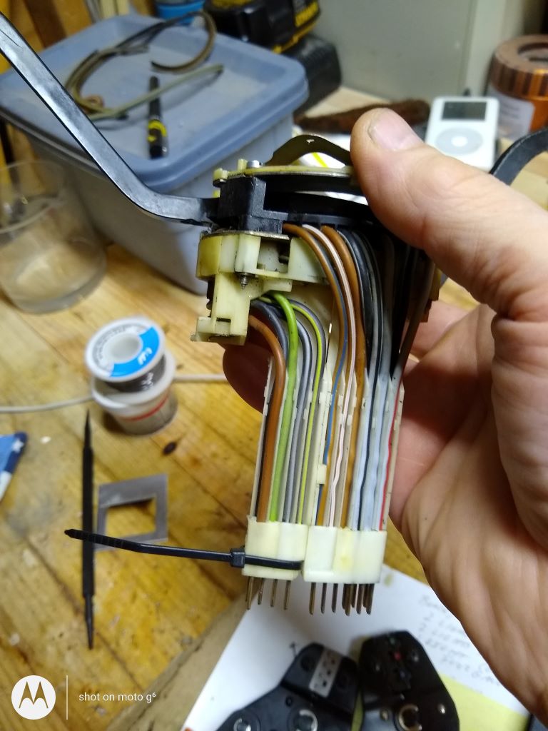

On my wiper switch there are 5 wires. Black, Brown, Green, Black/White, Black/Green
The black wire (behind the brown) mates to a brown/black wire on the main harness which isn't used. It was capped off and taped into the body of the harness right at the wiper motor. My wiring harness is a 1973.
Testing for continuity between the black and the ground I get tone when I pull the wiper switch forward. I also get continuity on the black/white wire which connects to a red/black wire to the wiper motor.
Can I use the black/brown to power an electric washer pump?
Thanks.
George

What you are describing is the circuit for the intermittent wiper. IF you break the tab off on stalk, the all the way down position is a hot circuit. You would have to move switch back up to neutral to turn off washer pump. You need a 6 wire switch if you want washer and intermittent wipers.
