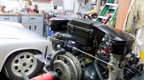

After about 1,700 miles of driving my freshly restored car with rebuilt engine, I’ve decided I’ve had my fun with Weber carbs and distributor-based ignition and am ready to step up to modern EFI and coil on plug ignition. Even with the jetting that came out of the box leaving the carbs running rich, the performance has been fantastic. What is not fantastic is the garage stinking of gasoline, no compensation for altitude, and being generally too fiddly to set up for my taste. My trials with the ignition are documented in another thread. Yes, I know a 1-2-3 would solve those problems but for the money, I’d rather invest in modern COP ignition as part of an EFI upgrade.
My goal is a smooth, efficient, and reliable street machine that I can drive from sea level to 11,000 ft. without starving or choking on fuel. Efficiency is at least as important as performance. As long as I can get at least the stockish 100 hp, I’ll be happy and beyond that, I’d like to wring as many mpg out as possible.
The engine is a mostly stock euro-spec 2L engine. The only mod is a fairly mild Elgin 6048 camshaft with 256 duration for the carbs. A source of pride of this build is this custom 911/914-6 inspired air cleaner I made which I think looks cool and really silences the carbs.
Now for the questions:
• Single throttle body or ITB? I think I’ve made a decision but still interested in thoughts. I was thinking about welding injector bungs onto the carb manifolds and using my carbs as throttle bodies. The main appeal is that I would keep my cool air cleaner to make the other kids jealous. However, it seems the stock throttle body would greatly simplify the conversion. Also, even though the custom intake is designed to allow access for servicing and easy air filter replacement, it does crowd an already crowded engine bay and makes working in there just that much more of a challenge. My stock TB needs some TLC and might have to be sent for professional refurbishing. I think I could sell my carb setup to cover that cost but not sure. The upshot is that I’ve all but decided to go back to the stock TB, but curious what others think.
• N Alpha, Speed Density, or MAF? I’ve been reading up on this and think I understand pros and cons, but still a little confused about sensors needed. With my efficiency goal, I think MAF is the way to go. It looks to me that cutting off the tube connecting the stock air cleaner to the TB and replacing it with a MAF could be a really slick way to add MAF in stealth fashion. Has anyone done this? If not, how does one find the right MAF to use? Other than dimensions, what else needs to be considered?
Another question is about MAP + MAF vs MAF only. I’m a little confused about advantages or when a MAP sensor is needed if you have a MAF.
• Barometric correction – this is an important feature for my location, but the hardware needed to implement it is a little confusing. It seems like if you are running a MAP, then barometric correction is obtained by adding a second pressure sensor (another MAP?) to read reference atmospheric pressure to make corrections to the fuel mixture. How does it work with MAF? Do you only need one pressure sensor to read atmosphere? Or do you still need to reference it against manifold pressure? I assume a lot of this is done in the software but I haven’t looked to far into the tuning part yet. I’m more trying to figure out a shopping list for parts at this point.
• Anyone running a CAM sync and sequential spark and injection? Again with the efficiency goal, this is appealing. Looks like Mario is working on a new version which isn’t available yet, are there alternatives available? It seems people say you still need a crank position sensor even with a cam sensor in the mix. It isn’t entirely clear why though. Lastly, and this is mostly just curiosity, but is it correct to think that the lifespan (in miles) of spark plugs are cut in half with wasted spark?

Throttle Body? Given you already have the cool airbox setup and the manifolds and linkage, and not knowing how your cam will react with a shared plenum intake, I would just pick up a set of ITBs.
Fueling Algorithm? This is going to depend on if you decide to go with a single throttle body or ITBs as well as well as what sort of vacuum your cam produces. Also the MSExtra firmware (that you will want to run) has additional fueling algorithms that I would recommend over the above mentioned. Single throttle body you are most likely going to want to use "% Baro" which is basically speed density scaled to your current altitude. ITBs if your vacuum signature allows I would recommend "% baro" but with ITBs it usually wont, in which case I would run "hybrid Alpha-n" which is somewhat more difficult to initially tune but gives you the best of both worlds.
Barometric correction is always applied however i believe what you are looking for is "Real time Barometric correction" which requires a 2nd MAP sensor if you are using the 1st MAP sensor for your fueling. With a single MAP sensor the MS takes a barometric reading before you start your engine and uses that for the entire run time so if you have a drastic change in altitude over your drive your fueling will be off. Adding a 2nd sensor allows it to get a constant baro metric reading. This is a really easy thing to add when building your harness.
My thoughts on CAM sync and sequential injection are that it is really overkill for these cars. The impact of it is extremally minimal and only makes a slight difference to emissions at lower RPMs as at higher RPMs the injection time required means you will always be squirting on to a closed valve anyways. It does add a lot more complexity to the build and tune though, which is already going to be a steep learning curve if you have never done this before.
Plug life with wasted spark? That all depends on what you are referring to as wasted spark. An actual wasted spark coil pack where 1/2 of your cylinders get fired with reversed polarity has the potential to more than double the wear on the 2 plugs that get fired in reverse, especially if you run stock plugs. This was one of the reasons for some of the exotic metal plantings they stared putting on the electrodes. You can run coil per plug or a 4 coil pack in 2 channel batch fire which is the same as wasted spark in that you have a wasted spark, however all 4 coils still fire with standard polarity so you dont get that extra plug erosion.

I'm surprised by the discussion on ITBs. I really though the overwhelming advice would be to ditch the fancy air cleaner and use the stock TB. So let's talk about this a little more. My second stop on this journey (after Greg's blog) was looking at the Dub Shop kits. It didn't take long to rule those out. Yes, the ITBs are sweet but are as expensive as a set of carbs and more than I think I could sell my carbs for. Also, I cannot assume they would be compatible with my air cleaner. Yes, the ITBs are the same dimensions as 40IDFs so no issue there, but what about the manifolds? If they are as much as a half inch different and total height than mine, then the geometry of the cleaner intakes will be off and they won't fit correctly. To me, if I went the ITB route, it makes more sense to just use the carbs as throttle bodies. Others have done it. Why would that be a problem. It would eliminate a major expense.
As for the cleaner. To be honest, that was a personal challenge. I'm very proud of that cleaner, but now I've done it and won't cry if I pass it on to someone else to enjoy. Working in the engine bay will be a little easier with the stock TB and cleaner setup. Then again, the point of doing this is to greatly reduce the need to work in the engine bay.
WRT vacuum signal. I guess I should measure what I have. All I can say now is that I'm getting good enough signal from a single barrel to actuate my vacuum advance (port vacuum) and retard (manifold vacuum). My cam is pretty mild. Basically stock lift with a bit longer duration. Enough that it would run rough with D-Jet which is why I'm not just refurbing the D-Jet system. I don't have an appetite to split the case on a freshly rebuilt and running well engine to swap cams.
So the real question WRT ITBs is, what advantage do they bring other than looking cool and letting me keep the cool air cleaner? Honestly, I need more than that. I imagine they provide significant advantages in big displacement engines, but would they do anything meaningful for my little hundred pony power plant?

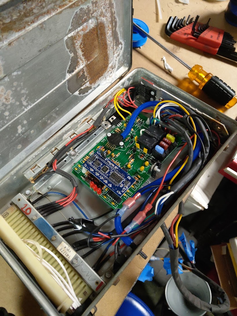

I know a lot of people set up Microsquirt only without adding ignition control. I assume, but am not sure, that it could be done in reverse. I'd like to convert my my ignition to MS controlled COP first, and once that is running, turn to fuel management. Any problem doing it that way?
Also, I've seen some cool installs that hide the MS ECU and Lambda controller inside a stock D-Jet ECU box. Anyone who has done that care to share how it has worked? It doesn't exactly comply with recommendations for mounting either unit but has a lot of appeal to me and I don't see why it wouldn't work.

In case you haven't seen/read my partial adventure, enjoy! smile.gif
http://www.914world.com/bbs2/index.php?sho...42361&st=60
That being said, it stands today exactly where I stopped on the last post because I started to rebuild the whole car. I am looking forward getting back to this as rust repair isn't really appealing to me...
So, although there might be a good portion of the setup in place, nothings has really been tried. dry.gif

My setup started with monitoring only.

ITBs are airflow. You'll flow more air with four 40mm(?) bores than with a single 55mm(?), though one can legit argue only one hole is pulling through the stock TB at a time...and as noted above the shorter run gives you throttle response.
I will also note that I'm not seeing a significant drop in manifold pressure as the car revs to redline, so I'm pretty sure the stock setup is not a big restriction. FAT 2056cc with a FAT fuel injection cam.
I've been mulling the idea of replacing my 40DRLAs on the historics race car with Mario's setup, but $$$ and time have allowed me to procrastinate. Plus I'd have to re-do my fuel system (it's single feed line, not recirc) and I'd have to install a voltage manager (I don't run an alternator). But I think it would make for a better race car.
I would not be surprised if you can use your air cleaner with Mario's system; he's using CB Performance throttle bodies which I'm pretty sure are based on Weber IDF carb bodies. Uses the same manifolds, IIRC.

Thanks for the compliment. IFAIK there is no standard for carb manifolds for the 914 but could be wrong. I've seen tall and short manifolds and it looks to me like total height dimensions could vary by manufacturer. Mine are what was sold in the old Weltmeister kits way back in the 20th century. The issue is that the center air box mounting height needs to be matched so the intakes mate squarely with the carb housings. Changing the airbox or carb heights relative to each other but much more than a quarter inch changes the angle and creates gaps. Now it could be that my manifolds are the same height as many that are commonly sold now - I just don't know.
Here's a video I posted some time ago with more detail on the air cleaner. The comment I make in the vid about fitting under the rain tray was foreshadowing. It did NOT fit and required going back in and chopping down the bracket holding the air box about an inch and reworking the intakes to restore the proper fit.

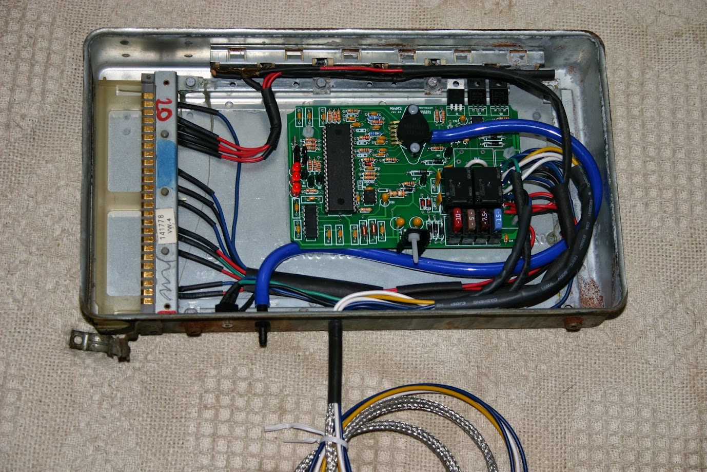

For 15 or so years I ran various Megasquirt builds through a 100% unmolested d-jet wiring harness just to show it could be done. It was a continuous evolution that I kept hacking new features into over the years.
This was the final version I pulled out of the car last year to replace it with a Microsquirt and fully custom harness. There was more I was going to add to it but decided it was time to switch over to something a little more "sane'
You probably wont recognize the board because its not an officially licensed MS board but rather a custom board based on the early 2.2 circuit diagram.
Dont try this at home...
Seriously, after 15 years I can give you all the reasons you dont want to do something like this.
This was how it originally looked before the additional inline hacks to add more functionality.
I wont show you the earlier versions I ran using the official Megasquirt 2.2 board as they were not at all pretty. I was in my 20s, poor, and still had a lot to learn. Think my first running MS conversion cost me somewhere around 100 bucks. Things have changed a lot since then.

@bbrock happy11.gif Love the craziness -- the dream of getting a 914 to be 21st century maintenance free lol-2.gif but what are you doing to do about the maintenance of oil leaks. av-943.gif
@JamesM Impressive - love the idea of getting the controls into the stock D-jet ECU box! Circuit minaturization of the the years is amazing.

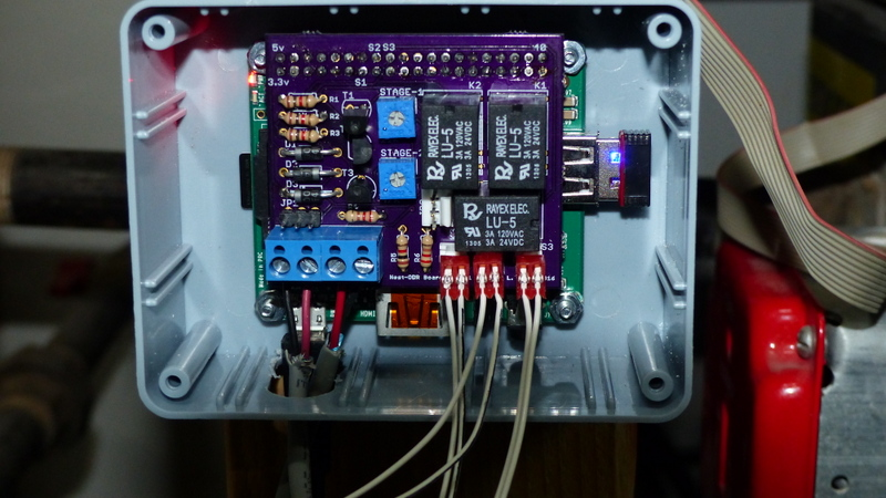

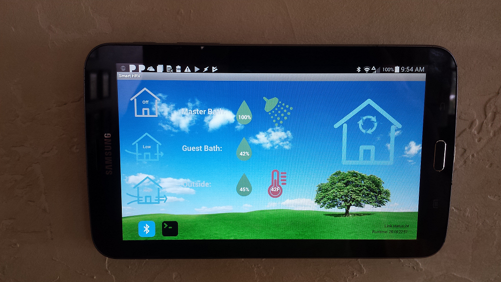

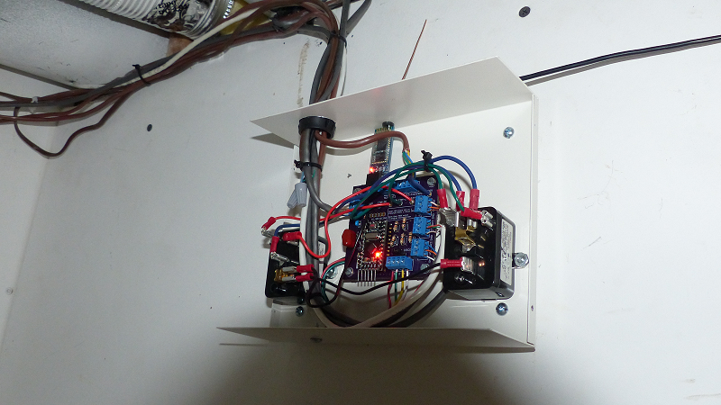

@JamesM I like it! How did mounting the boards inside the stock ecu case work? I have a couple spare D-Jet ECUs and would like to do the same.
I've had a couple crazy electronics projects. When we bought Nest thermostats for the house, I didn't like that they didn't interface with our high efficiency Mod/Con boiler with outdoor temperature reset (ODR). So I built a daughter board for a Raspberry Pi to continuously poll the Nest data and boost the boiler output temp when the system was recovering from an overnight temperature rollback. It does this by introducing resistance in stages to spoof the ODR circuit into thinking it is colder outside than it really is, and then boost output temps to catch up from the nightly rollbacks quicker.
IPB Image
Then I didn't like the stupid way the controller for our heat recovery ventilation system worked so I used a logic sniffer to reverse engineer the logic signals and built an arduino-based controller to automate de-humidification and ventilation using sensor feedback. The control panel is now a wall-hung (not to be confused with well-hung) tablet and custom controller app. Before starting that project, I had never heard of a logic sniffer or Arduino; and had never attempted to write an android app!

JamesM
QUOTE(bbrock @ Sep 14 2021, 10:05 AM) *
A very low tech solution, I just used gel epoxy to attach some nylon studs to the d-jet case.
