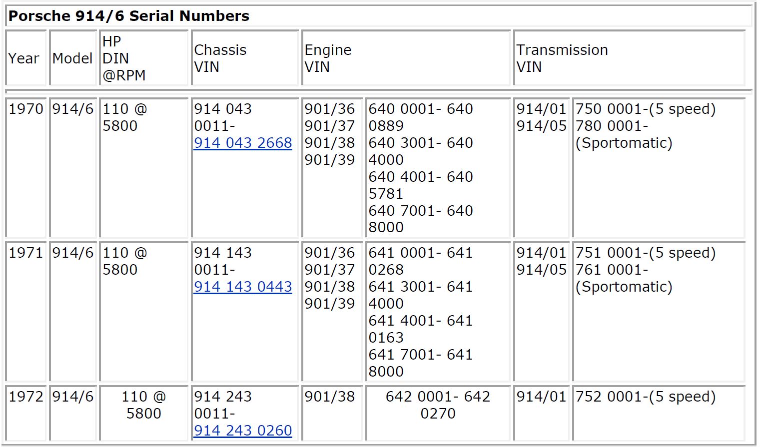

I was under impression that 914-6gearbox was numbered 750xxxx or 751xxxx for 70 and 71, respectively.
Is that correct ??

T...I think you're correct...here is a chart on them...my 70' 6 trans is 914/01 #7501731
