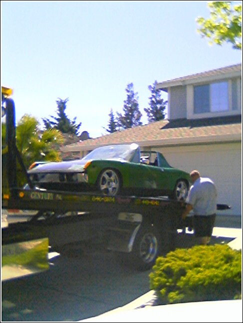

AAA tow #1 a few months ago...........
and AAA tow #2 a few weeks later......
use the a-arms (doh!!!!) to pull the car up.......
